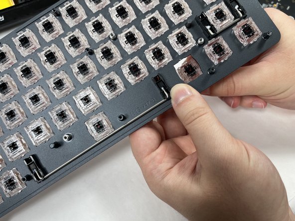

    1. Roccat Vulcan II Mini Air Switch Replacement, Switch: crwdns2935265:04crwdnd2935265:01crwdnd2935265:02crwdne2935265:0 Roccat Vulcan II Mini Air Switch Replacement, Switch: crwdns2935265:04crwdnd2935265:02crwdnd2935265:02crwdne2935265:0
      • Use a switch puller to grip the top and bottom tabs of the switch firmly and pull upward to remove it.
      • Repeat this process for every switch that requires replacement.
