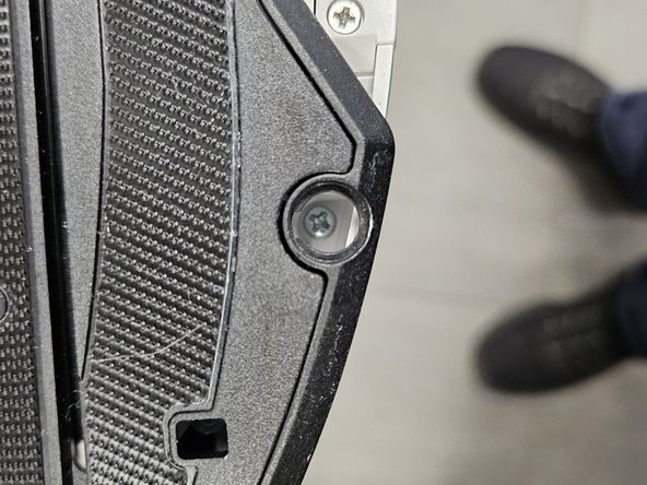

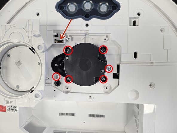

    • Start by removing the visible screws.
    • The bottom 4 are covered by plastic tabs that are glued on. Use your tweezers or box cutter/exacto knife to pry them off.
    • The top left is covered by a warranty sticker.
    • When removing the liDAR cage, be careful of the cable. It is connected on the left side.
    • When removing the LiDAR, be careful of the cable once again. It is connected to the PCB on the bottom of the LiDAR.

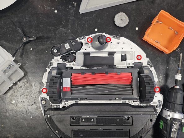

  3. Roborock S8 MaxV Ultra: Teardown, Removing the bottom plate: crwdns2935265:03crwdnd2935265:01crwdnd2935265:01crwdne2935265:0
    • Now flip the robot over and remove visible screws.
    • The top right is covered by a warranty sticker.
    • Now simply pull the bottom plate off. If you got all the screws, nothing else should be holding it in place.

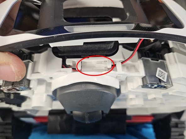

  4. Roborock S8 MaxV Ultra: Teardown, Removing the bumper: crwdns2935265:04crwdnd2935265:01crwdnd2935265:02crwdne2935265:0 Roborock S8 MaxV Ultra: Teardown, Removing the bumper: crwdns2935265:04crwdnd2935265:02crwdnd2935265:02crwdne2935265:0
    • Remove the screws on the bumper.
    • Now remove the cover that held the bumper in place. You will need to move it around a bit around the FlexiArm (Top left in the picture)
    • When moving it around, do not bend it too much. You can permanently deform it.
    • Once you have removed the cover of the bumper, make sure to disconnect the connector that connects the light in the bumper to the motherboard.
    • Detach it before pulling the bumper off, as you could tear the cables.

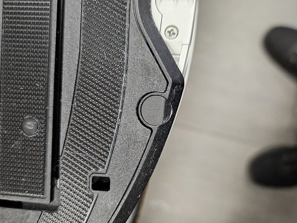

  6. Roborock S8 MaxV Ultra: Teardown, Removing the screws in the VibraRise: crwdns2935265:06crwdnd2935265:01crwdnd2935265:03crwdne2935265:0 Roborock S8 MaxV Ultra: Teardown, Removing the screws in the VibraRise: crwdns2935265:06crwdnd2935265:02crwdnd2935265:03crwdne2935265:0 Roborock S8 MaxV Ultra: Teardown, Removing the screws in the VibraRise: crwdns2935265:06crwdnd2935265:03crwdnd2935265:03crwdne2935265:0

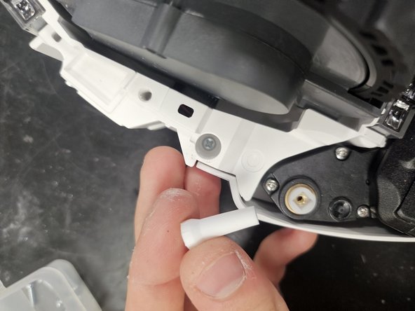

    • Remove the screws.
    • One is covered by a rubber cap.

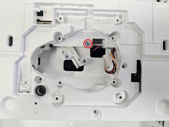

    • Now, flip it over and remove a screw on top.
    • Flip it over again and remove the rest of the screws.
    • One is covered by a pretty long rubber cap.

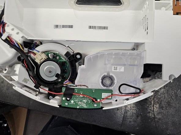

    • You've got it open!
    • The front half houses the motherboard, as well as a myriad of other sensors and elements.
    • The back half houses the suction fan, and water tank. I measured the water tank to be roughly 100ml.

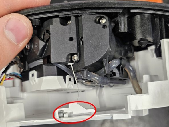

  9. Roborock S8 MaxV Ultra: Teardown, Removing the VibraRise module: crwdns2935265:09crwdnd2935265:01crwdnd2935265:03crwdne2935265:0 Roborock S8 MaxV Ultra: Teardown, Removing the VibraRise module: crwdns2935265:09crwdnd2935265:02crwdnd2935265:03crwdne2935265:0 Roborock S8 MaxV Ultra: Teardown, Removing the VibraRise module: crwdns2935265:09crwdnd2935265:03crwdnd2935265:03crwdne2935265:0
    • First, disconnect the connector from the motherboard.
    • Do be gentle doing this. I've broken the connector on the motherboard before.
    • Get the cable out of the housing and through the hole indicated by the arrow.
    • Flip it over, then get the wire out of the housing. Use your tweezers for this.

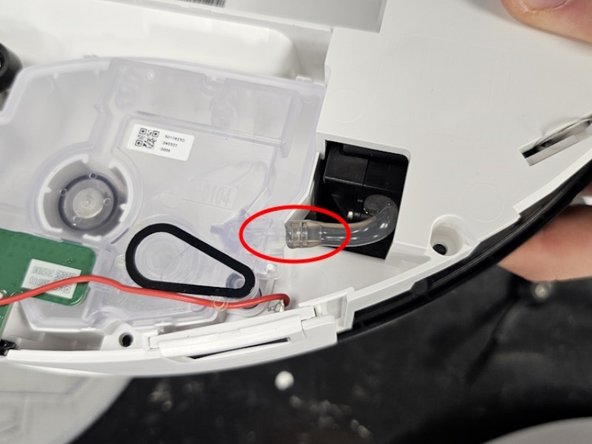

    • Flip it over again, then detach the pipe from the water tank.
    • The VibraRise is still loosely held in place by 2 latches on the left and right sides.
