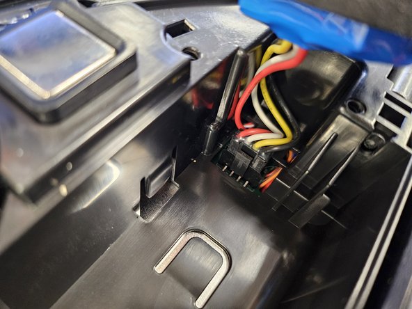

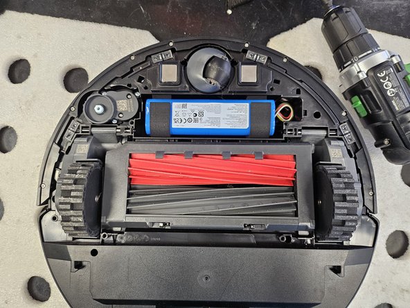

  3. Roborock Q5 Pro: Laser Distance Sensor Replacement, Remove the battery.: crwdns2935265:03crwdnd2935265:01crwdnd2935265:03crwdne2935265:0 Roborock Q5 Pro: Laser Distance Sensor Replacement, Remove the battery.: crwdns2935265:03crwdnd2935265:02crwdnd2935265:03crwdne2935265:0 Roborock Q5 Pro: Laser Distance Sensor Replacement, Remove the battery.: crwdns2935265:03crwdnd2935265:03crwdnd2935265:03crwdne2935265:0
    • Lift it up on the left.
    • Detach the connector by squeezing the release tab, then pull it out.
    • Do not simply yank the battery out. You will tear the connector off the motherboard.

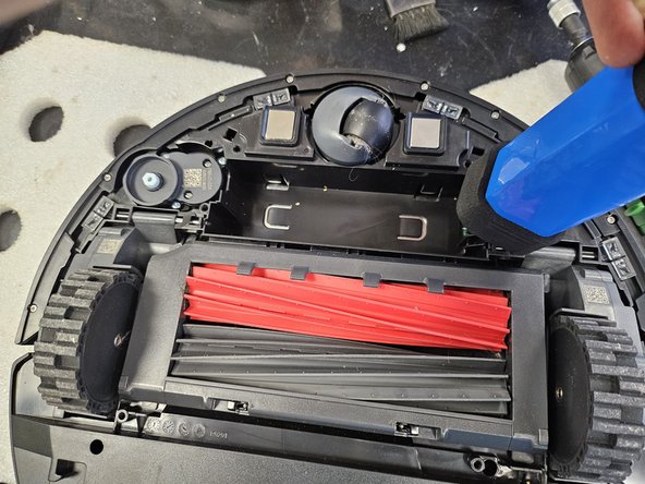

  4. Roborock Q5 Pro: Laser Distance Sensor Replacement, Remove the bumper's lid.: crwdns2935265:04crwdnd2935265:01crwdnd2935265:02crwdne2935265:0 Roborock Q5 Pro: Laser Distance Sensor Replacement, Remove the bumper's lid.: crwdns2935265:04crwdnd2935265:02crwdnd2935265:02crwdne2935265:0
    • Remove the marked screws using a PH1 screwdriver.
    • Then simply lift the lid off.

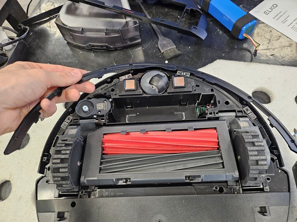

  5. Roborock Q5 Pro: Laser Distance Sensor Replacement, Remove the bumper.: crwdns2935265:05crwdnd2935265:01crwdnd2935265:02crwdne2935265:0 Roborock Q5 Pro: Laser Distance Sensor Replacement, Remove the bumper.: crwdns2935265:05crwdnd2935265:02crwdnd2935265:02crwdne2935265:0
    • Flip the robot over.
    • Tilt the bumper forwards and move it upwards to remove it.

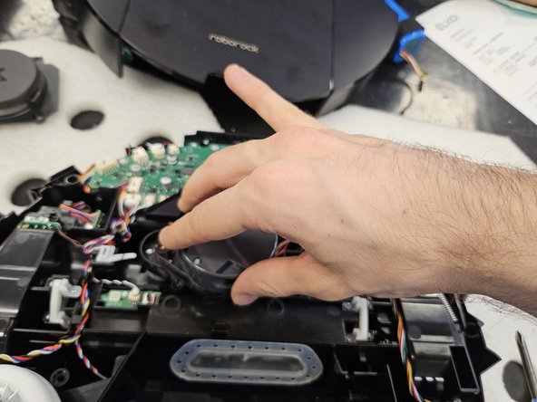

  6. Roborock Q5 Pro: Laser Distance Sensor Replacement, Remove the side brush motor.: crwdns2935265:06crwdnd2935265:01crwdnd2935265:01crwdne2935265:0
    • Flip it back over.
    • Remove the screws using a PH2 screwdriver.
    • Simply lift it out.

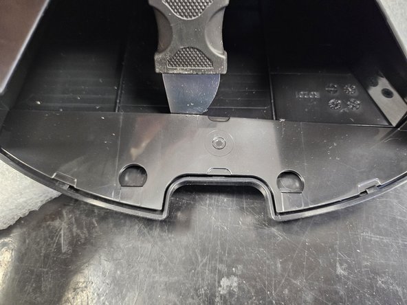

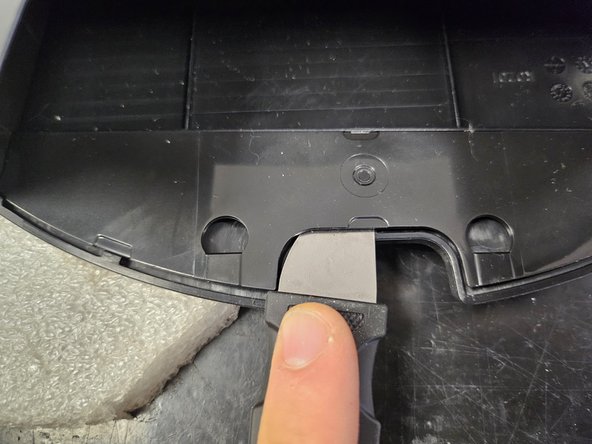

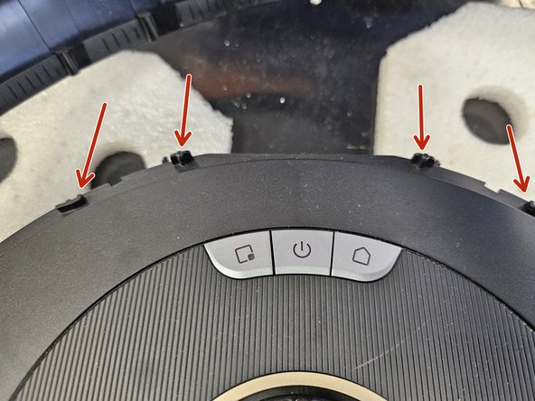

  8. Roborock Q5 Pro: Laser Distance Sensor Replacement, Latches.: crwdns2935265:08crwdnd2935265:01crwdnd2935265:03crwdne2935265:0 Roborock Q5 Pro: Laser Distance Sensor Replacement, Latches.: crwdns2935265:08crwdnd2935265:02crwdnd2935265:03crwdne2935265:0 Roborock Q5 Pro: Laser Distance Sensor Replacement, Latches.: crwdns2935265:08crwdnd2935265:03crwdnd2935265:03crwdne2935265:0
    • The chassis will still be held together by a couple latches on the back.
    • Use a prying tool to get these apart before taking it apart.

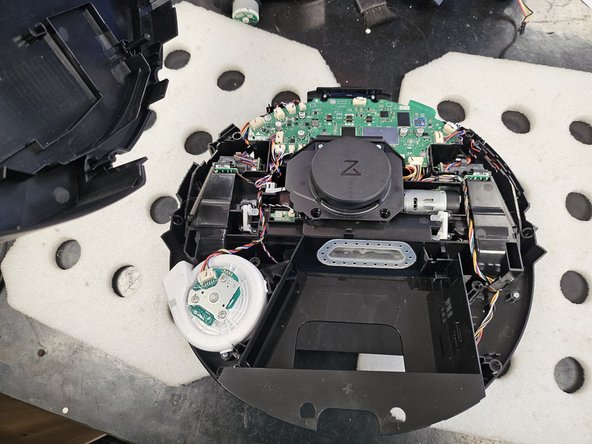

  9. Roborock Q5 Pro: Laser Distance Sensor Replacement, Take it apart!: crwdns2935265:09crwdnd2935265:01crwdnd2935265:02crwdne2935265:0 Roborock Q5 Pro: Laser Distance Sensor Replacement, Take it apart!: crwdns2935265:09crwdnd2935265:02crwdnd2935265:02crwdne2935265:0
    • Flip it over and simply pull the chassis halves apart.

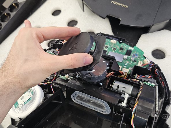

  11. Roborock Q5 Pro: Laser Distance Sensor Replacement, Remove the LDS cage.: crwdns2935265:011crwdnd2935265:01crwdnd2935265:03crwdne2935265:0 Roborock Q5 Pro: Laser Distance Sensor Replacement, Remove the LDS cage.: crwdns2935265:011crwdnd2935265:02crwdnd2935265:03crwdne2935265:0 Roborock Q5 Pro: Laser Distance Sensor Replacement, Remove the LDS cage.: crwdns2935265:011crwdnd2935265:03crwdnd2935265:03crwdne2935265:0
    • Remove the marked screws using a PH2 screwdriver.
    • Then, remove it.

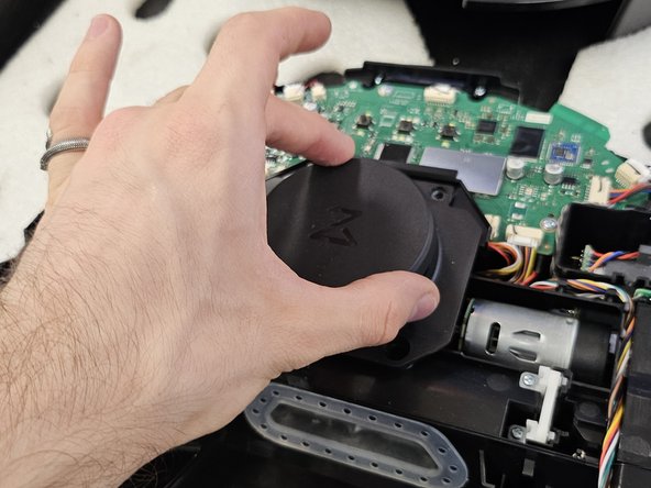

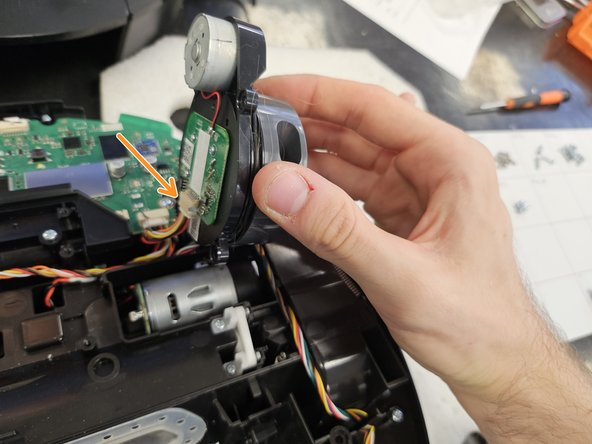

  12. Roborock Q5 Pro: Laser Distance Sensor Replacement, Remove the LDS.: crwdns2935265:012crwdnd2935265:01crwdnd2935265:03crwdne2935265:0 Roborock Q5 Pro: Laser Distance Sensor Replacement, Remove the LDS.: crwdns2935265:012crwdnd2935265:02crwdnd2935265:03crwdne2935265:0 Roborock Q5 Pro: Laser Distance Sensor Replacement, Remove the LDS.: crwdns2935265:012crwdnd2935265:03crwdnd2935265:03crwdne2935265:0
    • Lift the LDS towards the right, then disconnect the connector.
    • If you're replacing the LDS, simply insert the new one and reassemble your device.

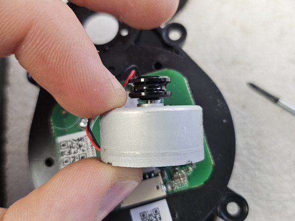

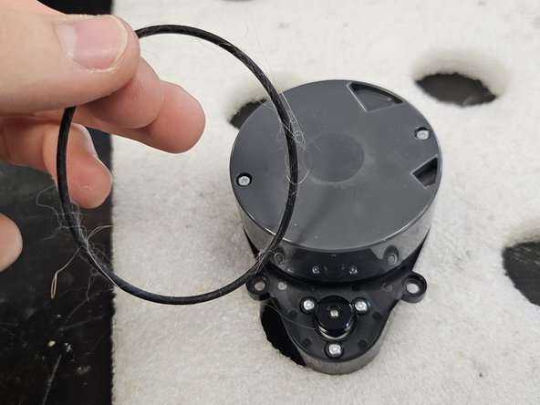

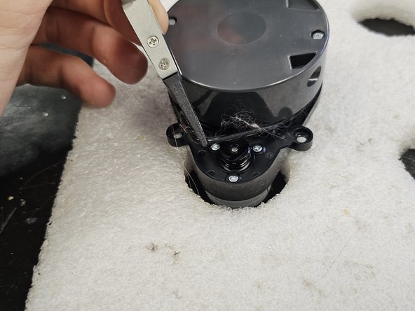

  13. Roborock Q5 Pro: Laser Distance Sensor Replacement, Remove the rubber band.: crwdns2935265:013crwdnd2935265:01crwdnd2935265:03crwdne2935265:0 Roborock Q5 Pro: Laser Distance Sensor Replacement, Remove the rubber band.: crwdns2935265:013crwdnd2935265:02crwdnd2935265:03crwdne2935265:0 Roborock Q5 Pro: Laser Distance Sensor Replacement, Remove the rubber band.: crwdns2935265:013crwdnd2935265:03crwdnd2935265:03crwdne2935265:0
    • Remove the rubber band using some tweezers, forceps or your fingers.
    • Make sure to clean it. This one was quite dirty, which was causing the motor to seize.
    • Your robot may have a different iteration of the LDS, which has a cover over the rubber band section. In that case, please check: Roborock Q Revo: Laser Distance Sensor Replacement and skip to step 12.

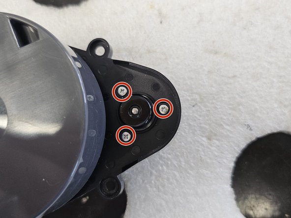

  14. Roborock Q5 Pro: Laser Distance Sensor Replacement, Remove the motor.: crwdns2935265:014crwdnd2935265:01crwdnd2935265:03crwdne2935265:0 Roborock Q5 Pro: Laser Distance Sensor Replacement, Remove the motor.: crwdns2935265:014crwdnd2935265:02crwdnd2935265:03crwdne2935265:0 Roborock Q5 Pro: Laser Distance Sensor Replacement, Remove the motor.: crwdns2935265:014crwdnd2935265:03crwdnd2935265:03crwdne2935265:0
    • Before removing the motor, flip it over and check whether it has a connector or is soldered directly onto the PCBA.
    • Remove the screws.
    • Now you can remove and replace the motor.
