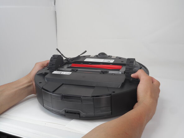

    • Carefully flip the Roborock upside down on a soft surface (e.g., towel) to avoid scratches.
    • Turn off the vacuum using the main switch underneath.

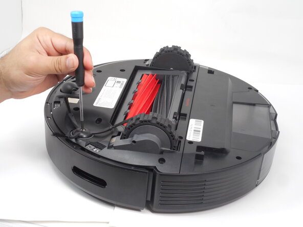

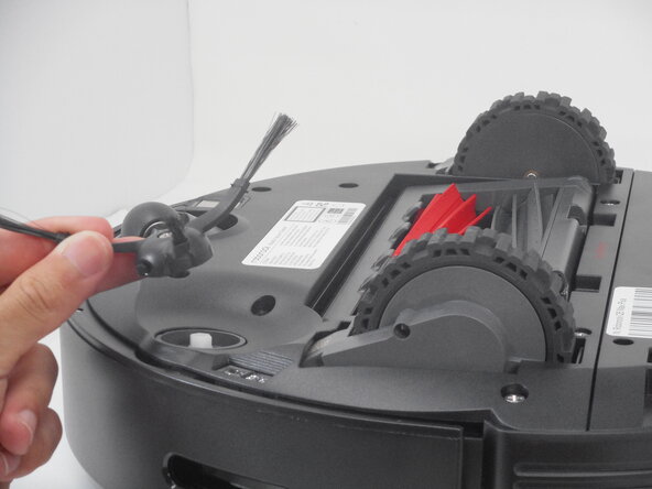

  2. Roborock Q5 Max Plus Battery Replacement: crwdns2935265:02crwdnd2935265:01crwdnd2935265:03crwdne2935265:0 Roborock Q5 Max Plus Battery Replacement: crwdns2935265:02crwdnd2935265:02crwdnd2935265:03crwdne2935265:0 Roborock Q5 Max Plus Battery Replacement: crwdns2935265:02crwdnd2935265:03crwdnd2935265:03crwdne2935265:0
    • Hold down the side brush with one hand to prevent it from moving.
    • Use a Phillips #1 screwdriver to remove the single screw securing the side brush.
    • Remove it from the base.

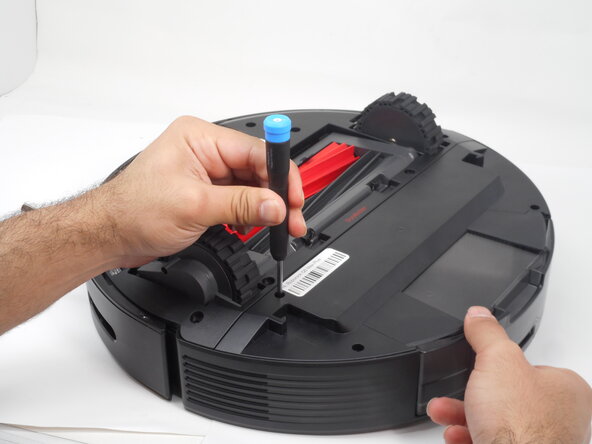

  3. Roborock Q5 Max Plus Battery Replacement, Bottom Panel: crwdns2935265:03crwdnd2935265:01crwdnd2935265:02crwdne2935265:0 Roborock Q5 Max Plus Battery Replacement, Bottom Panel: crwdns2935265:03crwdnd2935265:02crwdnd2935265:02crwdne2935265:0
    • Use a Phillips #1 screwdriver to remove the eight 14 mm screws that secure the bottom shell.
  4. Roborock Q5 Max Plus Battery Replacement: crwdns2935265:04crwdnd2935265:01crwdnd2935265:01crwdne2935265:0
    • Gently lift the the bottom shell up and off.
    • If you encounter resistance, double-check for any hidden screws that may have been overlooked.

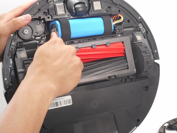

  5. Roborock Q5 Max Plus Battery Replacement, Battery: crwdns2935265:05crwdnd2935265:01crwdnd2935265:03crwdne2935265:0 Roborock Q5 Max Plus Battery Replacement, Battery: crwdns2935265:05crwdnd2935265:02crwdnd2935265:03crwdne2935265:0 Roborock Q5 Max Plus Battery Replacement, Battery: crwdns2935265:05crwdnd2935265:03crwdnd2935265:03crwdne2935265:0

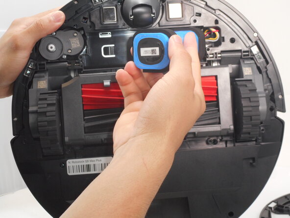

    • Carefully pry out the battery and remove it from its housing.
    • Don't fully remove it as its still connected to the vacuum.

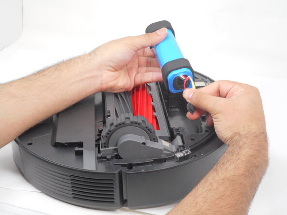

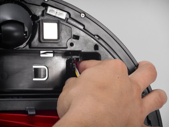

  6. Roborock Q5 Max Plus Battery Replacement: crwdns2935265:06crwdnd2935265:01crwdnd2935265:03crwdne2935265:0 Roborock Q5 Max Plus Battery Replacement: crwdns2935265:06crwdnd2935265:02crwdnd2935265:03crwdne2935265:0 Roborock Q5 Max Plus Battery Replacement: crwdns2935265:06crwdnd2935265:03crwdnd2935265:03crwdne2935265:0
    • Carefully press on the side tab of the connector to release the latch, then pull the connector straight up and out of its port.
