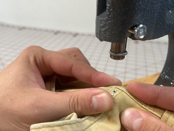

    1. Rivet Replacement on Work Pants, Decide how you will make the repair: crwdns2935265:01crwdnd2935265:01crwdnd2935265:02crwdne2935265:0 Rivet Replacement on Work Pants, Decide how you will make the repair: crwdns2935265:01crwdnd2935265:02crwdnd2935265:02crwdne2935265:0
      • If you have access to a hand press and rivet dies, proceed with Steps 2 - 5.
      • If you don't have access to a hand press and rivet dies, skip to Step 6 to complete this repair with a hammer.

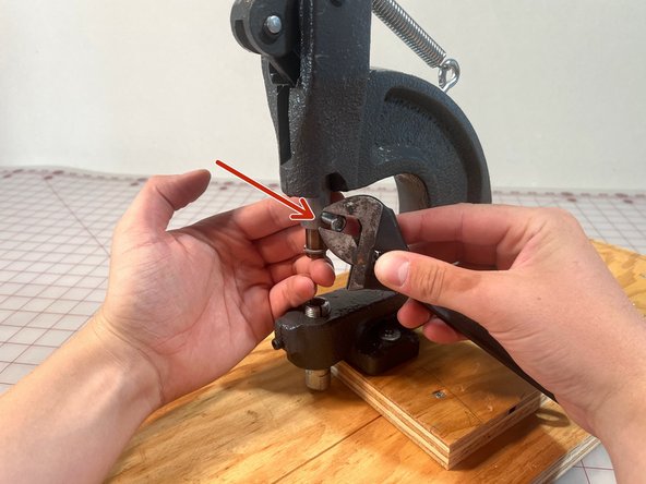

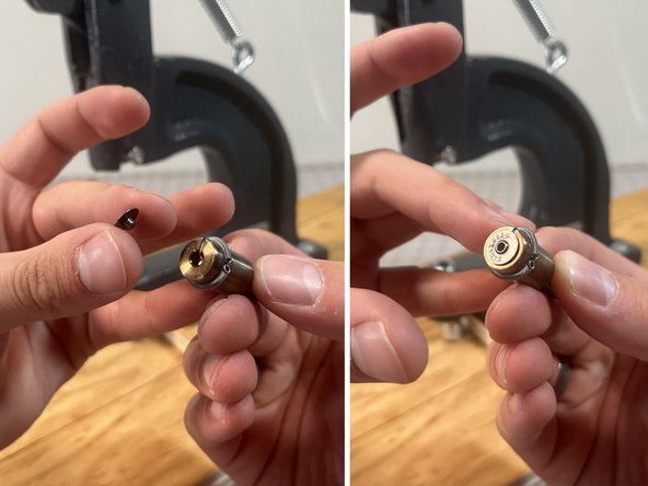

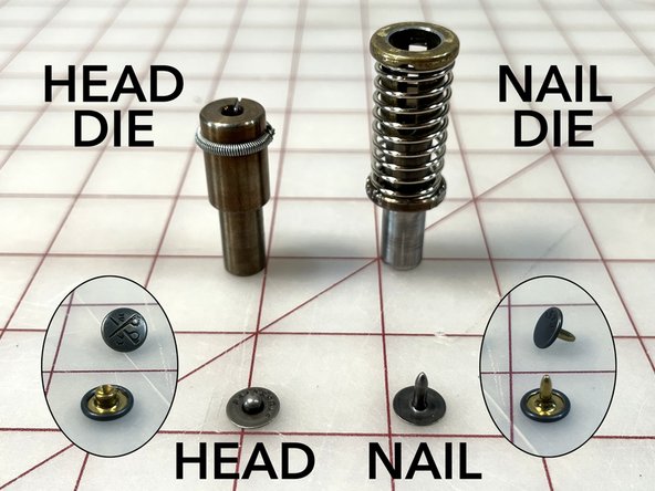

    2. Rivet Replacement on Work Pants, Prepare the dies: crwdns2935265:02crwdnd2935265:01crwdnd2935265:03crwdne2935265:0 Rivet Replacement on Work Pants, Prepare the dies: crwdns2935265:02crwdnd2935265:02crwdnd2935265:03crwdne2935265:0 Rivet Replacement on Work Pants, Prepare the dies: crwdns2935265:02crwdnd2935265:03crwdnd2935265:03crwdne2935265:0
      • Check that the back of the rivet (nail) fits into the nail die. Put the rivet nail aside and place the nail die into the bottom slot of the hand press.
      • Snap the front of the rivet (head) into the head die. The rivet head should stay securely in the die.
      • To insert the head die into the press:
      • Use your fingers, a screwdriver, or a hex key, as needed, to unscrew the tightening mechanism on the side of the press near the top die fitting.
      • Insert the die upward and hold it in place.
      • Tighten the tightening mechanism.

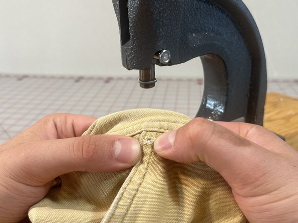

    3. Rivet Replacement on Work Pants, Place the garment onto the press: crwdns2935265:03crwdnd2935265:01crwdnd2935265:03crwdne2935265:0 Rivet Replacement on Work Pants, Place the garment onto the press: crwdns2935265:03crwdnd2935265:02crwdnd2935265:03crwdne2935265:0 Rivet Replacement on Work Pants, Place the garment onto the press: crwdns2935265:03crwdnd2935265:03crwdnd2935265:03crwdne2935265:0
      • Place the rivet nail into the hole left by the previous rivet from the backside.
      • Bring the garment to the hand press and center the rivet nail into the bottom die.
      • Push down the spring of the nail die to keep the rivet nail in place, flush with the garment and visible through the hole.
      • Hold all the pieces in place with your non-dominant hand.

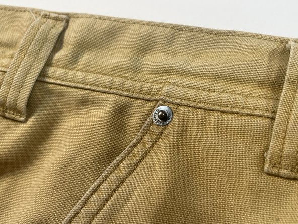

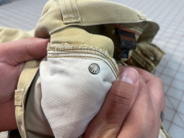

    4. Rivet Replacement on Work Pants, Set the rivet and quality control: crwdns2935265:04crwdnd2935265:01crwdnd2935265:03crwdne2935265:0 Rivet Replacement on Work Pants, Set the rivet and quality control: crwdns2935265:04crwdnd2935265:02crwdnd2935265:03crwdne2935265:0 Rivet Replacement on Work Pants, Set the rivet and quality control: crwdns2935265:04crwdnd2935265:03crwdnd2935265:03crwdne2935265:0
      • Pull down firmly on the press handle to set the rivet.
      • Check that the rivet is firmly set:
      • Pull on each side of the rivet to test that it's secure.
      • The front and back pieces should be parallel to each other, not set at an angle.
      • The rivet shouldn't be able to spin.
      • If the rivet spins, reattach the head to the head die, line up the nail piece with the nail die, and pull again firmly on the hand press.

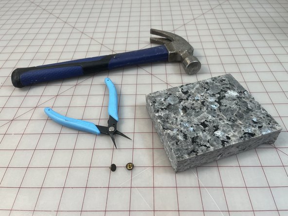

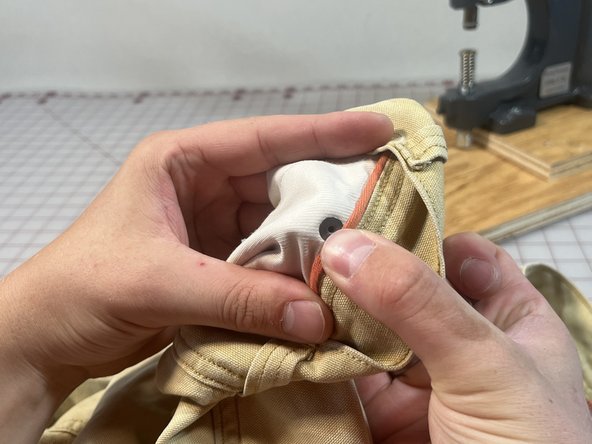

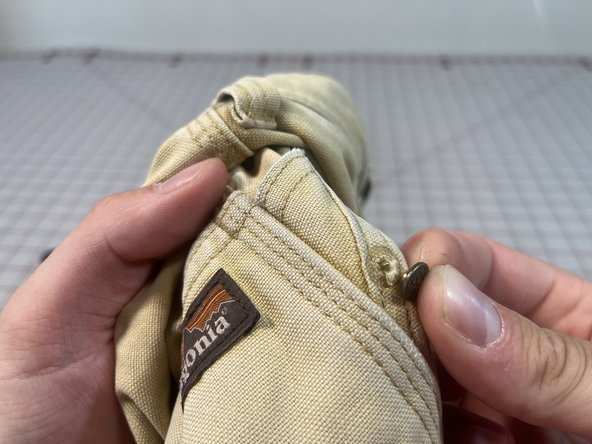

    6. Rivet Replacement on Work Pants, Partially fasten the rivet: crwdns2935265:06crwdnd2935265:01crwdnd2935265:02crwdne2935265:0 Rivet Replacement on Work Pants, Partially fasten the rivet: crwdns2935265:06crwdnd2935265:02crwdnd2935265:02crwdne2935265:0
      • Place the head and nail pieces of the rivet on either side of the hole left by the original rivet.
      • Use your fingers or needle nose pliers to squeeze both sides of the rivet together.
      • This pressure should be enough to partially fasten the rivet and keep the pieces in place without being held.

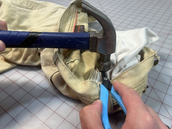

    7. Rivet Replacement on Work Pants, Hammer the rivet: crwdns2935265:07crwdnd2935265:01crwdnd2935265:02crwdne2935265:0 Rivet Replacement on Work Pants, Hammer the rivet: crwdns2935265:07crwdnd2935265:02crwdnd2935265:02crwdne2935265:0
      • Lay the garment on a stone block, piece of scrap wood, or other hard surface, with the rivet head facing down.
      • Use needle nose pliers to hold the rivet nail in place, making sure the head and nail pieces are still aligned.
      • Gently tap the back of the rivet with a hammer until the rivet is fastened enough to stay aligned without the pliers.
      • Remove the pliers, then hold the fabric around the rivet in place and continue to carefully hammer the rivet until it's securely fastened.
