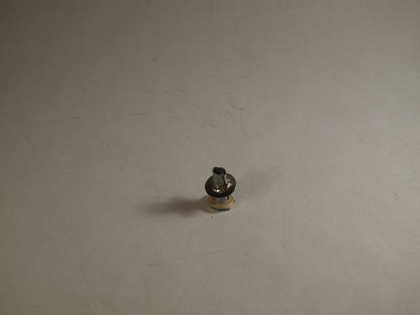

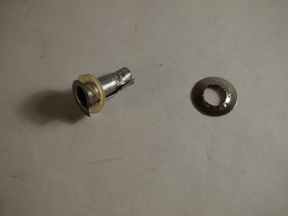

    • Flip the crockpot upside down and locate the metal tubing that protrudes from the center of the base.
  3. Rival Crock Pot 33551 Disassembly: crwdns2935265:03crwdnd2935265:01crwdnd2935265:03crwdne2935265:0 Rival Crock Pot 33551 Disassembly: crwdns2935265:03crwdnd2935265:02crwdnd2935265:03crwdne2935265:0 Rival Crock Pot 33551 Disassembly: crwdns2935265:03crwdnd2935265:03crwdnd2935265:03crwdne2935265:0
    • Gently use a set of pliers to reshape the metal tubing at the center enough so that the tube loosens from the grasp of the grommet.
    • Once you see a gap, hammer the tubing in towards the inside of the crockpot until it is removable by hand.

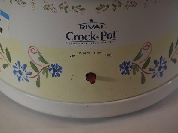

  4. Rival Crock Pot 33551 Disassembly: crwdns2935265:04crwdnd2935265:01crwdnd2935265:01crwdne2935265:0
    • Turn the crockpot right side up again, and pull the plastic knob of the heating adjuster off by hand.
  5. Rival Crock Pot 33551 Disassembly: crwdns2935265:05crwdnd2935265:01crwdnd2935265:02crwdne2935265:0 Rival Crock Pot 33551 Disassembly: crwdns2935265:05crwdnd2935265:02crwdnd2935265:02crwdne2935265:0
    • Use the pliers to clamp and unscrew the flat nut screw holding the potentiometer/heat adjusting knob in place.
  6. Rival Crock Pot 33551 Disassembly: crwdns2935265:06crwdnd2935265:01crwdnd2935265:01crwdne2935265:0
    • Push the potentiometer inward until it pops out of the socket.

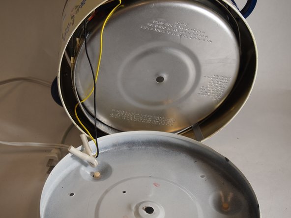

  7. Rival Crock Pot 33551 Disassembly: crwdns2935265:07crwdnd2935265:01crwdnd2935265:02crwdne2935265:0 Rival Crock Pot 33551 Disassembly: crwdns2935265:07crwdnd2935265:02crwdnd2935265:02crwdne2935265:0
    • Turn the crock pot on its side and use your fingers to pry the bottom panel off of the body of the crock pot.
    • This bottom piece has two main wires connected to it, so don't pull too hard.
    • For the best grip to pry, angle the opening of the crockpot away from you and pull towards you. Once completed, leave the bottom loose beneath the crock pot.

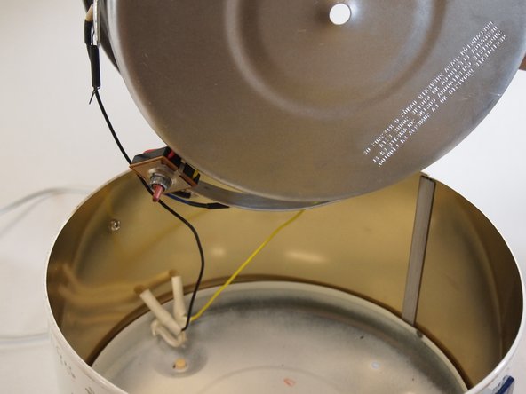

  8. Rival Crock Pot 33551 Disassembly: crwdns2935265:08crwdnd2935265:01crwdnd2935265:02crwdne2935265:0 Rival Crock Pot 33551 Disassembly: crwdns2935265:08crwdnd2935265:02crwdnd2935265:02crwdne2935265:0
    • Pry the inner heating element (grey bowl) from the plastic floral design casing.
  9. Rival Crock Pot 33551 Disassembly: crwdns2935265:09crwdnd2935265:01crwdnd2935265:02crwdne2935265:0 Rival Crock Pot 33551 Disassembly: crwdns2935265:09crwdnd2935265:02crwdnd2935265:02crwdne2935265:0
    • Remove the metal heating ring that is flush against the grey bowl by stretching the tight black spring near the potentiometer.
    • You might need the pliers again!
    • With the help of a friend, you will be able to maneuver and force the ring up and away from the bowl by also gently bending the metal to pry it off.

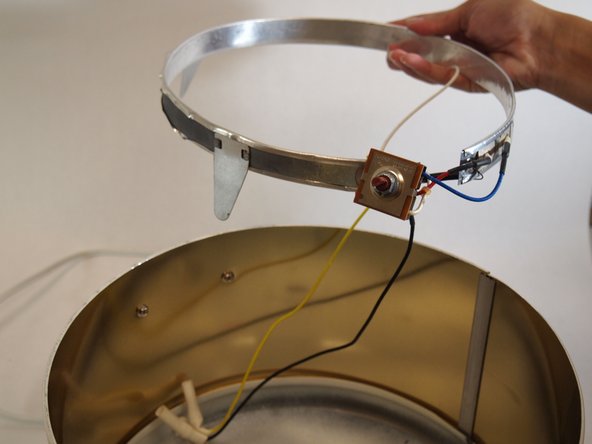

  10. Rival Crock Pot 33551 Disassembly: crwdns2935265:010crwdnd2935265:01crwdnd2935265:01crwdne2935265:0
    • From here, you can send the ring back through the floral casing and work on the electronics attached to the heating ring and the bottom casing as you please! Disassembly complete!
