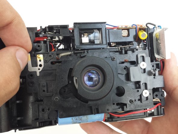

  7. Ricoh YF-20 Super Button Mechanism Replacement, Buttons: crwdns2935265:07crwdnd2935265:01crwdnd2935265:03crwdne2935265:0 Ricoh YF-20 Super Button Mechanism Replacement, Buttons: crwdns2935265:07crwdnd2935265:02crwdnd2935265:03crwdne2935265:0 Ricoh YF-20 Super Button Mechanism Replacement, Buttons: crwdns2935265:07crwdnd2935265:03crwdnd2935265:03crwdne2935265:0
    • Remove and set the front and back covers aside
    • Unscrew the screw that holds the front plate brace in place.
    • Take out the brace.
  8. Ricoh YF-20 Super Button Mechanism Replacement: crwdns2935265:08crwdnd2935265:01crwdnd2935265:03crwdne2935265:0 Ricoh YF-20 Super Button Mechanism Replacement: crwdns2935265:08crwdnd2935265:02crwdnd2935265:03crwdne2935265:0 Ricoh YF-20 Super Button Mechanism Replacement: crwdns2935265:08crwdnd2935265:03crwdnd2935265:03crwdne2935265:0
    • Unscrew the four screws keeping the front face plate in place.
    • The top left screw also holds a metal clip in place.
    • Remove metal clip.
  9. Ricoh YF-20 Super Button Mechanism Replacement: crwdns2935265:09crwdnd2935265:01crwdnd2935265:03crwdne2935265:0 Ricoh YF-20 Super Button Mechanism Replacement: crwdns2935265:09crwdnd2935265:02crwdnd2935265:03crwdne2935265:0 Ricoh YF-20 Super Button Mechanism Replacement: crwdns2935265:09crwdnd2935265:03crwdnd2935265:03crwdne2935265:0
    • After removing the metal clip in the previous step, the front face plate can be removed.
    • The front face plate is attached to the camera body by two small wires. Carefully remove the plate and completely separate it from the camera body.
  10. Ricoh YF-20 Super Button Mechanism Replacement: crwdns2935265:010crwdnd2935265:01crwdnd2935265:03crwdne2935265:0 Ricoh YF-20 Super Button Mechanism Replacement: crwdns2935265:010crwdnd2935265:02crwdnd2935265:03crwdne2935265:0 Ricoh YF-20 Super Button Mechanism Replacement: crwdns2935265:010crwdnd2935265:03crwdnd2935265:03crwdne2935265:0
    • Unscrew the two screws that hold the button mechanism in place.
    • Press down on button mechanism to unlatch it from the camera body. When pressed down, the bottom of the mechanism should push outward.
  11. Ricoh YF-20 Super Button Mechanism Replacement: crwdns2935265:011crwdnd2935265:01crwdnd2935265:03crwdne2935265:0 Ricoh YF-20 Super Button Mechanism Replacement: crwdns2935265:011crwdnd2935265:02crwdnd2935265:03crwdne2935265:0 Ricoh YF-20 Super Button Mechanism Replacement: crwdns2935265:011crwdnd2935265:03crwdnd2935265:03crwdne2935265:0
    • Lift the button mechanism up carefully, removing the spring at the top of the mechanism from where it is attached to the camera body.
    • Take out the button mechanism.
