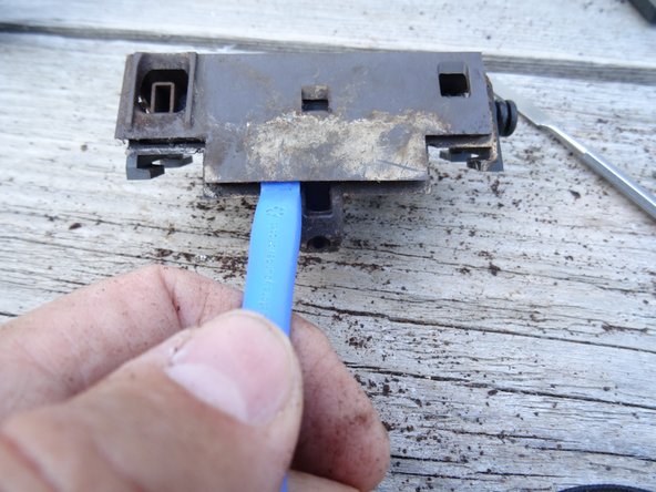

  25. Revise the Jura ENA Micro 9 drainage valve, Drainage valve: crwdns2935265:025crwdnd2935265:01crwdnd2935265:02crwdne2935265:0 Revise the Jura ENA Micro 9 drainage valve, Drainage valve: crwdns2935265:025crwdnd2935265:02crwdnd2935265:02crwdne2935265:0
    • Remove the two T8 Torx screws securing the cover.
    • Use a plastic tool to pry the cover off and set it aside.
  26. Revise the Jura ENA Micro 9 drainage valve: crwdns2935265:026crwdnd2935265:01crwdnd2935265:01crwdne2935265:0
    • Use a spatula to pull out the clip on the docking port. Don't lose the bracket.
  27. Revise the Jura ENA Micro 9 drainage valve: crwdns2935265:027crwdnd2935265:01crwdnd2935265:01crwdne2935265:0
    • Release the water inlet from its catches and turn it up a little.
  28. Revise the Jura ENA Micro 9 drainage valve: crwdns2935265:028crwdnd2935265:01crwdnd2935265:02crwdne2935265:0 Revise the Jura ENA Micro 9 drainage valve: crwdns2935265:028crwdnd2935265:02crwdnd2935265:02crwdne2935265:0
    • Now carefully pry the valve body out of the carrier plate with a plastic tool. While doing this, push the white valve stem in so that it can slide out of its opening.

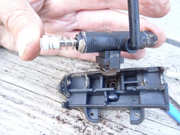

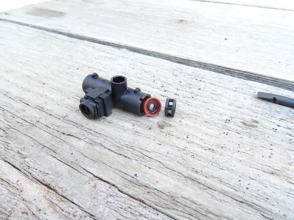

  29. Revise the Jura ENA Micro 9 drainage valve: crwdns2935265:029crwdnd2935265:01crwdnd2935265:01crwdne2935265:0
    • Now you can completely dismantle the valve:
    • First pull the valve stem all the way out.
    • Pull off the water inlet.
    • Remove the docking nozzle from the carrier plate.
    • Pull off the two lids on the valve body.
    • Two seals are visible below. Get them out.
