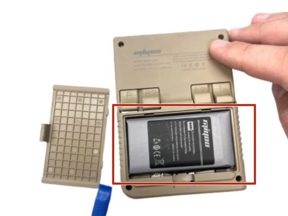

  3. RetroMini Miyoo Mini Plus Screen Replacement: crwdns2935265:03crwdnd2935265:01crwdnd2935265:01crwdne2935265:0
    • Use an opening tool to gently lift the the battery from its compartment.
    • Gently pull the battery out and set the battery next to the system, with care not to strain the attached wire.
  4. RetroMini Miyoo Mini Plus Screen Replacement: crwdns2935265:04crwdnd2935265:01crwdnd2935265:02crwdne2935265:0 RetroMini Miyoo Mini Plus Screen Replacement: crwdns2935265:04crwdnd2935265:02crwdnd2935265:02crwdne2935265:0
    • Pinch the white battery connector and pull it directly out of its socket.
    • Completely remove the battery.
  5. RetroMini Miyoo Mini Plus Screen Replacement: crwdns2935265:05crwdnd2935265:01crwdnd2935265:02crwdne2935265:0 RetroMini Miyoo Mini Plus Screen Replacement: crwdns2935265:05crwdnd2935265:02crwdnd2935265:02crwdne2935265:0
    • When you have the new battery, put the new battery wire into the connecter.
    • Place the battery back into the empty space with the wire at the bottom of the battery.

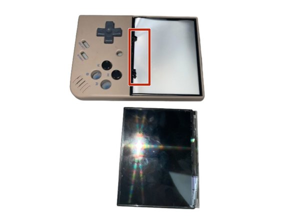

  13. RetroMini Miyoo Mini Plus Screen Replacement: crwdns2935265:013crwdnd2935265:01crwdnd2935265:02crwdne2935265:0 RetroMini Miyoo Mini Plus Screen Replacement: crwdns2935265:013crwdnd2935265:02crwdnd2935265:02crwdne2935265:0
    • Gently apply pressure to the highlighted area on the front cover of the device.
    • While applying the pressure gently peel the screen off of the device.
    • Take care not to flex the screen. If the screen feels stubborn, apply more heat.

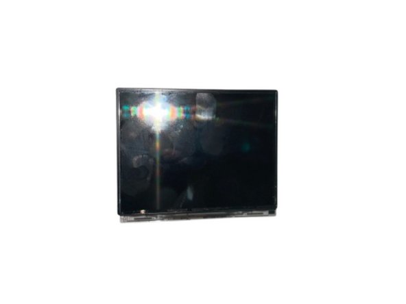

  14. RetroMini Miyoo Mini Plus Screen Replacement: crwdns2935265:014crwdnd2935265:01crwdnd2935265:03crwdne2935265:0 RetroMini Miyoo Mini Plus Screen Replacement: crwdns2935265:014crwdnd2935265:02crwdnd2935265:03crwdne2935265:0 RetroMini Miyoo Mini Plus Screen Replacement: crwdns2935265:014crwdnd2935265:03crwdnd2935265:03crwdne2935265:0
    • Set the new screen gently into the ridges (boxed in red) on the front of the backlit screen
