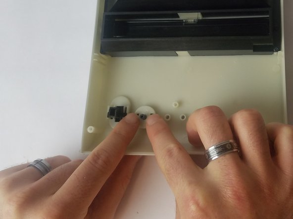

    3. Retro-Bit Retro Duo Reset Button/Power Switch Replacement: crwdns2935265:03crwdnd2935265:01crwdnd2935265:03crwdne2935265:0 Retro-Bit Retro Duo Reset Button/Power Switch Replacement: crwdns2935265:03crwdnd2935265:02crwdnd2935265:03crwdne2935265:0 Retro-Bit Retro Duo Reset Button/Power Switch Replacement: crwdns2935265:03crwdnd2935265:03crwdnd2935265:03crwdne2935265:0
      • Using your fingers (or precision tweezers), carefully pinch the button tabs and push through to the other side.
      • Make sure you pinch both tabs simultaneously, or the button will not pop out.
