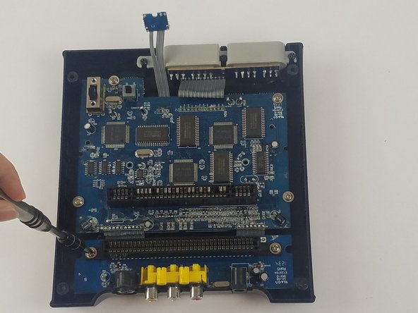

      • Remove the 11 screws holding the circuit boards and ports in place.
      • Six 11 mm Phillips #2 holding the circuit boards.
      • Three 12 mm Phillips #2 screws holding the controller ports.
      • Two 7 mm Philllips #2 screws holding the back ports
    4. Retro-Bit Retro Duo Circuit Board Replacement: crwdns2935265:04crwdnd2935265:01crwdnd2935265:03crwdne2935265:0 Retro-Bit Retro Duo Circuit Board Replacement: crwdns2935265:04crwdnd2935265:02crwdnd2935265:03crwdne2935265:0 Retro-Bit Retro Duo Circuit Board Replacement: crwdns2935265:04crwdnd2935265:03crwdnd2935265:03crwdne2935265:0
      • Carefully lift the circuit board while holding either the AV or controller ports. Alternatively, you can hold the circuit board on its edges.
      • Make sure to lift the circuit board completely out of the bottom case.
      • To avoid damage, do not to touch the top or bottom faces of the circuit board.
