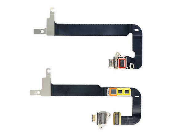

    • And at the other end of the MacBook, it seems the USB-C hardware has also changed. The cable is now perma-fixed to the USB board, condensing the two components into a single unit.
    • ...Also, the silicon is new and moved from the cable itself to the USB board. Here's a comparison of the new USB-C hardware (top) with that of the 2015 Retina MacBook (bottom).
    • Parade Technologies PS8741A (likely an iteration of the PS8740 USB-C redriving switch)
    • Diodes Incorporated PI1EQX7502 USB 3.0 redriver (likely)
    • NXP Semiconductor CBTL04043A1 4-Ch. bidirectional crossbar switch
    • This new USB and cable arrangement is one thing that's not compatible with previous Retina MacBooks.

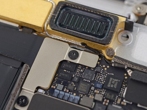

    • But wait, there's even more chips on the back:
    • Toshiba TH58TFT0DFKLAVF 128 GB MLC NAND flash memory
    • Samsung K3QF4F40BM-AGCF 4 GB LPDDR3 SDRAM (x2, for a total of 8 GB)
    • Apple 338S00066 power management IC
    • Texas Instruments/Stellaris LM4FS1EH SMC controller (replacement codename for TM4EA231)
    • Microchip (formerly SMSC) EMC1704-2 temperature sensor
    • Texas Instruments SN650839 step down DC-DC converter (likely), TPS51980A PMIC, and CD3215B01 USB-C controller
    • Intersil ISL95828 Intel CPU PWM controller
  10. Retina MacBook 2016 Teardown: crwdns2935265:010crwdnd2935265:01crwdnd2935265:02crwdne2935265:0 Retina MacBook 2016 Teardown: crwdns2935265:010crwdnd2935265:02crwdnd2935265:02crwdne2935265:0
