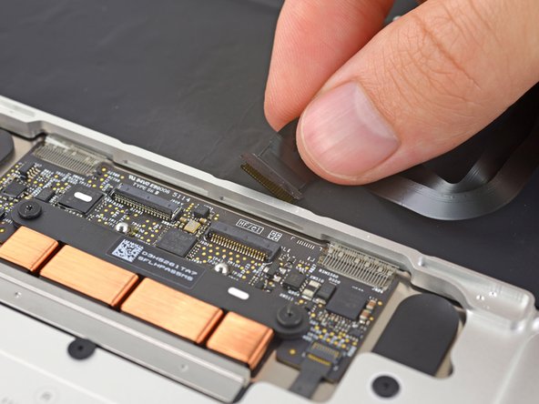

  10. Retina MacBook 2015 Trackpad Assembly Replacement: crwdns2935265:010crwdnd2935265:01crwdnd2935265:02crwdne2935265:0 Retina MacBook 2015 Trackpad Assembly Replacement: crwdns2935265:010crwdnd2935265:02crwdnd2935265:02crwdne2935265:0
    • Disconnect the trackpad ribbon cable from the trackpad by pulling it gently through its slot in the frame.
    it would be nice to have a specific picture of the cable and contacts and how it is oriented in the ZIF connector. This isn't clear in any of these photos or text.
    My trackpad cable snapped so had to replace it and none of the replacement cables have the tape which is on the smaller end to the trackpad. The other end is fairly easy to figure out but the trackpad end isn't as the cable makes a 180 degree turn inside the case (poor design).
    Marc - crwdns2934203:0crwdne2934203:0

  18. Retina MacBook 2015 Trackpad Assembly Replacement, Trackpad Assembly: crwdns2935265:018crwdnd2935265:01crwdnd2935265:02crwdne2935265:0 Retina MacBook 2015 Trackpad Assembly Replacement, Trackpad Assembly: crwdns2935265:018crwdnd2935265:02crwdnd2935265:02crwdne2935265:0
    • Use a pair of tweezers to remove the tape covering the keyboard ribbon cable connector on the trackpad.
  19. Retina MacBook 2015 Trackpad Assembly Replacement: crwdns2935265:019crwdnd2935265:01crwdnd2935265:02crwdne2935265:0 Retina MacBook 2015 Trackpad Assembly Replacement: crwdns2935265:019crwdnd2935265:02crwdnd2935265:02crwdne2935265:0
    • Using a spudger, flip open the retaining flap on the keyboard ribbon cable ZIF connector.
  20. Retina MacBook 2015 Trackpad Assembly Replacement: crwdns2935265:020crwdnd2935265:01crwdnd2935265:02crwdne2935265:0 Retina MacBook 2015 Trackpad Assembly Replacement: crwdns2935265:020crwdnd2935265:02crwdnd2935265:02crwdne2935265:0
    • Gently pull the keyboard ribbon cable out of its slot in the frame.
