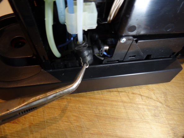

    • The bottom is secured by oval head screws.
    • These screws have an oval head that makes them look like rivets (picture 2). You need to use a special bit - also available at iFixit - for their removal. Here a DIY guide. If the right bit is not available, it could be done with a pair of needle nose pliers. Nespresso wants to keep us out of our own machines!!!
    • Remove five oval head screws securing the large bottom panel.

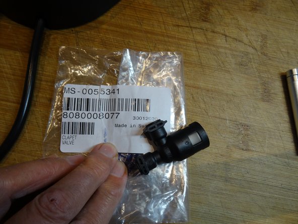

    • In the first picture, the pressure relief valve is marked in yellow. It is located at the bottom of the machine. It is connected directly to the heater.
    • The spare part is ready for installation.

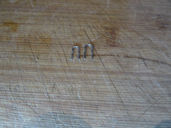

    • Pull out the two metal clips on the connections.
    • The clips are different sizes. The larger one is for the heater connection.
