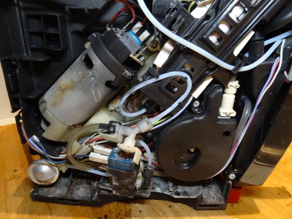

    • Push the side panel back about 1.5 cm.
    • Lift off the panel.
    • The following compononents are exposed:
    • Heater
    • Expansion chamber
    • Gear drive
    • Steam valve
  4. Replace lower solenoid valve on Ecam 350.55, Ecam 350.55 lower solenoid valve: crwdns2935265:04crwdnd2935265:01crwdnd2935265:02crwdne2935265:0 Replace lower solenoid valve on Ecam 350.55, Ecam 350.55 lower solenoid valve: crwdns2935265:04crwdnd2935265:02crwdnd2935265:02crwdne2935265:0
    • The lower solenoid valve is located on the lower left side of the device.
    • Pull out the clip between the solenoid valve and the pressure relief valve.
    • Lift the pressure relief valve upwards.
    • There is a seal between them. It will probably get stuck in the pressure relief valve. Remove it and replace it with a new one.

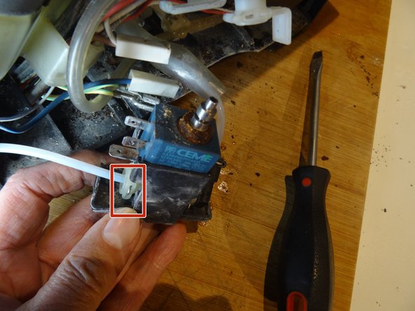

    • Pull the valve together with the rubber sleeve away from the machine toward you.
    • Note how the cables are connected and remove all the blade terminals.
    • Remove the clamps and take out the hoses.
    • There is a seal ring between them. It will probably remain stuck in the solenoid valve. Remove it and replace it with a new one.

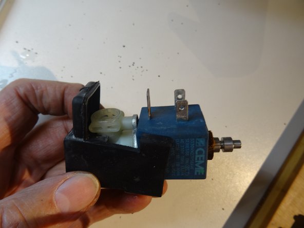

    • Remove the valve from the rubber housing.
    • There is a black angle fitting on the right side of the valve. Pull out the clip and remove the angle fitting. The clip is slightly larger then the others. There is also a seal between them, which you should replace later
    • You can try to open the valve, clean it, and make it work. If the valve coil has a resistance of about 2 kOhm, it may work again. But you will probably have to replace it.
    • When installing a new valve, pay attention to the direction of flow; the flow points toward the black mark or is indicated by an arrow. If you install it incorrectly, the machine will not work.
