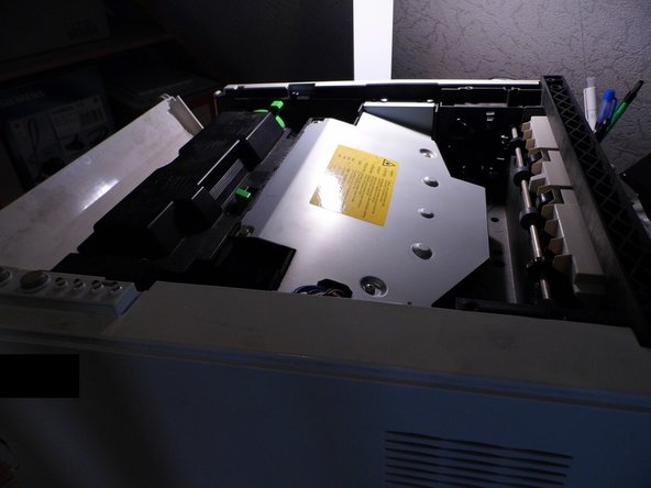

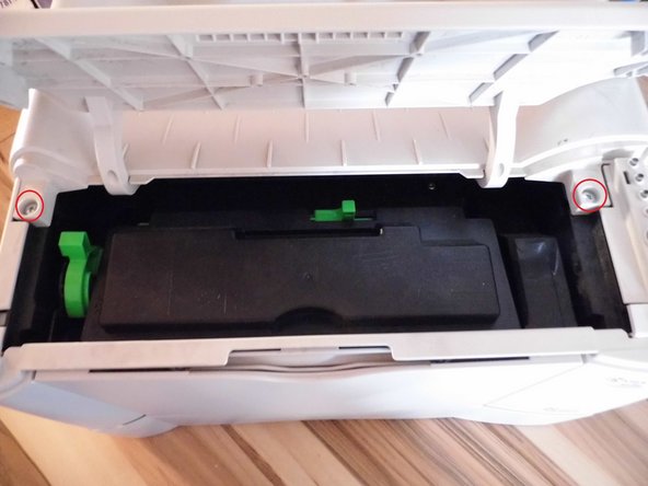

  3. Replace Kyocera FS-1010 sponge rubber, Remove top cover: crwdns2935265:03crwdnd2935265:01crwdnd2935265:02crwdne2935265:0 Replace Kyocera FS-1010 sponge rubber, Remove top cover: crwdns2935265:03crwdnd2935265:02crwdnd2935265:02crwdne2935265:0
    • Open the cover to change the toner
    • Remove the two Phillips screws that connect the top cover to the chassis.
    • Since the cover is in the way, you can put the screwdriver only diagonally on the screws. Be careful not to damage them.

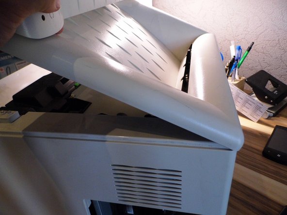

  4. Replace Kyocera FS-1010 sponge rubber, Remove top cover: crwdns2935265:04crwdnd2935265:01crwdnd2935265:03crwdne2935265:0 Replace Kyocera FS-1010 sponge rubber, Remove top cover: crwdns2935265:04crwdnd2935265:02crwdnd2935265:03crwdne2935265:0 Replace Kyocera FS-1010 sponge rubber, Remove top cover: crwdns2935265:04crwdnd2935265:03crwdnd2935265:03crwdne2935265:0
    • Remove the top cover from the printer.
    • Lift the cover on the front to easily and easily remove it.

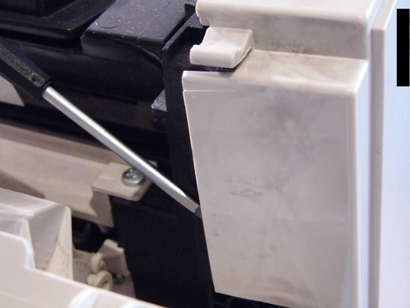

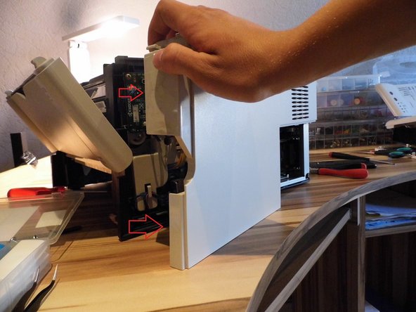

  5. Replace Kyocera FS-1010 sponge rubber, Remove the side cover: crwdns2935265:05crwdnd2935265:01crwdnd2935265:03crwdne2935265:0 Replace Kyocera FS-1010 sponge rubber, Remove the side cover: crwdns2935265:05crwdnd2935265:02crwdnd2935265:03crwdne2935265:0 Replace Kyocera FS-1010 sponge rubber, Remove the side cover: crwdns2935265:05crwdnd2935265:03crwdnd2935265:03crwdne2935265:0
    • To remove the side cover, the front paper feed must be opened. In addition, the front paper cassette must be removed by pulling out to release one of the clips.
    • The cover is held in position by several clips. Removing the side cover is the hardest part of the guide.
    • Using a spudger or a flat-head screwdriver you can easily loosen the clips (see picture 2). There are several clips around the cover. Only when all are solved, the side cover can be removed.
    • Once all the clips have been released, you can fold the cover out of the front of the paper feeder (see picture 3).
    • Make sure you do not damage any clips when removing the cover!

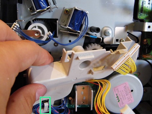

  8. Replace Kyocera FS-1010 sponge rubber, Remove gear cover: crwdns2935265:08crwdnd2935265:01crwdnd2935265:02crwdne2935265:0 Replace Kyocera FS-1010 sponge rubber, Remove gear cover: crwdns2935265:08crwdnd2935265:02crwdnd2935265:02crwdne2935265:0
    • Remove the Phillips screw that secures the gear cover.
    • Be sure to remove the cables from the bracket (green area)!
    • Remove the gear cover.

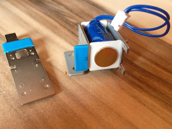

  9. Replace Kyocera FS-1010 sponge rubber, First feed breaker: crwdns2935265:09crwdnd2935265:01crwdnd2935265:01crwdne2935265:0
    • Here are the three intake breakers to work on in the next steps.
    • At the red marked areas usually sits black foam rubber. This causes the problem - over time, it becomes sticky, which causes the interruption of the indentation only delayed. Thus, the paper is fed too short / too far before the printing starts. This will move the text up or down.
    • In most cases, not every entry-breaker causes problems. Nevertheless, it is advisable to replace the foam rubber directly on all parts in order to permanently eliminate the problem.

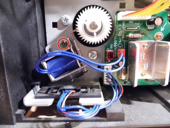

  10. Replace Kyocera FS-1010 sponge rubber, Remove first feed breaker: crwdns2935265:010crwdnd2935265:01crwdnd2935265:01crwdne2935265:0
    • On this feed breaker, you can find foam rubber on the bracket as well as on the main feed breaker.
    • On the photo you can already see the fixed parts. In the green marked spots normally sits black foam rubber.
    • Use a Philips screwdriver to remove the screw securing the feed breaker to the main frame.
    • Remove the feed breaker.
    • Be careful that you don't loose the small spring which connects the bracket to the feed breaker!
    • Remove the bracket afterwards by removing the small spring with tweezers.
  11. Replace Kyocera FS-1010 sponge rubber, Remove old sponge rubber on the metal bracket: crwdns2935265:011crwdnd2935265:01crwdnd2935265:01crwdne2935265:0
    • The green marked area usually contains black sponge rubber.
    • Use a slotted screwdriver, a spudger or something similar to remove the sponge rubber. .
    • Then clean the place to remove the glue residue. For cleaning, e.g. Brake cleaner or silicone spray can be used.
    • After the spot has been cleaned, new sponge rubber or something similar (e.g., felt or shrink tubing as shown in the picture) may be applied.
    • The new material shouldn't be any thicker than the sponge rubber, since the printer might not work if the material is too thick.
    • Before reinstalling, also clean the place where the sponge rubber on the bracket has come into contact with the small metal bracket in the printer to remove the glue residue.

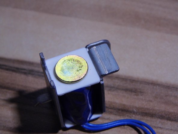

  12. Replace Kyocera FS-1010 sponge rubber, Remove sponge rubber on the first feed breaker: crwdns2935265:012crwdnd2935265:01crwdnd2935265:02crwdne2935265:0 Replace Kyocera FS-1010 sponge rubber, Remove sponge rubber on the first feed breaker: crwdns2935265:012crwdnd2935265:02crwdnd2935265:02crwdne2935265:0
    • In picture 2 you can see the two repaired parts side by side.

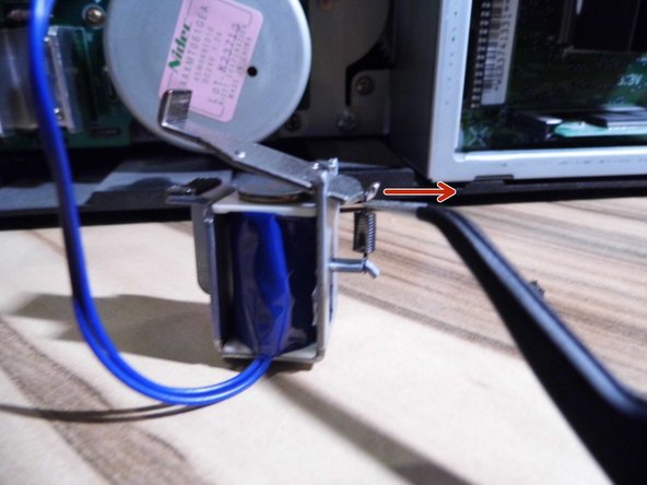

  14. Replace Kyocera FS-1010 sponge rubber, Remove metal bracket: crwdns2935265:014crwdnd2935265:01crwdnd2935265:02crwdne2935265:0 Replace Kyocera FS-1010 sponge rubber, Remove metal bracket: crwdns2935265:014crwdnd2935265:02crwdnd2935265:02crwdne2935265:0
    • Use tweezers or forceps to remove the spring that connects the metal fork to the feed breaker.
    • Make sure that the spring does not fly away when removing!
    • Then remove the metal fork.

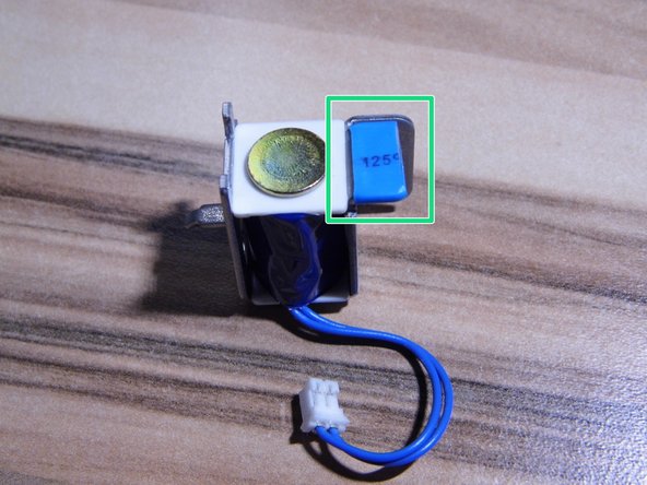

  15. Replace Kyocera FS-1010 sponge rubber, Remove old sponge rubber and replace: crwdns2935265:015crwdnd2935265:01crwdnd2935265:03crwdne2935265:0 Replace Kyocera FS-1010 sponge rubber, Remove old sponge rubber and replace: crwdns2935265:015crwdnd2935265:02crwdnd2935265:03crwdne2935265:0 Replace Kyocera FS-1010 sponge rubber, Remove old sponge rubber and replace: crwdns2935265:015crwdnd2935265:03crwdnd2935265:03crwdne2935265:0
    • After the site has been cleaned, new sponge rubber or something similar (e.g., felt or shrink tubing as shown in Figure 3) can be applied.
    • Before reinstalling, also clean the area where the sponge rubber has come into contact with the metal fork to remove the glue residue.
    • After cleaning and replacing the sponge rubber, the metal fork can be re-attached to the retraction breaker. To do this, follow step 14 in reverse order.
    • Then the feed breaker can be re-installed in the printer. To do this, follow step 13 in reverse order.

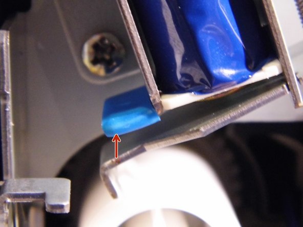

  17. Replace Kyocera FS-1010 sponge rubber, Final result and review: crwdns2935265:017crwdnd2935265:01crwdnd2935265:02crwdne2935265:0 Replace Kyocera FS-1010 sponge rubber, Final result and review: crwdns2935265:017crwdnd2935265:02crwdnd2935265:02crwdne2935265:0
    • Here is the finished result. On all four intake breakers, the old sponge rubber was removed and replaced.
    • To check whether the repair was successful, you can press the metal fork against the feed breaker by hand. If you then let go off the metal fork, it should immediately jump back on the gear.
    • On the other hand, if the metal fork lingers briefly after being released and only returns with a delay, either the material that was used as a replacement is unsuitable or the area has not yet been completely cleaned of all adhesive residues. In this case, steps 10, 11 and 12 or 13, 14 and 15 or 16 should be repeated again.
    • If the replacement material for the sponge rubber is too thick, the gear is still blocked by the metal fork even if the fork is pressed against the feed breaker. In that case, the material should be replaced with a thinner material, since the printer won't function with the thicker material.
