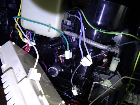

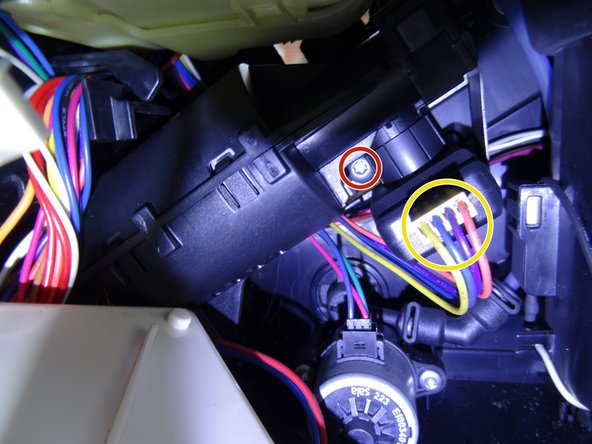

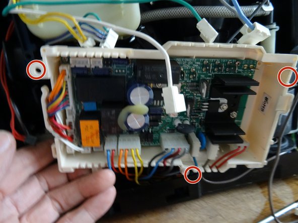

  13. Replace Jura ENA micro gear motor, Gear Motor: crwdns2935265:013crwdnd2935265:01crwdnd2935265:03crwdne2935265:0 Replace Jura ENA micro gear motor, Gear Motor: crwdns2935265:013crwdnd2935265:02crwdnd2935265:03crwdne2935265:0 Replace Jura ENA micro gear motor, Gear Motor: crwdns2935265:013crwdnd2935265:03crwdnd2935265:03crwdne2935265:0
    • The gear motor is located behind the electronics box. First this path has to be cleared.
    • Disconnect the cables on the top row. Be sure to note which connector is plugged in where.
    • Detach the cables on the left side as well
    • From the bottom row you only need to loosen the plug (here blue-red) that belongs to the motor.
    • Unscrew the three Torx T10 screws that hold the box in place.
    • Set the box aside.

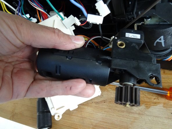

  14. Replace Jura ENA micro gear motor: crwdns2935265:014crwdnd2935265:01crwdnd2935265:03crwdne2935265:0 Replace Jura ENA micro gear motor: crwdns2935265:014crwdnd2935265:02crwdnd2935265:03crwdne2935265:0 Replace Jura ENA micro gear motor: crwdns2935265:014crwdnd2935265:03crwdnd2935265:03crwdne2935265:0
    • The motor is attached with two Torx T20 screws. Remove those. The screws are fastened with some threadlocker. Use this for the re-assembly as well.
    • Unplug the connector from the encoder.
    • Carefully lift out the motor.
    • Disconnect the connecting wires.

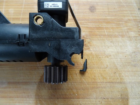

  15. Replace Jura ENA micro gear motor: crwdns2935265:015crwdnd2935265:01crwdnd2935265:02crwdne2935265:0 Replace Jura ENA micro gear motor: crwdns2935265:015crwdnd2935265:02crwdnd2935265:02crwdne2935265:0
    • The error is clearly visible: the fastening eyelet has torn out.

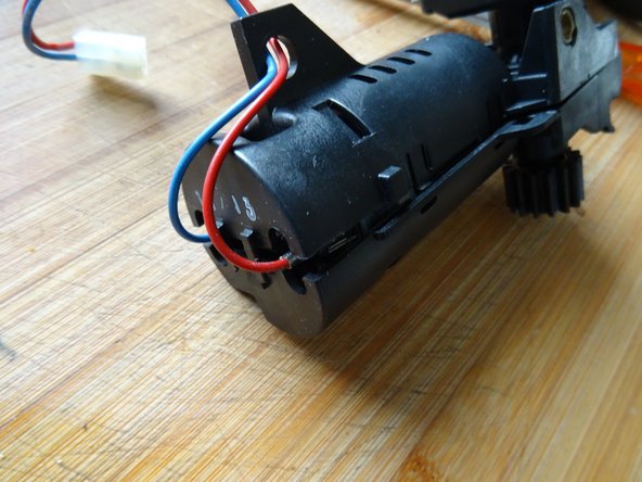

  16. Replace Jura ENA micro gear motor: crwdns2935265:016crwdnd2935265:01crwdnd2935265:02crwdne2935265:0 Replace Jura ENA micro gear motor: crwdns2935265:016crwdnd2935265:02crwdnd2935265:02crwdne2935265:0
    • Detach the bracket from the encoder and remove the encoder.
    • Disconnect the two connecting wires.
    • Transfer the parts to the new motor
