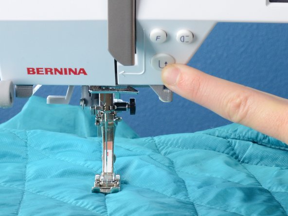

    • Set your sewing machine stitch length to about 3.
    • Clip the extra thread off of your jacket.
  3. Repairing the Stitching on an Insulated Jacket: crwdns2935265:03crwdnd2935265:01crwdnd2935265:02crwdne2935265:0 Repairing the Stitching on an Insulated Jacket: crwdns2935265:03crwdnd2935265:02crwdnd2935265:02crwdne2935265:0
    • Align the jacket in the sewing machine at a distance of roughly five stitches before the missing stitching.
    • Be sure that the jacket is unzipped and that you only have one layer of the jacket, including the lining, in the sewing machine. Sewing two layers together will sew the jacket shut.
  4. Repairing the Stitching on an Insulated Jacket: crwdns2935265:04crwdnd2935265:01crwdnd2935265:03crwdne2935265:0 Repairing the Stitching on an Insulated Jacket: crwdns2935265:04crwdnd2935265:02crwdnd2935265:03crwdne2935265:0 Repairing the Stitching on an Insulated Jacket: crwdns2935265:04crwdnd2935265:03crwdnd2935265:03crwdne2935265:0
    • Sink the needle, being sure that it aligns with the stitching.
    • Sew forward a few stitches and then backstitch to hold your stitches in place.
    • Sew along the holes where the stitching used to be.
  5. Repairing the Stitching on an Insulated Jacket: crwdns2935265:05crwdnd2935265:01crwdnd2935265:03crwdne2935265:0 Repairing the Stitching on an Insulated Jacket: crwdns2935265:05crwdnd2935265:02crwdnd2935265:03crwdne2935265:0 Repairing the Stitching on an Insulated Jacket: crwdns2935265:05crwdnd2935265:03crwdnd2935265:03crwdne2935265:0
    • Continue sewing until you overlap five of the remaining stitches.
    • Backstitch to hold your stitches in place.
    • Clip any threads to free the garment from the sewing machine.
