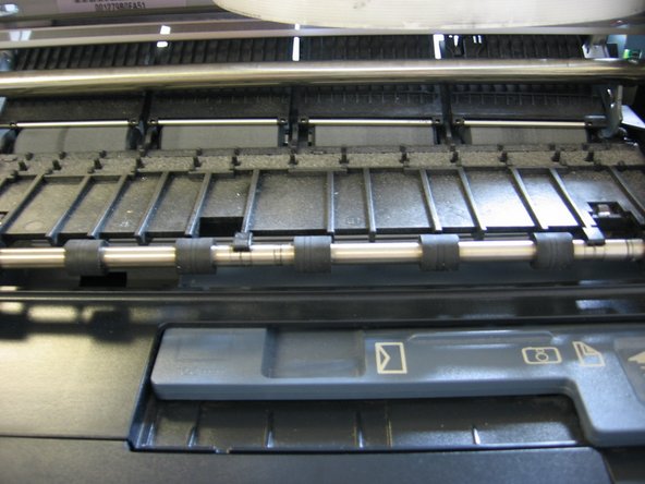

    • Once you have removed the device top case using the General Device Disassembly Guide, you can access the rubber paper rollers. located near the front, holding the silver bar in place.
    • They are located near the front, holding the silver bar in place.
  9. Repairing HP Deskjet 6840 Rubber Paper Feed Rollers: crwdns2935265:09crwdnd2935265:01crwdnd2935265:01crwdne2935265:0
    • If the rubber paper rollers are causing the problem, you’ll notice that pressing the Resume button does not spin the metal bar held by the rollers.
    • Remove the roller assembly from the printer case.
    • Firmly grip one of the end rubber rollers (or use pliers) and twist it. This should rotate the metal bar and release any paper debris that is preventing the printer from functioning properly.
