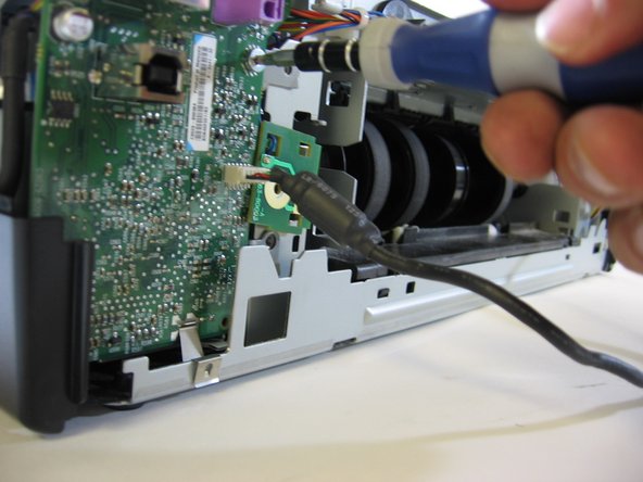

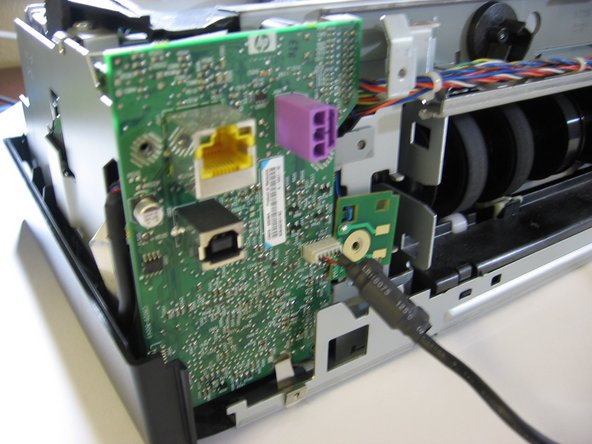

  5. HP Deskjet 6840 General Device Disassembly: crwdns2935265:05crwdnd2935265:01crwdnd2935265:03crwdne2935265:0 HP Deskjet 6840 General Device Disassembly: crwdns2935265:05crwdnd2935265:02crwdnd2935265:03crwdne2935265:0 HP Deskjet 6840 General Device Disassembly: crwdns2935265:05crwdnd2935265:03crwdnd2935265:03crwdne2935265:0
    • Use a screwdriver to remove the screws from the printer carriage assembly and the green plastic motherboard.
    • Gently loosen the motherboard from its base, but do not fully remove it.

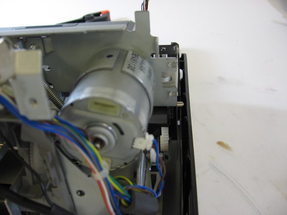

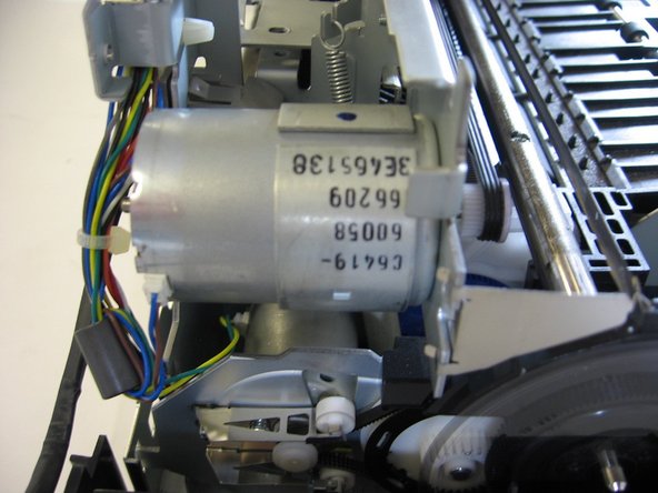

  6. HP Deskjet 6840 General Device Disassembly: crwdns2935265:06crwdnd2935265:01crwdnd2935265:03crwdne2935265:0 HP Deskjet 6840 General Device Disassembly: crwdns2935265:06crwdnd2935265:02crwdnd2935265:03crwdne2935265:0 HP Deskjet 6840 General Device Disassembly: crwdns2935265:06crwdnd2935265:03crwdnd2935265:03crwdne2935265:0
    • Use a screwdriver to remove the screws securing the motor carriage.
    • If you need to replace the motor, remove the screws from the motor housing.
    • Carefully lift the motor out of the housing with your fingers and replace it with a new one.

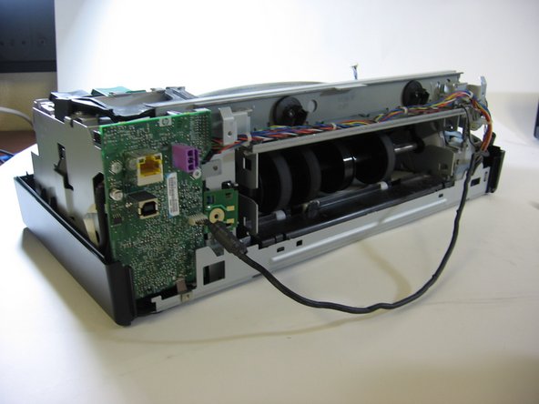

  7. HP Deskjet 6840 General Device Disassembly: crwdns2935265:07crwdnd2935265:01crwdnd2935265:03crwdne2935265:0 HP Deskjet 6840 General Device Disassembly: crwdns2935265:07crwdnd2935265:02crwdnd2935265:03crwdne2935265:0 HP Deskjet 6840 General Device Disassembly: crwdns2935265:07crwdnd2935265:03crwdnd2935265:03crwdne2935265:0
    • By now, your printer should resemble the one in the photograph.
    • Use the screwdriver to remove any remaining screws.
