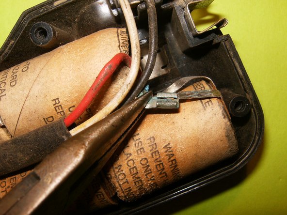

    • Disconnect the battery cables
  3. Repairing Black and Decker - TS221 Ranger CD2000 Battery: crwdns2935265:03crwdnd2935265:01crwdnd2935265:03crwdne2935265:0 Repairing Black and Decker - TS221 Ranger CD2000 Battery: crwdns2935265:03crwdnd2935265:02crwdnd2935265:03crwdne2935265:0 Repairing Black and Decker - TS221 Ranger CD2000 Battery: crwdns2935265:03crwdnd2935265:03crwdnd2935265:03crwdne2935265:0
    • Disconnect the battery cable on the bottom of the pack.
    • It is easier to remove the top,
    • and bottom cable with a pair of needle nose pliers.

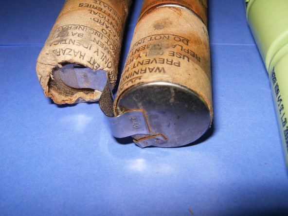

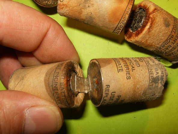

    • Remove the battery pack
    • Heavy corrosion can be found on all battery tabs,
    • as well as some sort of liquid damage.

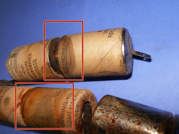

  5. Repairing Black and Decker - TS221 Ranger CD2000 Battery: crwdns2935265:05crwdnd2935265:01crwdnd2935265:03crwdne2935265:0 Repairing Black and Decker - TS221 Ranger CD2000 Battery: crwdns2935265:05crwdnd2935265:02crwdnd2935265:03crwdne2935265:0 Repairing Black and Decker - TS221 Ranger CD2000 Battery: crwdns2935265:05crwdnd2935265:03crwdnd2935265:03crwdne2935265:0
    • The battery tabs or spot welded to the batteries.
    • They are in series, meaning they connect from the positive post of one battery to the negative of the next.
    • Here are the 5 replacement batteries. They are 4/5sub C batteries. This means the are 80% the size of a C battery. 1.3" (33.4mm) in length by 0.9" (23mm) in diameter. 5x1.2V in series gives 6V x 2000mah

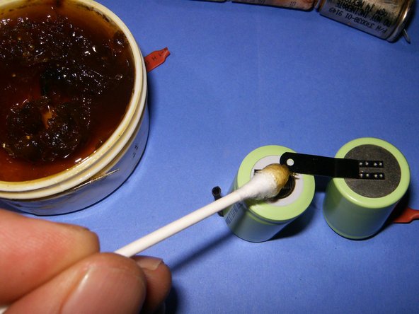

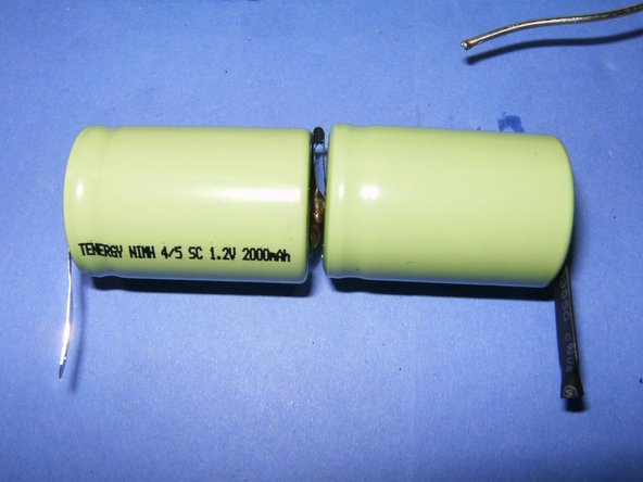

    • Start off by laying the connections out. Again, negative connects to positive.
    • The tabs are thin sheet metal and can be cut with a pair of scissors. cut the positive tab of the second battery. The left over spot welded tab will become the solder point for the first battery.
    • Use flux between the connections.
  7. Repairing Black and Decker - TS221 Ranger CD2000 Battery: crwdns2935265:07crwdnd2935265:01crwdnd2935265:03crwdne2935265:0 Repairing Black and Decker - TS221 Ranger CD2000 Battery: crwdns2935265:07crwdnd2935265:02crwdnd2935265:03crwdne2935265:0 Repairing Black and Decker - TS221 Ranger CD2000 Battery: crwdns2935265:07crwdnd2935265:03crwdnd2935265:03crwdne2935265:0
    • Here is the first set soldered. Negative connects to positive.
    • Continue with the next battery. Remember to now connect the negative from the second battery to the positive of the third.
    • Again, use flux and solder the tab to the battery.

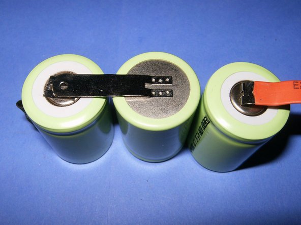

    • Here is the completed first row of three batteries.
    • To connect the next row, it is important to remember that the negative from the bottom row continues to connect to the positive of the top row
    • Position the last two battery so that the polarity matches the way the connect to the back of three.
  9. Repairing Black and Decker - TS221 Ranger CD2000 Battery: crwdns2935265:09crwdnd2935265:01crwdnd2935265:03crwdne2935265:0 Repairing Black and Decker - TS221 Ranger CD2000 Battery: crwdns2935265:09crwdnd2935265:02crwdnd2935265:03crwdne2935265:0 Repairing Black and Decker - TS221 Ranger CD2000 Battery: crwdns2935265:09crwdnd2935265:03crwdnd2935265:03crwdne2935265:0
    • Solder the top two batteries together.
    • Position the batteries so they will match the proper polarity and do not cut the tabs.
    • To connect the bank of three batteries with the last two, leave the tabs the original length and solder those tabs together. Use some hemostats or alligator clamps to hold the tab while soldering.

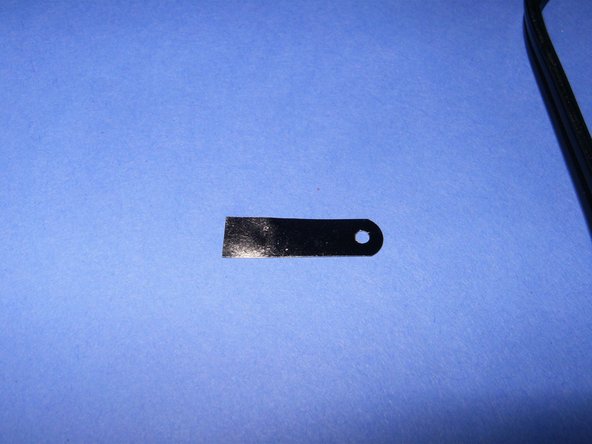

  10. Repairing Black and Decker - TS221 Ranger CD2000 Battery: crwdns2935265:010crwdnd2935265:01crwdnd2935265:03crwdne2935265:0 Repairing Black and Decker - TS221 Ranger CD2000 Battery: crwdns2935265:010crwdnd2935265:02crwdnd2935265:03crwdne2935265:0 Repairing Black and Decker - TS221 Ranger CD2000 Battery: crwdns2935265:010crwdnd2935265:03crwdnd2935265:03crwdne2935265:0
    • The bottom bank of three batteries has a cable connector on the negative post.
    • Use one of the tabs previously cut off from one of the battery,
    • and solder it to the negative post of the new battery pack
