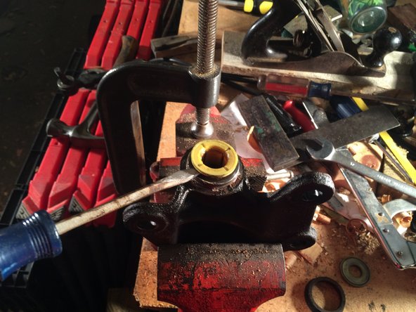

  2. Repairing 1984-1989 Toyota 4Runner Idler Arm: crwdns2935265:02crwdnd2935265:01crwdnd2935265:02crwdne2935265:0 Repairing 1984-1989 Toyota 4Runner Idler Arm: crwdns2935265:02crwdnd2935265:02crwdnd2935265:02crwdne2935265:0
    • Place the arm in a vise.
    • Spray the cap with penetrating lubricant.
    • Using a screw driver, tap the idler arm bracket cap off.
    • If it will not come off easily, then check out the trouble shooting page.

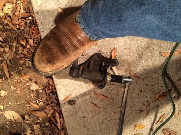

  3. Repairing 1984-1989 Toyota 4Runner Idler Arm: crwdns2935265:03crwdnd2935265:01crwdnd2935265:03crwdne2935265:0 Repairing 1984-1989 Toyota 4Runner Idler Arm: crwdns2935265:03crwdnd2935265:02crwdnd2935265:03crwdne2935265:0 Repairing 1984-1989 Toyota 4Runner Idler Arm: crwdns2935265:03crwdnd2935265:03crwdnd2935265:03crwdne2935265:0
    • Using a 19 mm socket, take the nut off from inside the idler arm bracket.
    • If the arm rotates in the bracket, then it can be taken out of the vice and placed on the ground.
    • Once on the ground, your foot can be used to stop the arm from rotating and enable you to put torque on the nut.
    • Once the nut is off, the arm can be gently tapped out of the bracket.

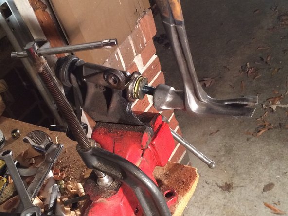

  4. Repairing 1984-1989 Toyota 4Runner Idler Arm: crwdns2935265:04crwdnd2935265:01crwdnd2935265:02crwdne2935265:0 Repairing 1984-1989 Toyota 4Runner Idler Arm: crwdns2935265:04crwdnd2935265:02crwdnd2935265:02crwdne2935265:0
    • Remove the oil seal.
    • Remove the plastic bushings with a flat head.
    • Both bushings and oil seals should be removed and replaced.
    • Fill the bracket with MP grease and then put the arm back into the bracket.
    • Wipe off any grease that squeezes out of the bracket.
