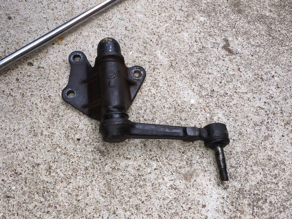

    • Locate the idler arm.
    • It can be found underneath the vehicle, next to the front passenger tire bolted onto the frame.

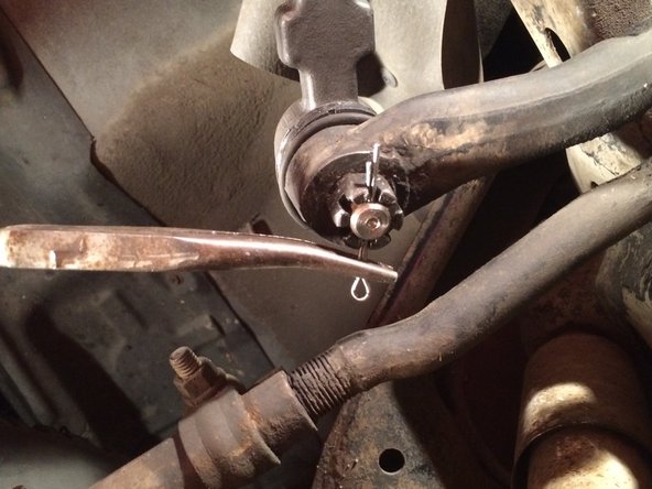

    • The first step is to remove the set nut holding the arm to the relay rod.
    • Begin with cleaning any oil and dirt from the set nut and then spray with the penetrating lubricant.
    • Once the spray has sat for 5 minutes, use needle nose pliers to straighten the cotter pin and pull it out.
    • During reassembly, never reuse a cotter pin. A new one should be included in a new arm. If a new arm is not purchased then one can be purchased from an auto parts store.

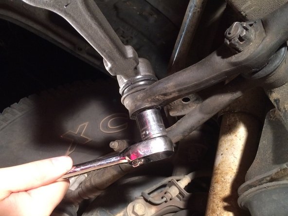

    • Remove the set nut using a 19 mm socket.
    • When installing the arm this nut should be torqued to 43 ft.-lb.

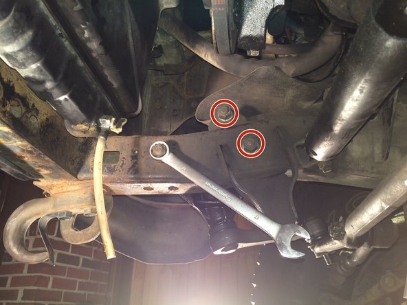

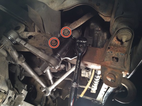

    • Now that the relay rods are disconnected, the arm can be unbolted from the frame.
    • Spray both the bolts and the nuts with the penetrating lubricant.
    • On the bolt head use the breaker bar and 17 mm socket; put the 17 mm box wrench on the nut on the back side of the arm.
    • The wrench will get stuck on the frame and the breaker bar can then be used to break the rust off the bolt holding it onto the frame.
    • Once the bolt is loose a socket wrench can replace the breaker bar to make the job easier.
    • The (2) 4 1/4" bolts go on either side of the arm. The (1) 3 1/2" bolt goes at the top.
    • All three bolts should be torqued to 70 ft-lb when putting the arm back on.

    • To separate the arm from the relay rods, a hammer may be used to gently tap up on the idler arm.
    • Do not hit down on the relay rods; doing so may cause damage and require them to be replaced.
    • A pitman arm puller can be used if the hammer is not able to knock it loose.
    • The idler arm can now be removed from the frame.
