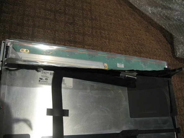

  12. Removing CCFL from iMac 20in LCD CCFL assembly, LCD Backlights (CCFL): crwdns2935265:012crwdnd2935265:01crwdnd2935265:03crwdne2935265:0 Removing CCFL from iMac 20in LCD CCFL assembly, LCD Backlights (CCFL): crwdns2935265:012crwdnd2935265:02crwdnd2935265:03crwdne2935265:0 Removing CCFL from iMac 20in LCD CCFL assembly, LCD Backlights (CCFL): crwdns2935265:012crwdnd2935265:03crwdnd2935265:03crwdne2935265:0
    • The rest of this procedure should be done in the cleanest possible work environment to avoid dust getting BEHIND the LCD (I learned this the HARD way!)
    • Once the LCD panel is removed you need to peel back the black foil from the top edge of the LCD to reveal the clear plastic PCB protector.
    • Now gently peel the clear plastic PCB protector off the top edge. Make sure you don't damage the flex cables attached to the PBC you are exposing.
    • There are a total of 8 flex cables along the top edge

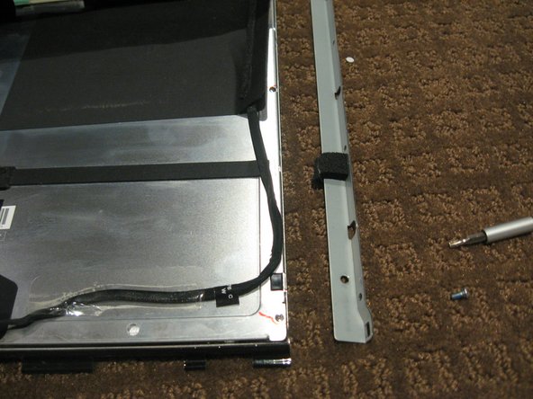

  13. Removing CCFL from iMac 20in LCD CCFL assembly: crwdns2935265:013crwdnd2935265:01crwdnd2935265:03crwdne2935265:0 Removing CCFL from iMac 20in LCD CCFL assembly: crwdns2935265:013crwdnd2935265:02crwdnd2935265:03crwdne2935265:0 Removing CCFL from iMac 20in LCD CCFL assembly: crwdns2935265:013crwdnd2935265:03crwdnd2935265:03crwdne2935265:0

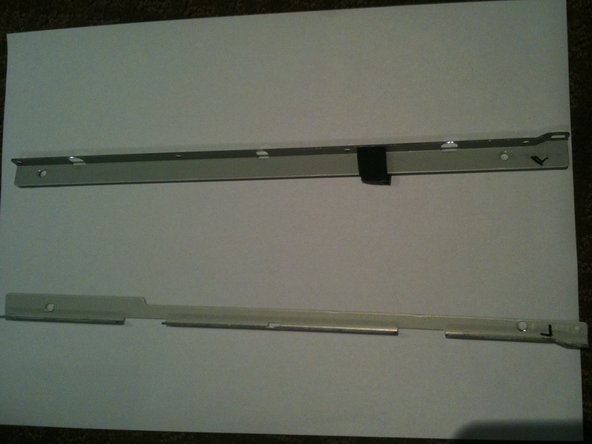

    • Use a sharpie or similar, mark the side brackets on either side of the LCD panel before removing screws as they are different
    • Use a T10 Torx driver to remove the 2 screws from each side bracket (total 4 screws)

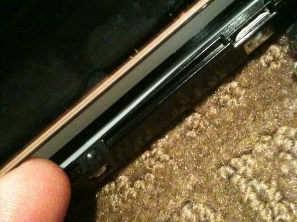

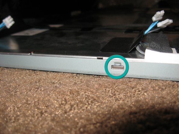

  14. Removing CCFL from iMac 20in LCD CCFL assembly: crwdns2935265:014crwdnd2935265:01crwdnd2935265:03crwdne2935265:0 Removing CCFL from iMac 20in LCD CCFL assembly: crwdns2935265:014crwdnd2935265:02crwdnd2935265:03crwdne2935265:0 Removing CCFL from iMac 20in LCD CCFL assembly: crwdns2935265:014crwdnd2935265:03crwdnd2935265:03crwdne2935265:0

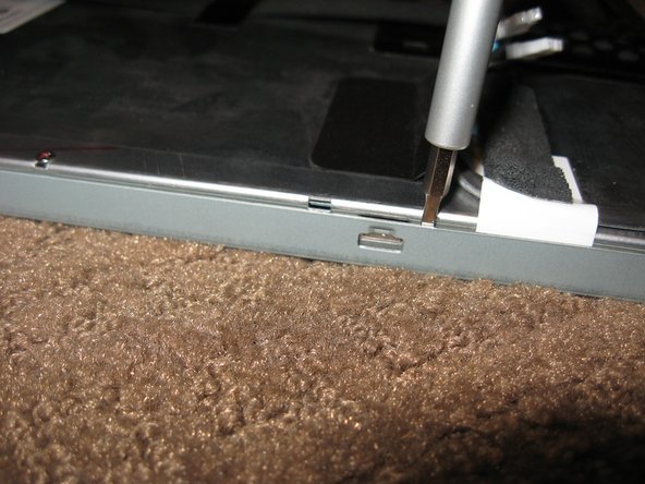

    • Stand the LCD panel on its TOP edge and locate the lock tabs along the BOTTOM edge. There are 5 along the length of the bottom edge
    • Use a flat blade driver or metal spudger to Gently pop the bezel off the lock tabs.
    • Locate the lock tabs on either side of the LCD panel. There are 2 on each side
    • Use a flat blade driver or metal spudger to Gently pop the bezel off the side lock tabs.

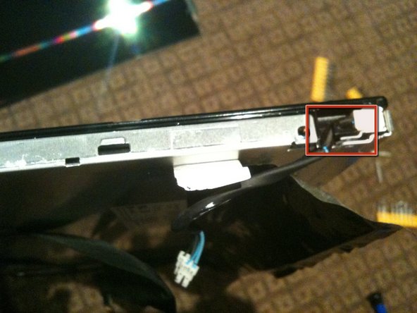

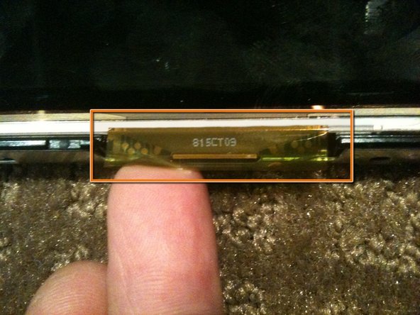

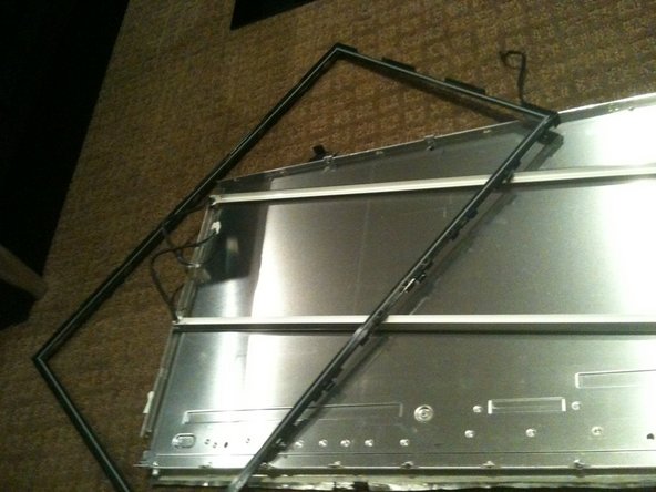

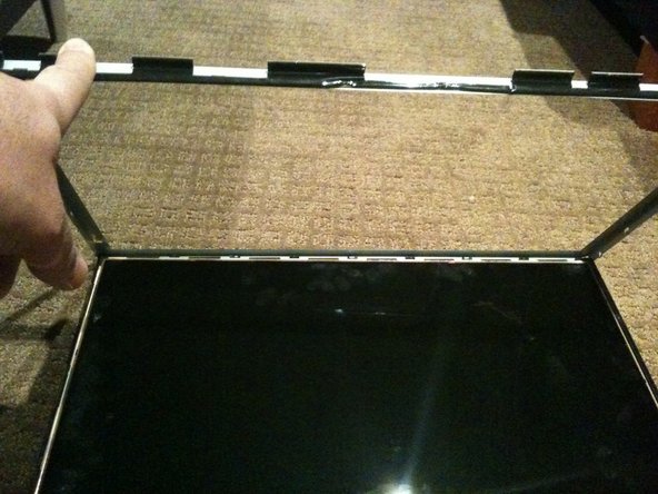

  15. Removing CCFL from iMac 20in LCD CCFL assembly: crwdns2935265:015crwdnd2935265:01crwdnd2935265:03crwdne2935265:0 Removing CCFL from iMac 20in LCD CCFL assembly: crwdns2935265:015crwdnd2935265:02crwdnd2935265:03crwdne2935265:0 Removing CCFL from iMac 20in LCD CCFL assembly: crwdns2935265:015crwdnd2935265:03crwdnd2935265:03crwdne2935265:0
    • Now gently separate the metal bezel from the main body of the LCD panel
    • Lay the LCD panel down on with viewing side UP and remove the metal bezel
    • Make sure you are careful when removing the bezel from the TOP edge as you will be exposing the 8 flex cables mentioned in step 1.
    • Note the 3 flex tabs on the left edge
    • Do not damage any of the tabs or flex cables as these are the Row and Column Drivers. Damage to these will will cause faults like vertical/horizontal lines or white screen etc.
    • WARNING - Once the bezel is removed the LCD is LOOSE in the black plastic frame - only held in by the small gasket underneath.

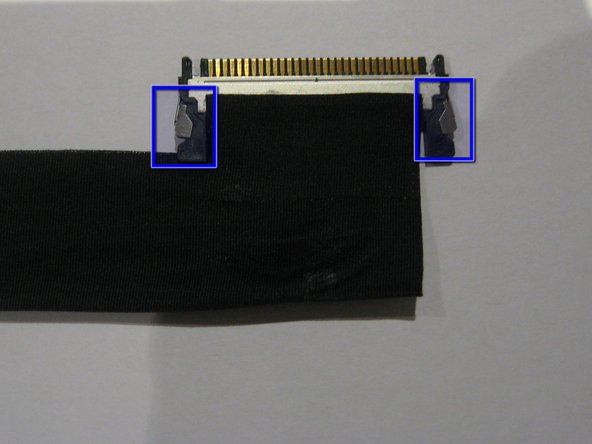

  17. Removing CCFL from iMac 20in LCD CCFL assembly: crwdns2935265:017crwdnd2935265:01crwdnd2935265:02crwdne2935265:0 Removing CCFL from iMac 20in LCD CCFL assembly: crwdns2935265:017crwdnd2935265:02crwdnd2935265:02crwdne2935265:0

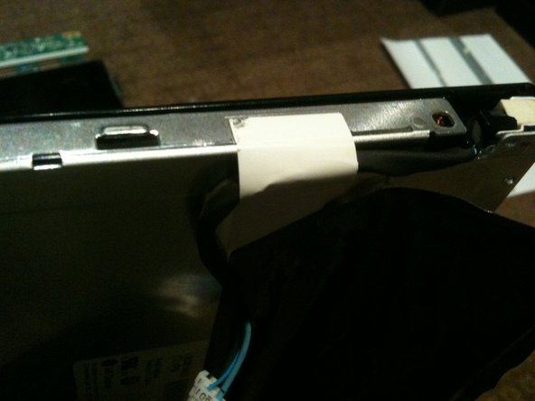

    • Remove the tape securing the LVDS cable
    • Press IN the 2 silver spring loaded catches on either side to release the cable and gently extract it from the connector

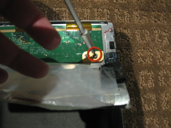

  18. Removing CCFL from iMac 20in LCD CCFL assembly: crwdns2935265:018crwdnd2935265:01crwdnd2935265:02crwdne2935265:0 Removing CCFL from iMac 20in LCD CCFL assembly: crwdns2935265:018crwdnd2935265:02crwdnd2935265:02crwdne2935265:0
    • Peel the back Black foil and clear plastic PCB protector to fully expose the PCB that runs across the top of the LCD assembly
    • Remove the 2ea Philips head screws from each end of the PCB
    • The PCB actually has a 3rd screw hole in the centre of the board. Perhaps my assembly is missing a screw

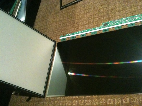

  19. Removing CCFL from iMac 20in LCD CCFL assembly: crwdns2935265:019crwdnd2935265:01crwdnd2935265:02crwdne2935265:0 Removing CCFL from iMac 20in LCD CCFL assembly: crwdns2935265:019crwdnd2935265:02crwdnd2935265:02crwdne2935265:0
    • Gently flip the PCB over 180deg so it is off the aluminum back panel.
    • Be CAREFUL not to damage the 8 flex cables
    • The PCB may be attached to the aluminium by some adhesive near the LVDS connector. IF so use a plastic pry tool or spudger to GENTLY lift the PCB up
    • Now lift the the back panel off the LCD separating the LCD from the back light assembly

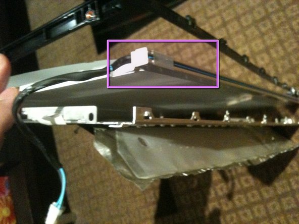

  20. Removing CCFL from iMac 20in LCD CCFL assembly: crwdns2935265:020crwdnd2935265:01crwdnd2935265:03crwdne2935265:0 Removing CCFL from iMac 20in LCD CCFL assembly: crwdns2935265:020crwdnd2935265:02crwdnd2935265:03crwdne2935265:0 Removing CCFL from iMac 20in LCD CCFL assembly: crwdns2935265:020crwdnd2935265:03crwdnd2935265:03crwdne2935265:0
    • Disassembling the back-light assembly is a little fiddly as there are a number of parts that all want to come apart at the same time
    • Remove the 6 Philips screws from the rear of the back light assembly
    • Removing the white tape from the CCFL cable.
    • Un-clip the CCFL cable from the black plastic surround
    • There are 2 CCFL cables and the process is essentially the same for each

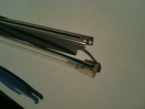

  21. Removing CCFL from iMac 20in LCD CCFL assembly: crwdns2935265:021crwdnd2935265:01crwdnd2935265:03crwdne2935265:0 Removing CCFL from iMac 20in LCD CCFL assembly: crwdns2935265:021crwdnd2935265:02crwdnd2935265:03crwdne2935265:0 Removing CCFL from iMac 20in LCD CCFL assembly: crwdns2935265:021crwdnd2935265:03crwdnd2935265:03crwdne2935265:0
    • Separate the black plastic surround from the aluminum back plate to access the CCFL tube assemblies
    • Start by un-clipping the tabs along the top edge of the assembly. There are 4 tabs along the top
    • The top CCFL tube can be seen and CAREFULLY removed
  22. Removing CCFL from iMac 20in LCD CCFL assembly: crwdns2935265:022crwdnd2935265:01crwdnd2935265:03crwdne2935265:0 Removing CCFL from iMac 20in LCD CCFL assembly: crwdns2935265:022crwdnd2935265:02crwdnd2935265:03crwdne2935265:0 Removing CCFL from iMac 20in LCD CCFL assembly: crwdns2935265:022crwdnd2935265:03crwdnd2935265:03crwdne2935265:0
    • The bottom of the black surround can now be un-clipped and the entire surround removed
    • There are 4 tabs along the bottom of the assembly

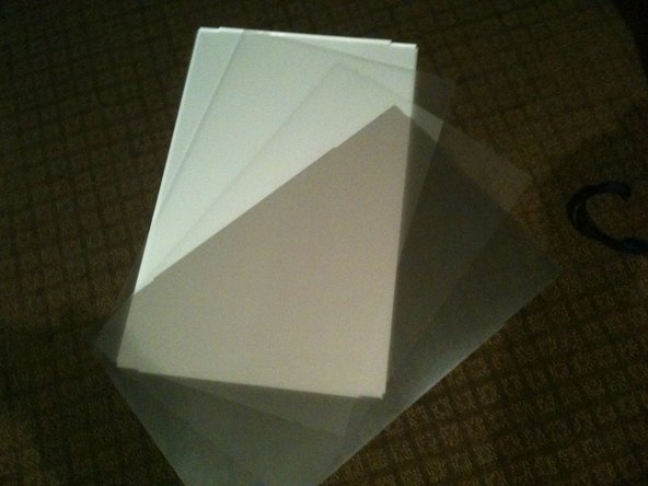

    • Once the black surround is off the rest pretty much comes apart with the bottom CCFL tube being able to be removed in a similar manner to the top
    • The centre of the back light assembly is made up of 4 main parts. A perspex sheet with white plastic coating, 2 opaque matt plastic sheets, and 1 Pearlescent matt plastic sheet
    • The plastic sheets are polarisers so need to be kept clean and free of dust and scratches

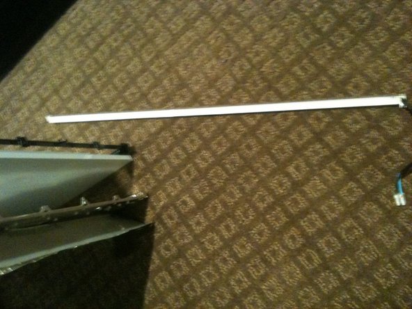

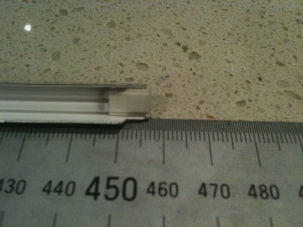

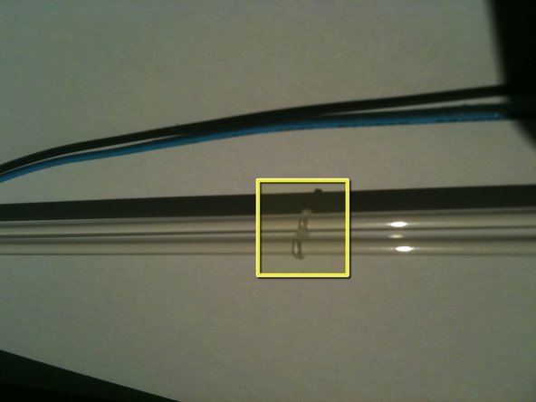

  23. Removing CCFL from iMac 20in LCD CCFL assembly: crwdns2935265:023crwdnd2935265:01crwdnd2935265:03crwdne2935265:0 Removing CCFL from iMac 20in LCD CCFL assembly: crwdns2935265:023crwdnd2935265:02crwdnd2935265:03crwdne2935265:0 Removing CCFL from iMac 20in LCD CCFL assembly: crwdns2935265:023crwdnd2935265:03crwdnd2935265:03crwdne2935265:0

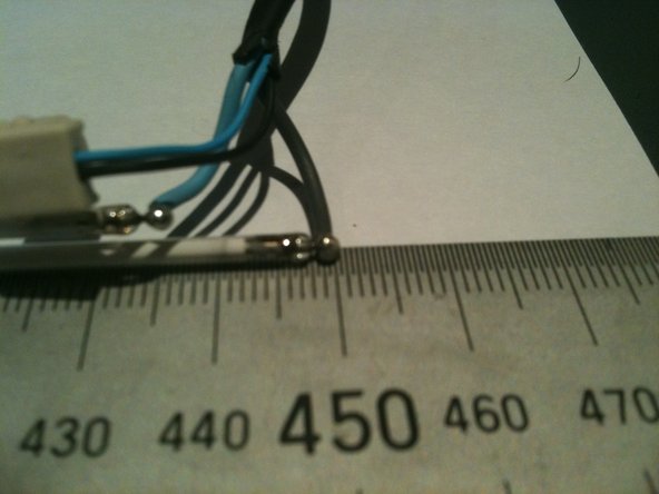

    • The CCLF tube assemblies are made up of a U shaped reflector with 2ea individual tubes inside. The entire assembly is 457mm long and 7.6mm wide. There are no part numbers on the assembly however there is a S on the end with the wires attached and an 18 on the other end.
    • The 2 CCFL tubes are held together with a figure 8 rubber band in the middle of the reflector so both tubes must come out at the same time.
    • The individual tubes are 448mm long (excluding the terminals - standard way to measure is end of glass to end of glass) and are 2.4mm diameter.
    • The CCFL are soldered to the wires so not a simple plug in replacement
    • The CCFL are EXTREMELY fragile so ensure you dont break them when installing them.
    • The CCFL reflectors are a tight fit over the sides of the perspex sheet and the other layers of plastic. Patience and a plastic spudger or pry tool should get you there
    • The closest I can find to my CCFL measurements are either the 446mm x 2.4mm or the 450mm x 2.4mm so I'd suggest the 446mm is used
    • See the Removing CCFL from iMac 20in LCD CCFL assembly guide for details

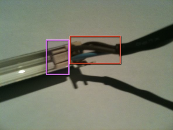

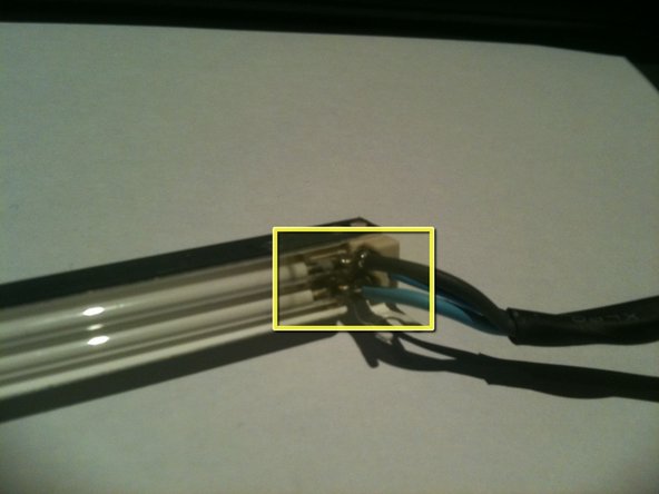

  24. Removing CCFL from iMac 20in LCD CCFL assembly, CCFL assembly: crwdns2935265:024crwdnd2935265:01crwdnd2935265:03crwdne2935265:0 Removing CCFL from iMac 20in LCD CCFL assembly, CCFL assembly: crwdns2935265:024crwdnd2935265:02crwdnd2935265:03crwdne2935265:0 Removing CCFL from iMac 20in LCD CCFL assembly, CCFL assembly: crwdns2935265:024crwdnd2935265:03crwdnd2935265:03crwdne2935265:0
    • Remove the white tape from either end of the rear of the CCFL assembly.
    • Carefully remove about 15-20mm of heat shrink from the CCFL cable to allow the end cap to be removed, making sure you DO NOT cut or nick the wire insulation.
    • The wires have a HIGH VOLTAGE applied during operation and the insulation may break down if damaged causing a short
    • While holding the assembly, slowly and gently pull the THICK wires up and out of the slots in the white rubber cap.
    • Pull the wires one at a time ensuring you don't flex the CCFL and break it.
    • This will reveal the pins and solder joints.

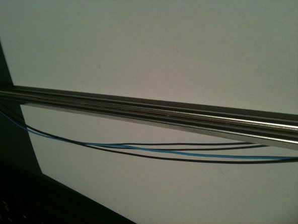

  25. Removing CCFL from iMac 20in LCD CCFL assembly: crwdns2935265:025crwdnd2935265:01crwdnd2935265:03crwdne2935265:0 Removing CCFL from iMac 20in LCD CCFL assembly: crwdns2935265:025crwdnd2935265:02crwdnd2935265:03crwdne2935265:0 Removing CCFL from iMac 20in LCD CCFL assembly: crwdns2935265:025crwdnd2935265:03crwdnd2935265:03crwdne2935265:0
    • Gently push the THIN wires through the rubber end cap to create a bit of a loop on the rear of the assembly.
    • Using a plastic pry tool you can pop the rubber end cap out and then lift the thin wires out of the groove in the rear of the CCFL assembly
    • Note the thin wires are held in the groove by a small amount of adhesive.
    • Run the pry tool the length of the assembly and free the wires all the way to the other end cap
    • gently pop the rubber end cap out of the assembly
  26. Removing CCFL from iMac 20in LCD CCFL assembly: crwdns2935265:026crwdnd2935265:01crwdnd2935265:03crwdne2935265:0 Removing CCFL from iMac 20in LCD CCFL assembly: crwdns2935265:026crwdnd2935265:02crwdnd2935265:03crwdne2935265:0 Removing CCFL from iMac 20in LCD CCFL assembly: crwdns2935265:026crwdnd2935265:03crwdnd2935265:03crwdne2935265:0
    • Gently pull the rubber end cap off the CCFL to expose the pins and solder joints
    • The CCFL are FRAGILE and will easily break
    • Now its a simple task of un-soldering each wire and soldering in the new CCFL
    • There is a little figure 8 rubber band tying the 2 CCFL together at their centre.
