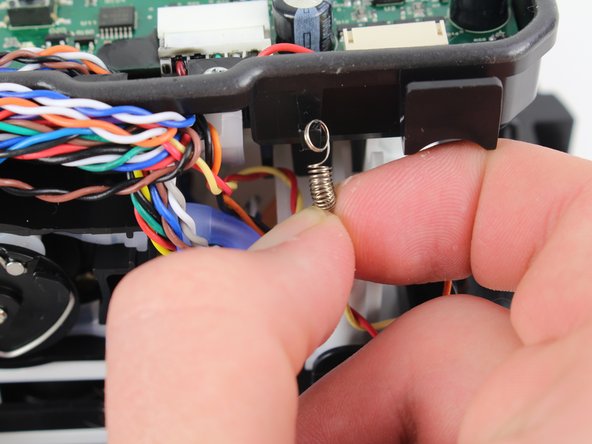

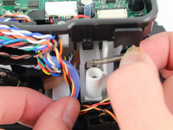

  12. Remove the iRobot Braava Jet 240 Motherboard Case, Remove pad ejection lever spring: crwdns2935265:012crwdnd2935265:01crwdnd2935265:03crwdne2935265:0 Remove the iRobot Braava Jet 240 Motherboard Case, Remove pad ejection lever spring: crwdns2935265:012crwdnd2935265:02crwdnd2935265:03crwdne2935265:0 Remove the iRobot Braava Jet 240 Motherboard Case, Remove pad ejection lever spring: crwdns2935265:012crwdnd2935265:03crwdnd2935265:03crwdne2935265:0
    • First pull up, then pull down on the spring to detach it from the hooks.

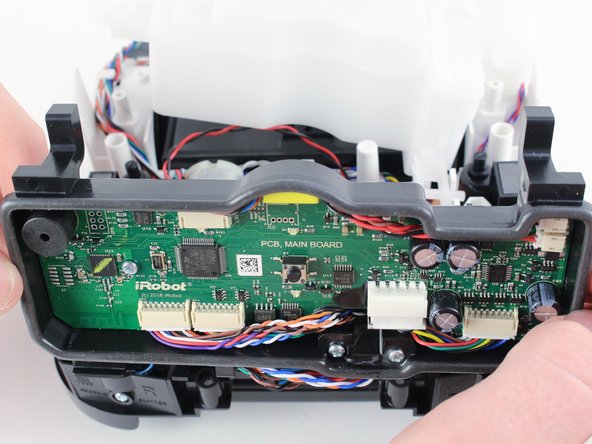

  13. Remove the iRobot Braava Jet 240 Motherboard Case, Remove the motherboard case: crwdns2935265:013crwdnd2935265:01crwdnd2935265:03crwdne2935265:0 Remove the iRobot Braava Jet 240 Motherboard Case, Remove the motherboard case: crwdns2935265:013crwdnd2935265:02crwdnd2935265:03crwdne2935265:0 Remove the iRobot Braava Jet 240 Motherboard Case, Remove the motherboard case: crwdns2935265:013crwdnd2935265:03crwdnd2935265:03crwdne2935265:0
    • Lift up on the motherboard case and pull it forward to remove it from the device. This will expose the free-floating platform, as well as motors, water tubing, and the magnetic sensor pads.
