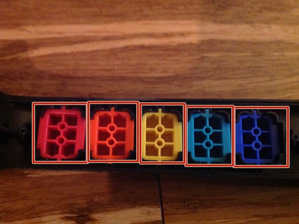

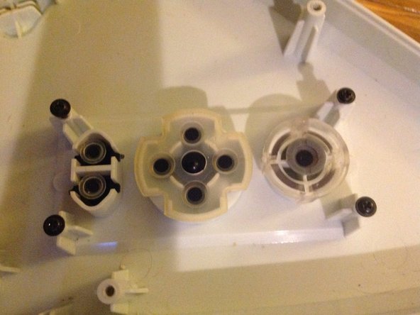

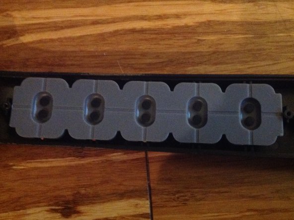

  3. RedOctane X-Plorer Teardown, Colored Keys: crwdns2935265:03crwdnd2935265:01crwdnd2935265:03crwdne2935265:0 RedOctane X-Plorer Teardown, Colored Keys: crwdns2935265:03crwdnd2935265:02crwdnd2935265:03crwdne2935265:0 RedOctane X-Plorer Teardown, Colored Keys: crwdns2935265:03crwdnd2935265:03crwdnd2935265:03crwdne2935265:0
    • Unscrew the 2 Philips head screws
    • Peel off the pads.
    • Push the colored keys out from the other side.

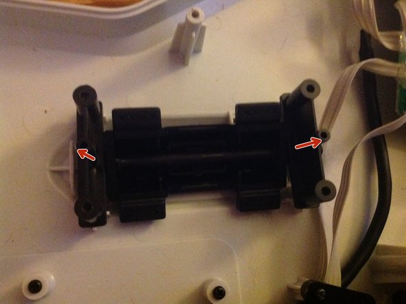

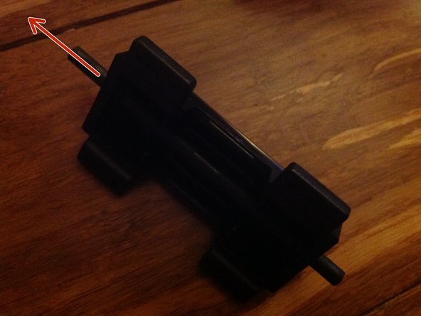

  4. RedOctane X-Plorer Teardown, Strum Bar: crwdns2935265:04crwdnd2935265:01crwdnd2935265:03crwdne2935265:0 RedOctane X-Plorer Teardown, Strum Bar: crwdns2935265:04crwdnd2935265:02crwdnd2935265:03crwdne2935265:0 RedOctane X-Plorer Teardown, Strum Bar: crwdns2935265:04crwdnd2935265:03crwdnd2935265:03crwdne2935265:0
    • Unscrew the red screws and pull the board out.
    • Then, unscrew the blue screws
    • Pull the bracket things off.
    • Pull out the pin.

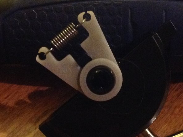

  7. RedOctane X-Plorer Teardown, Whammy Bar: crwdns2935265:07crwdnd2935265:01crwdnd2935265:02crwdne2935265:0 RedOctane X-Plorer Teardown, Whammy Bar: crwdns2935265:07crwdnd2935265:02crwdnd2935265:02crwdne2935265:0
    • Push from the other side until it comes out.
    • Take the spring off with the connector
