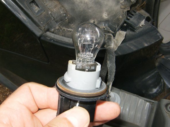

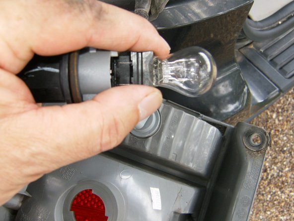

  5. Rear Turn Signal Bulb Replacement: crwdns2935265:05crwdnd2935265:01crwdnd2935265:03crwdne2935265:0 Rear Turn Signal Bulb Replacement: crwdns2935265:05crwdnd2935265:02crwdnd2935265:03crwdne2935265:0 Rear Turn Signal Bulb Replacement: crwdns2935265:05crwdnd2935265:03crwdnd2935265:03crwdne2935265:0
    • Remove the bulb socket by turning it about 1/4 turn in a counter clockwise direction
    • Remove the socket from the light assembly
    • Remove the bulb from the socket by pulling it straight out.
  6. Rear Turn Signal Bulb Replacement: crwdns2935265:06crwdnd2935265:01crwdnd2935265:01crwdne2935265:0
    • Replace the burned out bulb with a new type 3057 dual filament bulb
