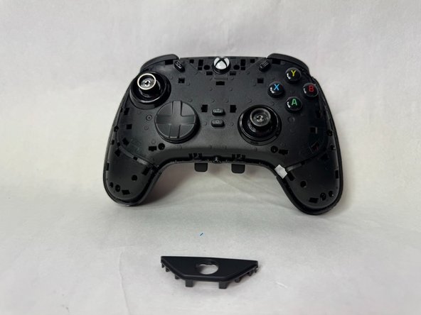

    • Using an opening tool, pry off the the outer front plate.
    • It might take a bit of wiggling and time to loosen it and get it off.
    • Once the front plate is loose, pull it off.
  2. Razer Wolverine V2 Chroma RZ06-0401 Midframe Replacement: crwdns2935265:02crwdnd2935265:01crwdnd2935265:02crwdne2935265:0 Razer Wolverine V2 Chroma RZ06-0401 Midframe Replacement: crwdns2935265:02crwdnd2935265:02crwdnd2935265:02crwdne2935265:0
    • Using an opening tool, pry off the the handle grips.
    • It might take a bit of wiggling and time to loosen and get them off.
    • Once they're loose, pull off the handle grip plates.
  3. Razer Wolverine V2 Chroma RZ06-0401 Midframe Replacement: crwdns2935265:03crwdnd2935265:01crwdnd2935265:02crwdne2935265:0 Razer Wolverine V2 Chroma RZ06-0401 Midframe Replacement: crwdns2935265:03crwdnd2935265:02crwdnd2935265:02crwdne2935265:0
    • Using an opening tool, pry off the Xbox logo plate.
    • Once it's loose, pull off the Xbox logo plate.

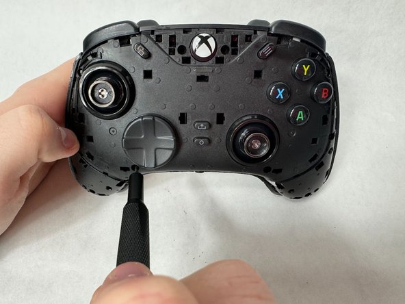

  4. Razer Wolverine V2 Chroma RZ06-0401 Midframe Replacement, Midframe: crwdns2935265:04crwdnd2935265:01crwdnd2935265:02crwdne2935265:0 Razer Wolverine V2 Chroma RZ06-0401 Midframe Replacement, Midframe: crwdns2935265:04crwdnd2935265:02crwdnd2935265:02crwdne2935265:0
    • Remove ten 9 mm screws from the controller using a Phillips #000 screwdriver.

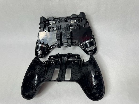

  5. Razer Wolverine V2 Chroma RZ06-0401 Midframe Replacement: crwdns2935265:05crwdnd2935265:01crwdnd2935265:02crwdne2935265:0 Razer Wolverine V2 Chroma RZ06-0401 Midframe Replacement: crwdns2935265:05crwdnd2935265:02crwdnd2935265:02crwdne2935265:0
    • Using an opening tool, pry off the backplate of the controller. It should come off relatively easily.
    • If it is struggling to come off, you might have missed a screw. Make sure you have removed all screws.
