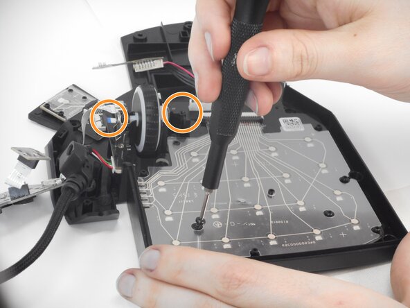

  6. Razer Tartarus V2 Scroll Wheel Replacement: crwdns2935265:06crwdnd2935265:01crwdnd2935265:02crwdne2935265:0 Razer Tartarus V2 Scroll Wheel Replacement: crwdns2935265:06crwdnd2935265:02crwdnd2935265:02crwdne2935265:0
    • Then, remove all five of the black Phillips #0 screws holding the motherboard and bottom casing of keyboard together.
    • Two of these screws are behind or between the objects in the circles.
    • Note: All of the black internal screws are the same length as the external screws but have a smaller head.

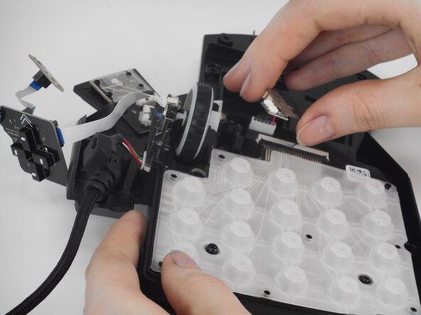

  7. Razer Tartarus V2 Scroll Wheel Replacement: crwdns2935265:07crwdnd2935265:01crwdnd2935265:01crwdne2935265:0
    • Remove the bottom casing, leaving the motherboard attached to the scroll wheel and cord.
  8. Razer Tartarus V2 Scroll Wheel Replacement: crwdns2935265:08crwdnd2935265:01crwdnd2935265:01crwdne2935265:0
    • Gently pull the scroll wheel out of the wheel encoder (small metal part that allows the wheel to move back and forth).
