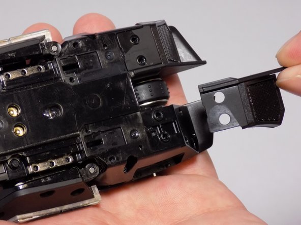

    • Flip the mouse over and remove the stickers on the back of the device. These stickers are hiding the screws we need to remove.
    • Locate and remove the captive screws to remove the hand rest.
  2. Razer Ouroboros Lock Switch Replacement: crwdns2935265:02crwdnd2935265:01crwdnd2935265:02crwdne2935265:0 Razer Ouroboros Lock Switch Replacement: crwdns2935265:02crwdnd2935265:02crwdnd2935265:02crwdne2935265:0
    • Locate and remove the six 4mm screws on the back of the device.
    • Slide the side panels off the back of the mouse.
  3. Razer Ouroboros Lock Switch Replacement: crwdns2935265:03crwdnd2935265:01crwdnd2935265:02crwdne2935265:0 Razer Ouroboros Lock Switch Replacement: crwdns2935265:03crwdnd2935265:02crwdnd2935265:02crwdne2935265:0
    • Using your tweezers, grab the trigger switch that you want to replace, and lift it from its slot.
    • If you have your replacement switch, place it in the newly freed slot and reassemble your device.
    • Note: the top guards of this mouse can come off now that the panel screws have been removed. Make sure these stay in place when reassembling.
