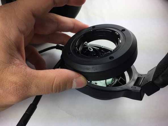

  7. Razer Kraken 7.1 Chroma Microphone Replacement: crwdns2935265:07crwdnd2935265:01crwdnd2935265:03crwdne2935265:0 Razer Kraken 7.1 Chroma Microphone Replacement: crwdns2935265:07crwdnd2935265:02crwdnd2935265:03crwdne2935265:0 Razer Kraken 7.1 Chroma Microphone Replacement: crwdns2935265:07crwdnd2935265:03crwdnd2935265:03crwdne2935265:0
    • Pull the casing upwards to remove it from the headset.
    • If you are removing the casing on the side of the microphone, slide the casing towards you along the length of the microphone until the casing is completely removed.
  8. Razer Kraken 7.1 Chroma Microphone Replacement, Microphone: crwdns2935265:08crwdnd2935265:01crwdnd2935265:02crwdne2935265:0 Razer Kraken 7.1 Chroma Microphone Replacement, Microphone: crwdns2935265:08crwdnd2935265:02crwdnd2935265:02crwdne2935265:0
    • Slide the speaker case laterally along the length of the microphone until the casing is completely detached from the headset.

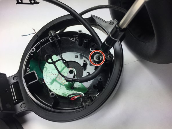

  9. Razer Kraken 7.1 Chroma Microphone Replacement: crwdns2935265:09crwdnd2935265:01crwdnd2935265:03crwdne2935265:0 Razer Kraken 7.1 Chroma Microphone Replacement: crwdns2935265:09crwdnd2935265:02crwdnd2935265:03crwdne2935265:0 Razer Kraken 7.1 Chroma Microphone Replacement: crwdns2935265:09crwdnd2935265:03crwdnd2935265:03crwdne2935265:0
    • Use the Phillips #00 screwdriver to remove the 9 mm screws circled in red.
    • Rotate the screwdriver in a counterclockwise direction to remove each screw.
    • There is a total of four 9mm screws that must be unscrewed.
    • While unscrewing the spinning-wheel apparatus, remove only one wheel to free the microphone cable.
    • When removing the two-screw anchoring piece, slide it off of the broken microphone and make sure to slide the piece back on to the new microphone before soldering.
  10. Razer Kraken 7.1 Chroma Microphone Replacement: crwdns2935265:010crwdnd2935265:01crwdnd2935265:01crwdne2935265:0
    • Pull the microphone out towards you until it is no longer confined within the headset.
