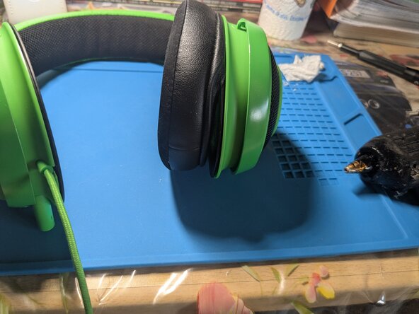

  1. Razer Kraken (Kraken TE) Headband Replacement, Remove ear pads: crwdns2935265:01crwdnd2935265:01crwdnd2935265:03crwdne2935265:0 Razer Kraken (Kraken TE) Headband Replacement, Remove ear pads: crwdns2935265:01crwdnd2935265:02crwdnd2935265:03crwdne2935265:0 Razer Kraken (Kraken TE) Headband Replacement, Remove ear pads: crwdns2935265:01crwdnd2935265:03crwdnd2935265:03crwdne2935265:0

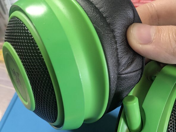

    • Remove the right ear pad.
    • Insert your index finger inside the crease between the cushion and the inner fabric and pull slightly outward.
    • Bring out the entire contour of the pad.
    • The pad may have lost elasticity, and pulling too hard could ruin the leatherette of the pad itself.
    • Removing the left pad is convenient for working but not mandatory.

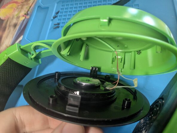

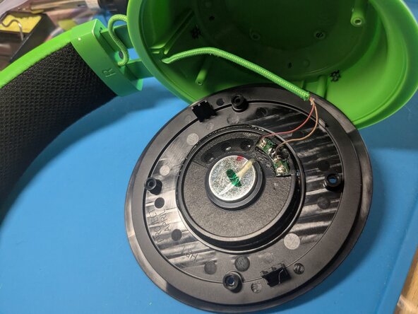

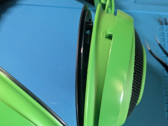

  2. Razer Kraken (Kraken TE) Headband Replacement, Open the right ear cup: crwdns2935265:02crwdnd2935265:01crwdnd2935265:03crwdne2935265:0 Razer Kraken (Kraken TE) Headband Replacement, Open the right ear cup: crwdns2935265:02crwdnd2935265:02crwdnd2935265:03crwdne2935265:0 Razer Kraken (Kraken TE) Headband Replacement, Open the right ear cup: crwdns2935265:02crwdnd2935265:03crwdnd2935265:03crwdne2935265:0
    • Unscrew the four screws.
    • Gently lift the black cover.
    • Be careful not to tear the cables.

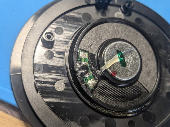

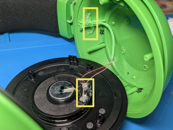

  3. Razer Kraken (Kraken TE) Headband Replacement, Prepare to desolder: crwdns2935265:03crwdnd2935265:01crwdnd2935265:02crwdne2935265:0 Razer Kraken (Kraken TE) Headband Replacement, Prepare to desolder: crwdns2935265:03crwdnd2935265:02crwdnd2935265:02crwdne2935265:0
    • Remove the hot glue from the connectors.
    • Help yourself with the metal spudger and precision tweezers.
    • Remember how the wires are soldered.

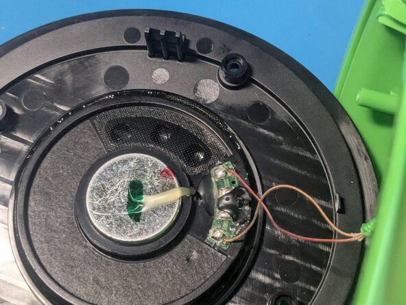

  4. Razer Kraken (Kraken TE) Headband Replacement, Desolder the right driver: crwdns2935265:04crwdnd2935265:01crwdnd2935265:02crwdne2935265:0 Razer Kraken (Kraken TE) Headband Replacement, Desolder the right driver: crwdns2935265:04crwdnd2935265:02crwdnd2935265:02crwdne2935265:0
    • Desolder the two audio cables.
    • Put a few drops of flux over the tin of each solder.
    • Melt the tin with the soldering iron tip set at 320-350 degrees Celsius.
    • The tin should melt easily, freeing the cable.
    • Do not leave the tip of the soldering iron for more than 4-5 seconds continuously over the pad and do not raise the temperature too high, you may ruin the circuit board.
    • Clean the pitches.
    • Pass with the desoldering braid over the remaining tin, resting the soldering iron tip on top.
    • You can add a little more flux or use a tin remover pump.

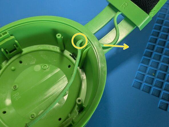

  5. Razer Kraken (Kraken TE) Headband Replacement, Free the right audio cable: crwdns2935265:05crwdnd2935265:01crwdnd2935265:02crwdne2935265:0 Razer Kraken (Kraken TE) Headband Replacement, Free the right audio cable: crwdns2935265:05crwdnd2935265:02crwdnd2935265:02crwdne2935265:0
    • Remove the hot glue from the cable.
    • Pull the cable out of the earcup by running it through the hole.

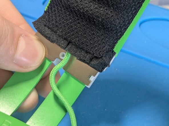

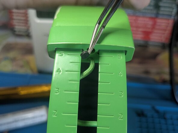

  6. Razer Kraken (Kraken TE) Headband Replacement, Remove the metal cover: crwdns2935265:06crwdnd2935265:01crwdnd2935265:03crwdne2935265:0 Razer Kraken (Kraken TE) Headband Replacement, Remove the metal cover: crwdns2935265:06crwdnd2935265:02crwdnd2935265:03crwdne2935265:0 Razer Kraken (Kraken TE) Headband Replacement, Remove the metal cover: crwdns2935265:06crwdnd2935265:03crwdnd2935265:03crwdne2935265:0

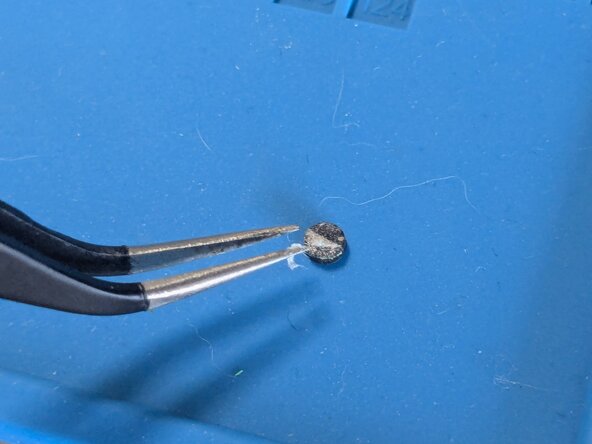

    • Remove the rubber screw cover.
    • You can use the precision tweesers.
    • Unscrew the single screw.
    • Simply pull down the metal cover.
    • Be careful passing the cable through the metal.

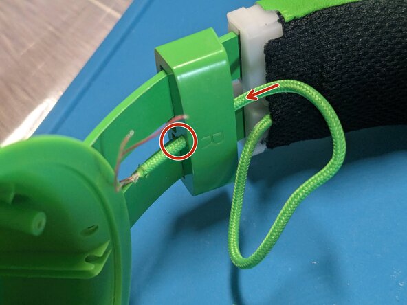

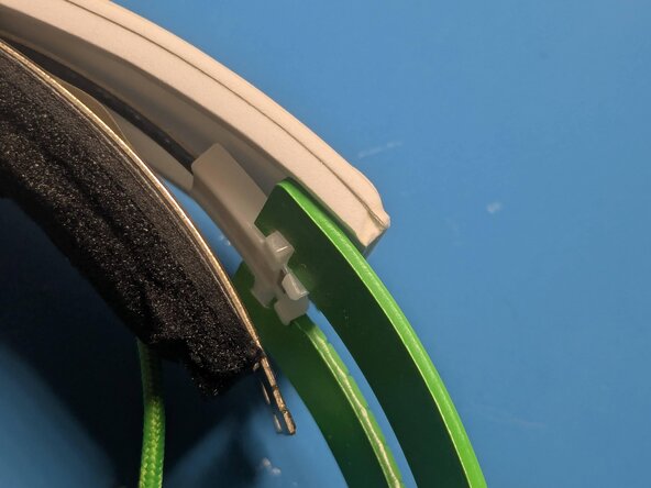

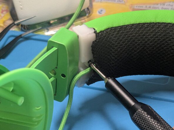

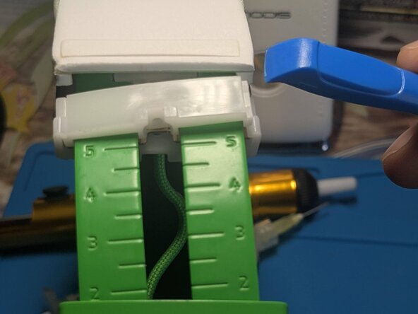

  8. Razer Kraken (Kraken TE) Headband Replacement, Unlock the right rod: crwdns2935265:09crwdnd2935265:01crwdnd2935265:03crwdne2935265:0 Razer Kraken (Kraken TE) Headband Replacement, Unlock the right rod: crwdns2935265:09crwdnd2935265:02crwdnd2935265:03crwdne2935265:0 Razer Kraken (Kraken TE) Headband Replacement, Unlock the right rod: crwdns2935265:09crwdnd2935265:03crwdnd2935265:03crwdne2935265:0

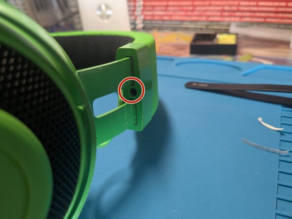

    • Free the cable.

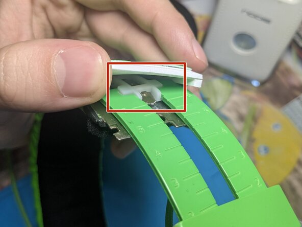

    • Push in one end of the plastic clip to pop it open.
    • Use an opening tool for help.

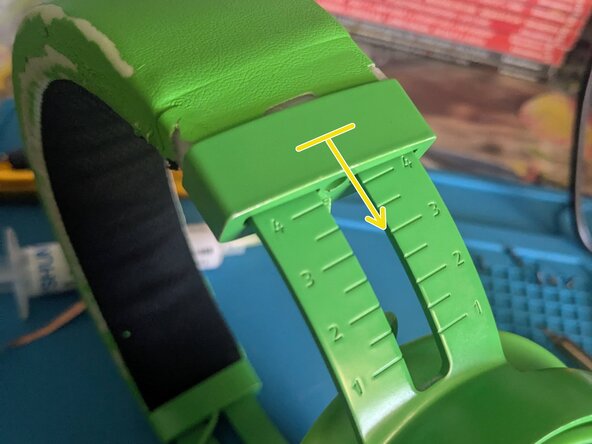

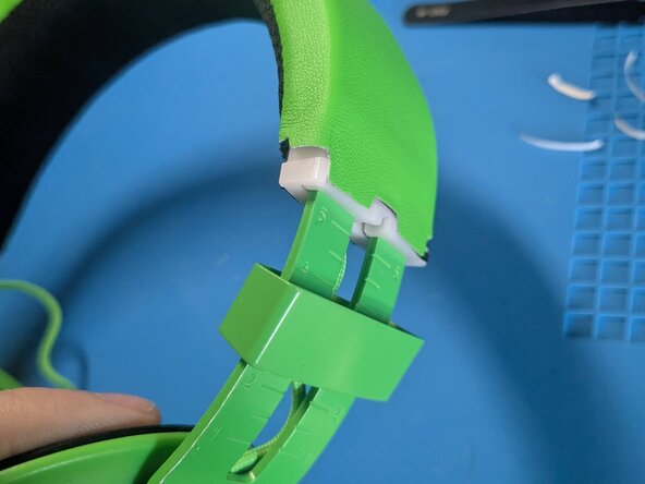

  9. Razer Kraken (Kraken TE) Headband Replacement, Remove the right ear cup: crwdns2935265:010crwdnd2935265:01crwdnd2935265:03crwdne2935265:0 Razer Kraken (Kraken TE) Headband Replacement, Remove the right ear cup: crwdns2935265:010crwdnd2935265:02crwdnd2935265:03crwdne2935265:0 Razer Kraken (Kraken TE) Headband Replacement, Remove the right ear cup: crwdns2935265:010crwdnd2935265:03crwdnd2935265:03crwdne2935265:0
    • Free the cable by passing it through the hole in the metal cover.
    • Slightly separate the upper cushion from the metal headband.
    • Simply pull down on the right earcup; the adjustable rod should come out of the metal rail naturally, freeing it completely from the rest of the headset.

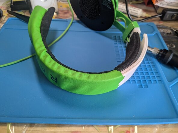

  10. Razer Kraken (Kraken TE) Headband Replacement, Remove the leatherette headband: crwdns2935265:011crwdnd2935265:01crwdnd2935265:02crwdne2935265:0 Razer Kraken (Kraken TE) Headband Replacement, Remove the leatherette headband: crwdns2935265:011crwdnd2935265:02crwdnd2935265:02crwdne2935265:0
    • Slowly pull and push the headband toward the right side so that it comes out.
  11. Razer Kraken (Kraken TE) Headband Replacement, Clean the mess: crwdns2935265:012crwdnd2935265:01crwdnd2935265:01crwdne2935265:0
    • We know you are going to need it.

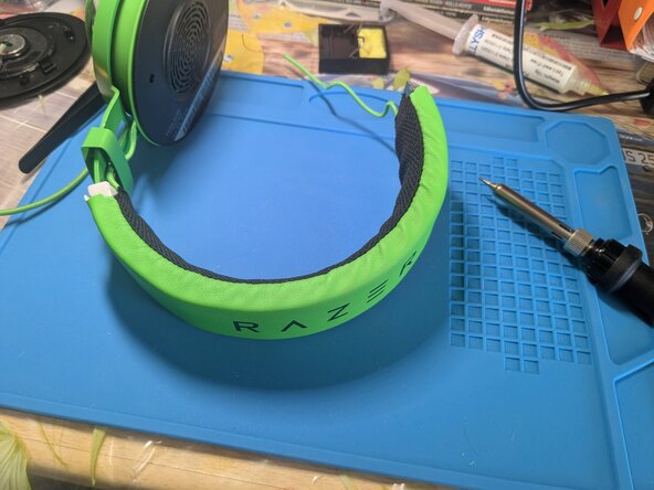

  12. Razer Kraken (Kraken TE) Headband Replacement, Insert the new leatherette: crwdns2935265:013crwdnd2935265:01crwdnd2935265:03crwdne2935265:0 Razer Kraken (Kraken TE) Headband Replacement, Insert the new leatherette: crwdns2935265:013crwdnd2935265:02crwdnd2935265:03crwdne2935265:0 Razer Kraken (Kraken TE) Headband Replacement, Insert the new leatherette: crwdns2935265:013crwdnd2935265:03crwdnd2935265:03crwdne2935265:0
    • Very slowly and with much patience, start pulling the new leatherette around the metal bow and cushions starting from the right side.
    • Looking at the headset from above, placing the left side to the left and the right side to the right, the Razer lettering will line up straight.
    • Halfway through the process, you will also be forced to push from the right side and pull from the left. Always in small movements.

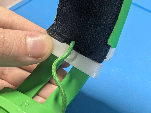

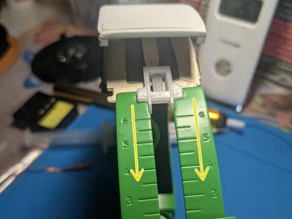

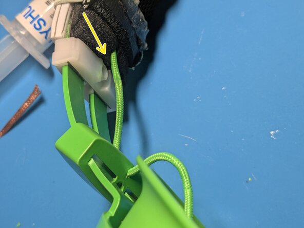

  14. Razer Kraken (Kraken TE) Headband Replacement, Start locking the adjustable rod: crwdns2935265:015crwdnd2935265:01crwdnd2935265:03crwdne2935265:0 Razer Kraken (Kraken TE) Headband Replacement, Start locking the adjustable rod: crwdns2935265:015crwdnd2935265:02crwdnd2935265:03crwdne2935265:0 Razer Kraken (Kraken TE) Headband Replacement, Start locking the adjustable rod: crwdns2935265:015crwdnd2935265:03crwdnd2935265:03crwdne2935265:0
    • Follow the images to place back the plastic clip.
  15. Razer Kraken (Kraken TE) Headband Replacement, Lock the right rod: crwdns2935265:016crwdnd2935265:01crwdnd2935265:03crwdne2935265:0 Razer Kraken (Kraken TE) Headband Replacement, Lock the right rod: crwdns2935265:016crwdnd2935265:02crwdnd2935265:03crwdne2935265:0 Razer Kraken (Kraken TE) Headband Replacement, Lock the right rod: crwdns2935265:016crwdnd2935265:03crwdnd2935265:03crwdne2935265:0
    • Close the clip.
    • Screw the single screw.
    • The cable must be outside the clip.
    • Pass the cable through the metal cover.

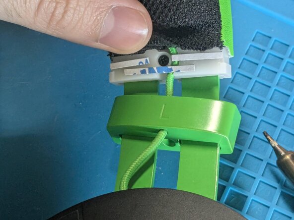

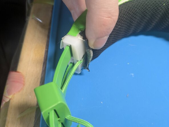

  16. Razer Kraken (Kraken TE) Headband Replacement, Apply new double sided tape: crwdns2935265:017crwdnd2935265:01crwdnd2935265:03crwdne2935265:0 Razer Kraken (Kraken TE) Headband Replacement, Apply new double sided tape: crwdns2935265:017crwdnd2935265:02crwdnd2935265:03crwdne2935265:0 Razer Kraken (Kraken TE) Headband Replacement, Apply new double sided tape: crwdns2935265:017crwdnd2935265:03crwdnd2935265:03crwdne2935265:0
    • Apply new tape in the front and the back of the plastic clip (not the sides).
    • Make sure the cable is placed properly along its plastic guide.
    • Make sure the cable is passing through the metal cover.
    • Make sure the leatherette is tightly stretched and well placed.
    • Stick the new leatherette to the new tape.

  19. Razer Kraken (Kraken TE) Headband Replacement, Solder driver: crwdns2935265:020crwdnd2935265:01crwdnd2935265:03crwdne2935265:0 Razer Kraken (Kraken TE) Headband Replacement, Solder driver: crwdns2935265:020crwdnd2935265:02crwdnd2935265:03crwdne2935265:0 Razer Kraken (Kraken TE) Headband Replacement, Solder driver: crwdns2935265:020crwdnd2935265:03crwdnd2935265:03crwdne2935265:0
    • Pass the cable through the ear cup hole.
    • Solder back the audio driver.
    • Put a drop of tin on the tip of each cable and on each pad.
    • Dissolve the two tin drops together (cable-pad).
    • Make sure you are not shorting and that you have connected the wires in the original order.
    • Put some hot glue to reinforce the welds and prevent the cable from tearing.

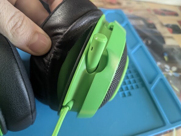

  20. Razer Kraken (Kraken TE) Headband Replacement, Finish the job: crwdns2935265:021crwdnd2935265:01crwdnd2935265:03crwdne2935265:0 Razer Kraken (Kraken TE) Headband Replacement, Finish the job: crwdns2935265:021crwdnd2935265:02crwdnd2935265:03crwdne2935265:0 Razer Kraken (Kraken TE) Headband Replacement, Finish the job: crwdns2935265:021crwdnd2935265:03crwdnd2935265:03crwdne2935265:0
    • Close the ear cup and screw the four screws.
    • Slowly put back the ear pad(s).

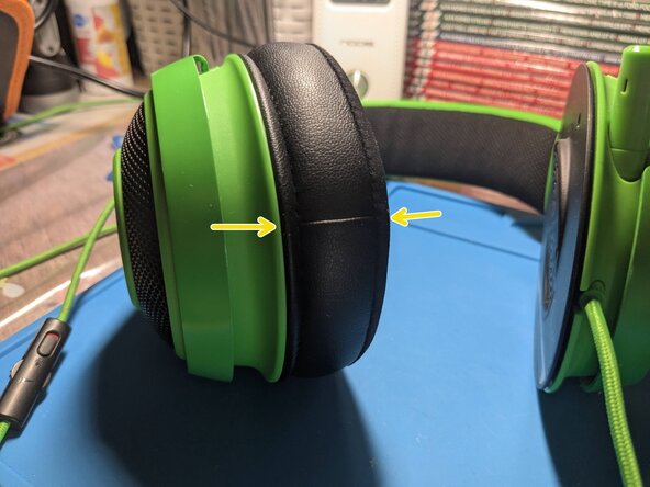

    • Insert the outline of the pad starting from the side and push slightly toward the other directions to stretch the cushion a bit.
    • The seam of the cushion is facing downward.
