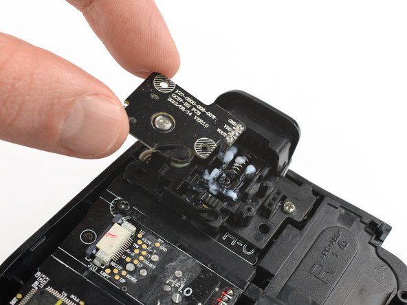

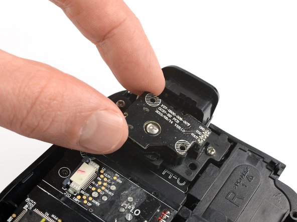

  7. Razer Kishi Trigger Replacement, Remove the screws: crwdns2935265:07crwdnd2935265:01crwdnd2935265:01crwdne2935265:0
    • Use a Phillips #0 screwdriver to remove the two 4.4 mm-long screws securing the trigger board.
  8. Razer Kishi Trigger Replacement, Remove the breakout board: crwdns2935265:08crwdnd2935265:01crwdnd2935265:03crwdne2935265:0 Razer Kishi Trigger Replacement, Remove the breakout board: crwdns2935265:08crwdnd2935265:02crwdnd2935265:03crwdne2935265:0 Razer Kishi Trigger Replacement, Remove the breakout board: crwdns2935265:08crwdnd2935265:03crwdnd2935265:03crwdne2935265:0
    • The breakout board is plugged in. When removing breakout board, it is important to pull it straight out to avoid bending the connectors.
    • Remove the breakout board by lifting it straight up, away from the controller.

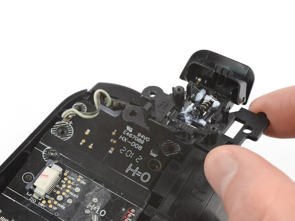

  9. Razer Kishi Trigger Replacement, Remove the screws: crwdns2935265:09crwdnd2935265:01crwdnd2935265:01crwdne2935265:0
    • Use a Phillips #0 screwdriver to remove the two 7.0 mm-long screws securing the trigger.
  10. Razer Kishi Trigger Replacement, Remove the trigger: crwdns2935265:010crwdnd2935265:01crwdnd2935265:02crwdne2935265:0 Razer Kishi Trigger Replacement, Remove the trigger: crwdns2935265:010crwdnd2935265:02crwdnd2935265:02crwdne2935265:0
    • Remove the shoulder trigger.

During reassembly, when snapping the outer shell together test the R2 button. If it won't move it's likely because the tab on the end got pushed to the outside of the case. Pop it back open and push the R2 button in as you snap it back together in that area.
