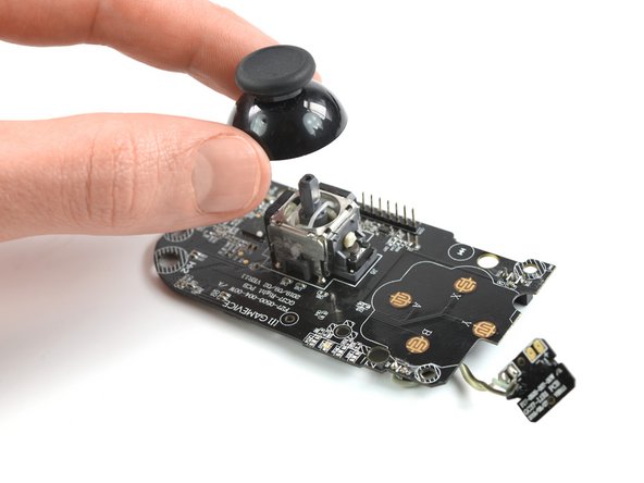

  14. Razer Kishi Thumbstick Replacement, Remove the thumbstick: crwdns2935265:014crwdnd2935265:01crwdnd2935265:02crwdne2935265:0 Razer Kishi Thumbstick Replacement, Remove the thumbstick: crwdns2935265:014crwdnd2935265:02crwdnd2935265:02crwdne2935265:0
    • Remove the thumbstick by pulling away from the board.

Could anyone provide the link to buy that thumbstick?
Terry - crwdns2934203:0crwdne2934203:0
I second the previous comment. Where can you buy these thumbsticks?
Matthew Miller - crwdns2934203:0crwdne2934203:0
Has anyone had any luck buying the thumbstick for this
Kurt Kedroe - crwdns2934203:0crwdne2934203:0
tbh, the replacement is pretty straightforward if you've ever done anything like this. The problem is (like everybody above me said) it's hard to find the appropriate replacement thumbstick, as regular thumbsticks don't work! I've tried ps4, Xbox one, 360, original Xbox, switch pro... And to be clear, a lot of these will fit onto the metal rod, but once you close it up there isn't enough clearance for the joystick to move. Kishi's thumbstick is a unique profile that may as well be proprietary.
Regardless, if I find a solution, I will share it with ya'll :)
Derek Wing - crwdns2934203:0crwdne2934203:0
Have you ever find a solution for that? I'm having the same problem.
