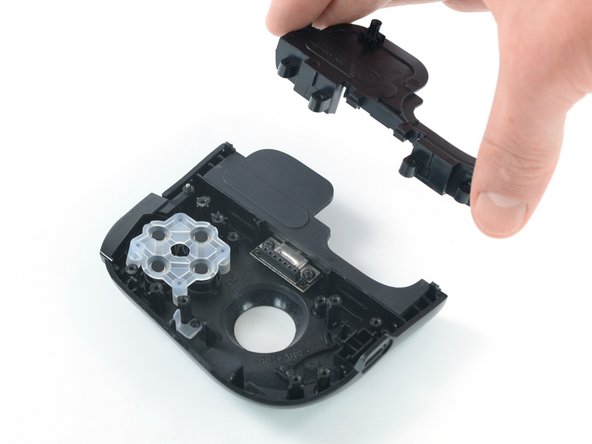

  12. Razer Kishi Phone Connector Replacement, Remove the screws: crwdns2935265:012crwdnd2935265:01crwdnd2935265:01crwdne2935265:0
    • Use a Phillips #0 screwdriver to remove the two 5.9 mm-long screws.
  13. Razer Kishi Phone Connector Replacement, Remove the board: crwdns2935265:013crwdnd2935265:01crwdnd2935265:02crwdne2935265:0 Razer Kishi Phone Connector Replacement, Remove the board: crwdns2935265:013crwdnd2935265:02crwdnd2935265:02crwdne2935265:0
    • Pull the mainboard straight out of the frame to remove it.

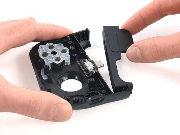

  14. Razer Kishi Phone Connector Replacement, Unfasten screws: crwdns2935265:014crwdnd2935265:01crwdnd2935265:01crwdne2935265:0
    • Use a Phillips #00 screwdriver to remove the four 5.7 mm screws securing the phone bracket.
  15. Razer Kishi Phone Connector Replacement, Remove the phone bracket: crwdns2935265:015crwdnd2935265:01crwdnd2935265:02crwdne2935265:0 Razer Kishi Phone Connector Replacement, Remove the phone bracket: crwdns2935265:015crwdnd2935265:02crwdnd2935265:02crwdne2935265:0
    • Remove the phone bracket.
  16. Razer Kishi Phone Connector Replacement, Remove the rubber phone pad: crwdns2935265:016crwdnd2935265:01crwdnd2935265:02crwdne2935265:0 Razer Kishi Phone Connector Replacement, Remove the rubber phone pad: crwdns2935265:016crwdnd2935265:02crwdnd2935265:02crwdne2935265:0
    • Use your fingers to lift the rubber phone pad out sideways.

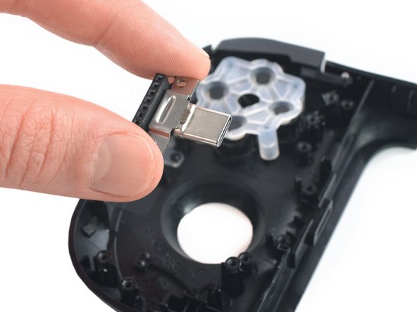

  17. Razer Kishi Phone Connector Replacement, Unfasten the screws: crwdns2935265:017crwdnd2935265:01crwdnd2935265:01crwdne2935265:0
    • Use a Phillips #00 screwdriver to remove the two 4.6 mm screws securing the phone connector.
  18. Razer Kishi Phone Connector Replacement: crwdns2935265:018crwdnd2935265:01crwdnd2935265:03crwdne2935265:0 Razer Kishi Phone Connector Replacement: crwdns2935265:018crwdnd2935265:02crwdnd2935265:03crwdne2935265:0 Razer Kishi Phone Connector Replacement: crwdns2935265:018crwdnd2935265:03crwdnd2935265:03crwdne2935265:0
    • Thread the phone connector through its opening in the side of the controller.
    • Remove the phone connector.
