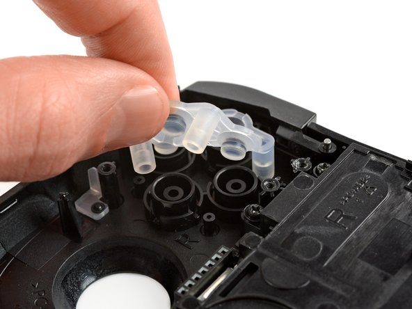

  14. Razer Kishi Face Buttons Replacement, Pull off the rubber cover: crwdns2935265:014crwdnd2935265:01crwdnd2935265:03crwdne2935265:0 Razer Kishi Face Buttons Replacement, Pull off the rubber cover: crwdns2935265:014crwdnd2935265:02crwdnd2935265:03crwdne2935265:0 Razer Kishi Face Buttons Replacement, Pull off the rubber cover: crwdns2935265:014crwdnd2935265:03crwdnd2935265:03crwdne2935265:0
    • Remove the rubber cover by pulling it upwards.

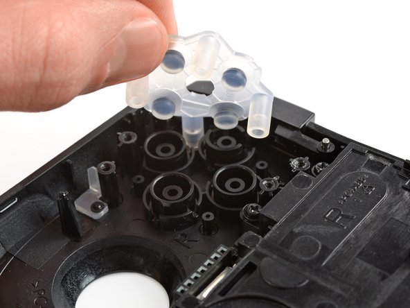

  15. Razer Kishi Face Buttons Replacement, Remove the face buttons: crwdns2935265:015crwdnd2935265:01crwdnd2935265:02crwdne2935265:0 Razer Kishi Face Buttons Replacement, Remove the face buttons: crwdns2935265:015crwdnd2935265:02crwdnd2935265:02crwdne2935265:0
    • Use a pair of tweezers to remove the face buttons.
