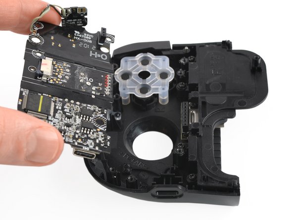

  5. Razer Kishi Direction Pad Replacement: crwdns2935265:05crwdnd2935265:01crwdnd2935265:03crwdne2935265:0 Razer Kishi Direction Pad Replacement: crwdns2935265:05crwdnd2935265:02crwdnd2935265:03crwdne2935265:0 Razer Kishi Direction Pad Replacement: crwdns2935265:05crwdnd2935265:03crwdnd2935265:03crwdne2935265:0
    • Carefully lift the top side and unfold it to the right, like a book.

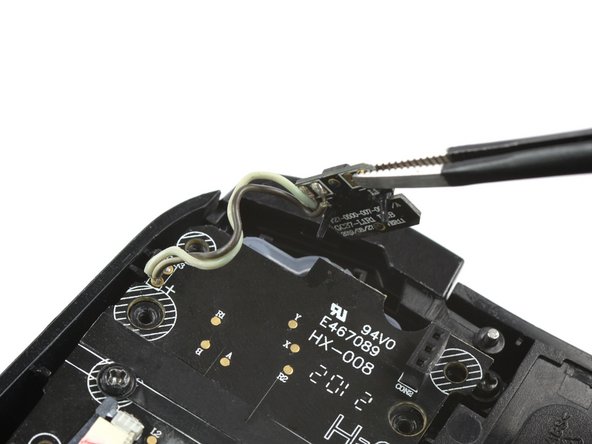

  6. Razer Kishi Direction Pad Replacement, Disconnect the interconnect cable: crwdns2935265:06crwdnd2935265:01crwdnd2935265:03crwdne2935265:0 Razer Kishi Direction Pad Replacement, Disconnect the interconnect cable: crwdns2935265:06crwdnd2935265:02crwdnd2935265:03crwdne2935265:0 Razer Kishi Direction Pad Replacement, Disconnect the interconnect cable: crwdns2935265:06crwdnd2935265:03crwdnd2935265:03crwdne2935265:0
    • Using the pointed end of a spudger, push the grey tabs on the interconnect socket away from the socket, parallel to the interconnect cable, to release the cable.
    • Pull the cable out of the socket.

  13. Razer Kishi Direction Pad Replacement, Remove the board: crwdns2935265:013crwdnd2935265:01crwdnd2935265:02crwdne2935265:0 Razer Kishi Direction Pad Replacement, Remove the board: crwdns2935265:013crwdnd2935265:02crwdnd2935265:02crwdne2935265:0
    • Pull the mainboard straight out of the frame to remove it.

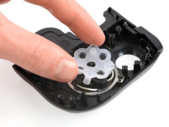

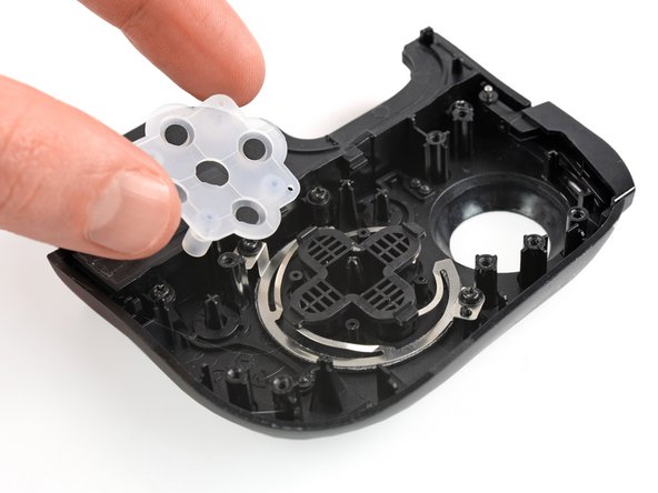

  14. Razer Kishi Direction Pad Replacement, Remove the rubber cover: crwdns2935265:014crwdnd2935265:01crwdnd2935265:03crwdne2935265:0 Razer Kishi Direction Pad Replacement, Remove the rubber cover: crwdns2935265:014crwdnd2935265:02crwdnd2935265:03crwdne2935265:0 Razer Kishi Direction Pad Replacement, Remove the rubber cover: crwdns2935265:014crwdnd2935265:03crwdnd2935265:03crwdne2935265:0
    • Remove the rubber cover that is attached on top of the direction pad.

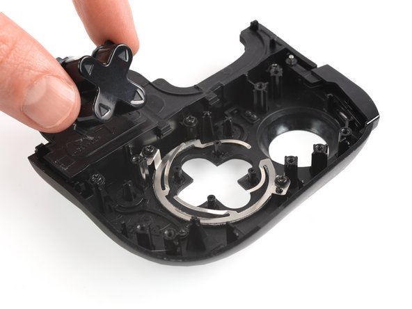

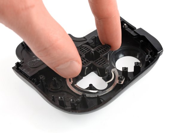

  15. Razer Kishi Direction Pad Replacement, Remove the direction pad: crwdns2935265:015crwdnd2935265:01crwdnd2935265:03crwdne2935265:0 Razer Kishi Direction Pad Replacement, Remove the direction pad: crwdns2935265:015crwdnd2935265:02crwdnd2935265:03crwdne2935265:0 Razer Kishi Direction Pad Replacement, Remove the direction pad: crwdns2935265:015crwdnd2935265:03crwdnd2935265:03crwdne2935265:0
    • Remove the direction pad.
