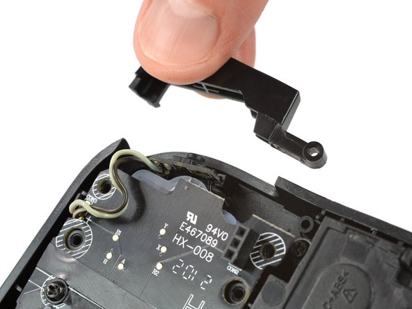

  10. Razer Kishi Bumper Replacement, Remove the trigger: crwdns2935265:010crwdnd2935265:01crwdnd2935265:02crwdne2935265:0 Razer Kishi Bumper Replacement, Remove the trigger: crwdns2935265:010crwdnd2935265:02crwdnd2935265:02crwdne2935265:0
    • Remove the shoulder trigger.

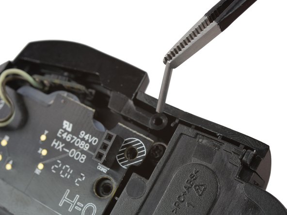

  11. Razer Kishi Bumper Replacement, Remove the metal pin: crwdns2935265:011crwdnd2935265:01crwdnd2935265:02crwdne2935265:0 Razer Kishi Bumper Replacement, Remove the metal pin: crwdns2935265:011crwdnd2935265:02crwdnd2935265:02crwdne2935265:0
    • Use a pair of tweezers to remove the metal pin which holds the bumper in its place.
