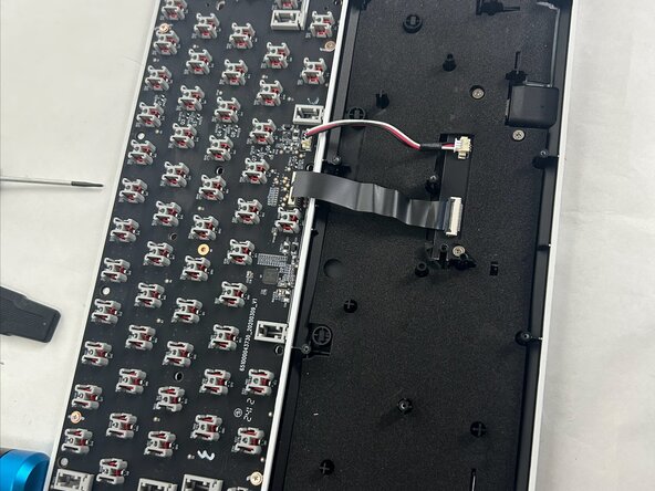

    • Remove all of the Phillips screws that secure the keyboard casings.
    • Ignore the photo markup; many more screws need to be removed than indicated.
  3. Razer Huntsman Mini I/O Board Replacement: crwdns2935265:03crwdnd2935265:01crwdnd2935265:02crwdne2935265:0 Razer Huntsman Mini I/O Board Replacement: crwdns2935265:03crwdnd2935265:02crwdnd2935265:02crwdne2935265:0
    • Lift off the top case, with care not to strain the connected cables.

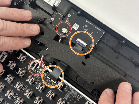

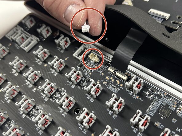

  4. Razer Huntsman Mini I/O Board Replacement: crwdns2935265:04crwdnd2935265:01crwdnd2935265:02crwdne2935265:0 Razer Huntsman Mini I/O Board Replacement: crwdns2935265:04crwdnd2935265:02crwdnd2935265:02crwdne2935265:0
    • Grip and pull the white connectors directly out of their sockets.
    • Flip up the black ZIF locking flaps. Disconnect the ribbon cable.

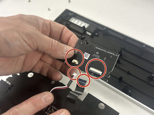

  5. Razer Huntsman Mini I/O Board Replacement: crwdns2935265:05crwdnd2935265:01crwdnd2935265:01crwdne2935265:0
    • Remove the I/O board.
