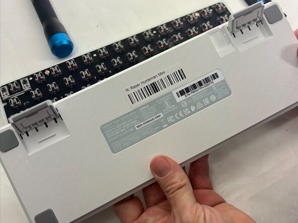

    • Turn off an unplug.
    • Flip the device to the back panel exposing screws or clips that attach the legs. Usually located near the corners or central support area.

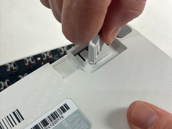

    • The base model has clips on both sides of the legs securing it in place.
    • Carefully lift and slide out the broken leg.
    • If the leg is stuck use a plastic pry tool around the edges to loosen it.
    • Avoid using excessive force to prevent damaging nearby parts.
