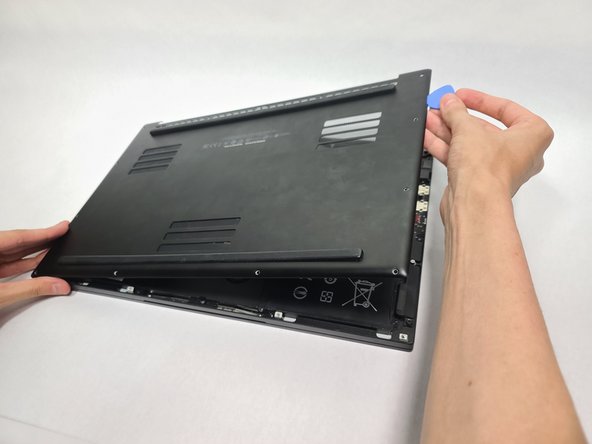

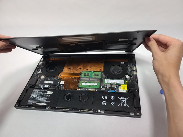

    • Remove the 12 screws that secure the lower case with a T5 Torx screwdriver.
  3. Razer Blade Pro 17 2019 Battery Replacement: crwdns2935265:03crwdnd2935265:01crwdnd2935265:03crwdne2935265:0 Razer Blade Pro 17 2019 Battery Replacement: crwdns2935265:03crwdnd2935265:02crwdnd2935265:03crwdne2935265:0 Razer Blade Pro 17 2019 Battery Replacement: crwdns2935265:03crwdnd2935265:03crwdnd2935265:03crwdne2935265:0
    • Insert the opening picks into the gap between the back plate and the body of the laptop and pry around the perimeter until the lower case releases.
    • It is easier to use the gap at the ethernet port.
    • Lift up and remove the lower case.
    • Be careful not to place anything on the back to avoid scratching any components.

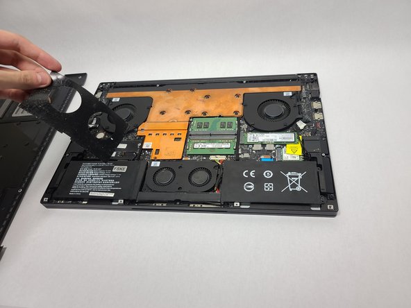

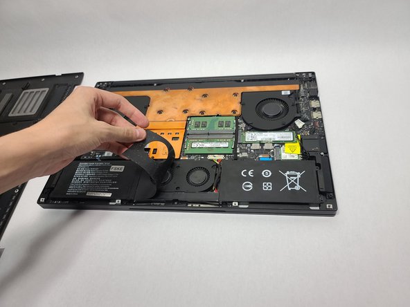

  4. Razer Blade Pro 17 2019 Battery Replacement: crwdns2935265:04crwdnd2935265:01crwdnd2935265:03crwdne2935265:0 Razer Blade Pro 17 2019 Battery Replacement: crwdns2935265:04crwdnd2935265:02crwdnd2935265:03crwdne2935265:0 Razer Blade Pro 17 2019 Battery Replacement: crwdns2935265:04crwdnd2935265:03crwdnd2935265:03crwdne2935265:0
    • Remove the black sticker on the fan assembly.

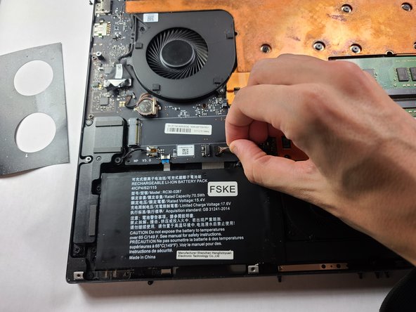

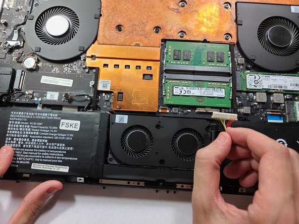

  5. Razer Blade Pro 17 2019 Battery Replacement: crwdns2935265:05crwdnd2935265:01crwdnd2935265:02crwdne2935265:0 Razer Blade Pro 17 2019 Battery Replacement: crwdns2935265:05crwdnd2935265:02crwdnd2935265:02crwdne2935265:0
    • Use your fingernails to gently "walk" the battery connector directly out of its port.
    • Do not pull directly on the wires, as depicted in the photo.

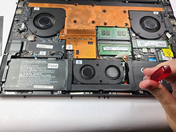

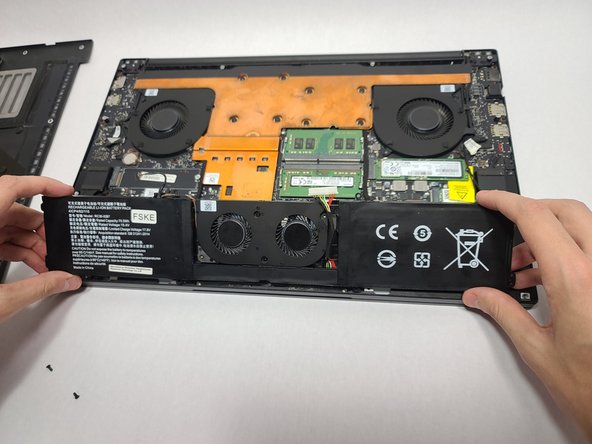

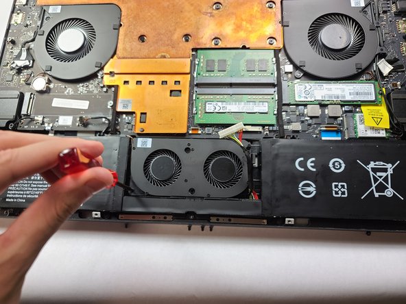

  7. Razer Blade Pro 17 2019 Battery Replacement: crwdns2935265:07crwdnd2935265:01crwdnd2935265:03crwdne2935265:0 Razer Blade Pro 17 2019 Battery Replacement: crwdns2935265:07crwdnd2935265:02crwdnd2935265:03crwdne2935265:0 Razer Blade Pro 17 2019 Battery Replacement: crwdns2935265:07crwdnd2935265:03crwdnd2935265:03crwdne2935265:0
    • Use a Phillips #1 screwdriver to remove the 10 screws that secure the battery and fan assembly.

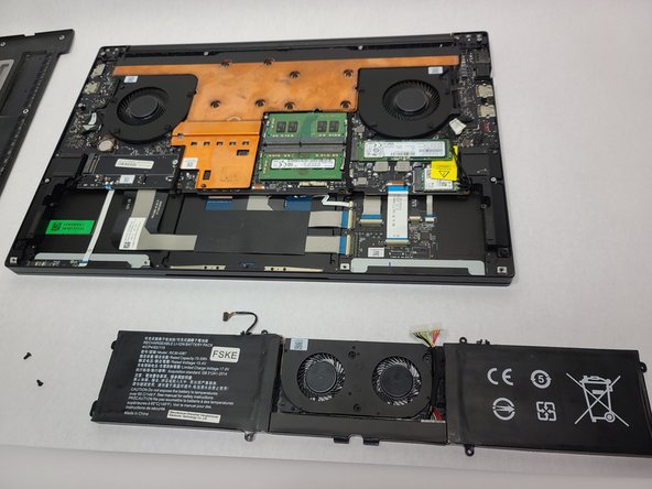

  8. Razer Blade Pro 17 2019 Battery Replacement: crwdns2935265:08crwdnd2935265:01crwdnd2935265:03crwdne2935265:0 Razer Blade Pro 17 2019 Battery Replacement: crwdns2935265:08crwdnd2935265:02crwdnd2935265:03crwdne2935265:0 Razer Blade Pro 17 2019 Battery Replacement: crwdns2935265:08crwdnd2935265:03crwdnd2935265:03crwdne2935265:0
    • Lift the fan assembly and battery out of the chassis.
For optimal performance, calibrate your newly installed battery after completing this guide.
