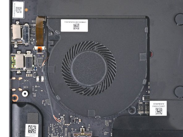

  9. Razer Blade 15 Advanced Model (Early 2020) Right Fan Replacement, Disconnect the right fan cable: crwdns2935265:09crwdnd2935265:01crwdnd2935265:03crwdne2935265:0 Razer Blade 15 Advanced Model (Early 2020) Right Fan Replacement, Disconnect the right fan cable: crwdns2935265:09crwdnd2935265:02crwdnd2935265:03crwdne2935265:0 Razer Blade 15 Advanced Model (Early 2020) Right Fan Replacement, Disconnect the right fan cable: crwdns2935265:09crwdnd2935265:03crwdnd2935265:03crwdne2935265:0
    • The right fan will be on your left-hand side when working on the laptop, as it's laying upside down.
    • Push on alternating sides of the right fan cable connector with the tip of a spudger to "walk" it out of its socket.
  10. Razer Blade 15 Advanced Model (Early 2020) Right Fan Replacement, Unfasten the right fan: crwdns2935265:010crwdnd2935265:01crwdnd2935265:02crwdne2935265:0 Razer Blade 15 Advanced Model (Early 2020) Right Fan Replacement, Unfasten the right fan: crwdns2935265:010crwdnd2935265:02crwdnd2935265:02crwdne2935265:0
    • Use a Phillips screwdriver to remove the two 5.3 mm‑long screws securing the right fan.
    • The fan screws may be covered with stickers. Pierce through them with your screwdriver or use tweezers to remove them.
  11. Razer Blade 15 Advanced Model (Early 2020) Right Fan Replacement, Remove the right fan: crwdns2935265:011crwdnd2935265:01crwdnd2935265:02crwdne2935265:0 Razer Blade 15 Advanced Model (Early 2020) Right Fan Replacement, Remove the right fan: crwdns2935265:011crwdnd2935265:02crwdnd2935265:02crwdne2935265:0
    • Remove the right fan.
