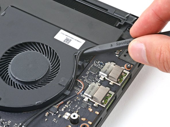

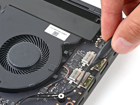

  9. Razer Blade 15 Advanced Model (Early 2020) Left Fan Replacement, Reposition the cables: crwdns2935265:09crwdnd2935265:01crwdnd2935265:03crwdne2935265:0 Razer Blade 15 Advanced Model (Early 2020) Left Fan Replacement, Reposition the cables: crwdns2935265:09crwdnd2935265:02crwdnd2935265:03crwdne2935265:0 Razer Blade 15 Advanced Model (Early 2020) Left Fan Replacement, Reposition the cables: crwdns2935265:09crwdnd2935265:03crwdnd2935265:03crwdne2935265:0
    • The left fan will be on your right-hand side when working on the laptop, as it's laying upside down.
    • Use a spudger or your fingers to guide the Wi‑Fi card cables out of their clip on the top right corner of the fan.
    • Move the cables toward the right edge of the laptop and out of the way of the fan.

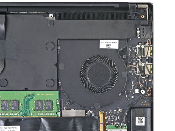

  10. Razer Blade 15 Advanced Model (Early 2020) Left Fan Replacement, Disconnect the left fan: crwdns2935265:010crwdnd2935265:01crwdnd2935265:03crwdne2935265:0 Razer Blade 15 Advanced Model (Early 2020) Left Fan Replacement, Disconnect the left fan: crwdns2935265:010crwdnd2935265:02crwdnd2935265:03crwdne2935265:0 Razer Blade 15 Advanced Model (Early 2020) Left Fan Replacement, Disconnect the left fan: crwdns2935265:010crwdnd2935265:03crwdnd2935265:03crwdne2935265:0
  11. Razer Blade 15 Advanced Model (Early 2020) Left Fan Replacement, Unfasten the left fan: crwdns2935265:011crwdnd2935265:01crwdnd2935265:02crwdne2935265:0 Razer Blade 15 Advanced Model (Early 2020) Left Fan Replacement, Unfasten the left fan: crwdns2935265:011crwdnd2935265:02crwdnd2935265:02crwdne2935265:0
    • Use a Phillips screwdriver to remove the two 5.3 mm‑long screws securing the left fan.
    • The fan screws may be covered with stickers. Pierce through them with your screwdriver or use tweezers to remove them.

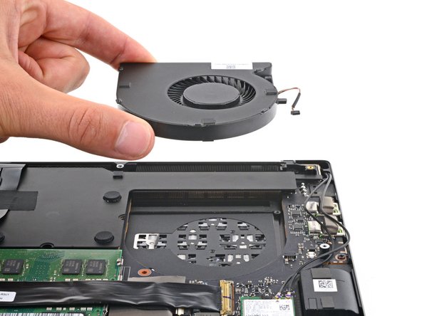

  12. Razer Blade 15 Advanced Model (Early 2020) Left Fan Replacement, Remove the fan: crwdns2935265:012crwdnd2935265:01crwdnd2935265:02crwdne2935265:0 Razer Blade 15 Advanced Model (Early 2020) Left Fan Replacement, Remove the fan: crwdns2935265:012crwdnd2935265:02crwdnd2935265:02crwdne2935265:0
    • Remove the left fan.
