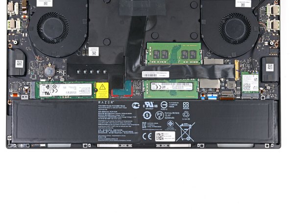

  8. Razer Blade 15 Advanced Model (Early 2020) Battery Replacement, Disconnect the battery: crwdns2935265:08crwdnd2935265:01crwdnd2935265:03crwdne2935265:0 Razer Blade 15 Advanced Model (Early 2020) Battery Replacement, Disconnect the battery: crwdns2935265:08crwdnd2935265:02crwdnd2935265:03crwdne2935265:0 Razer Blade 15 Advanced Model (Early 2020) Battery Replacement, Disconnect the battery: crwdns2935265:08crwdnd2935265:03crwdnd2935265:03crwdne2935265:0
    • Insert the point of a spudger under the middle of the battery connector's long edge.
    • Lift and disconnect the battery press connector from its socket on the motherboard.
    • This will require some force. Don't pry against any resistors or chips.
    • To re-attach press connectors like this one, carefully align and press down on one side until it clicks into place, then repeat on the other side. Don't press down in the middle. If the connector is misaligned, the pins can bend and cause permanent damage.

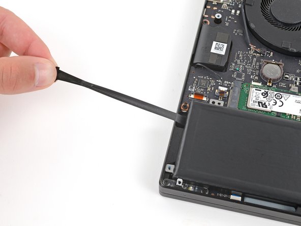

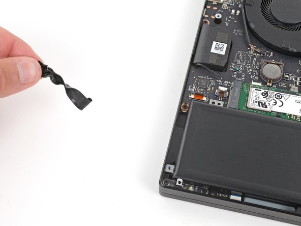

  10. Razer Blade 15 Advanced Model (Early 2020) Battery Replacement, Remove the stretch‑release adhesive: crwdns2935265:010crwdnd2935265:01crwdnd2935265:03crwdne2935265:0 Razer Blade 15 Advanced Model (Early 2020) Battery Replacement, Remove the stretch‑release adhesive: crwdns2935265:010crwdnd2935265:02crwdnd2935265:03crwdne2935265:0 Razer Blade 15 Advanced Model (Early 2020) Battery Replacement, Remove the stretch‑release adhesive: crwdns2935265:010crwdnd2935265:03crwdnd2935265:03crwdne2935265:0
    • Be very careful not to puncture or bend the battery with your tool—it can leak dangerous chemicals and/or catch fire.
    • An adhesive strip under the battery's top left corner secures it to the frame.
    • Use tweezers to carefully peel up the stretch‑release adhesive's pull tab near the top left corner of the battery, enough that you can grip it with your fingers.
    • Use your fingers to slowly pull the strip out slowly and at a low angle to the frame. Give the adhesive plenty of time to stretch and un‑stick.
    • If the strip breaks, don't worry! Skip to the next step for an alternate way to separate the adhesive.

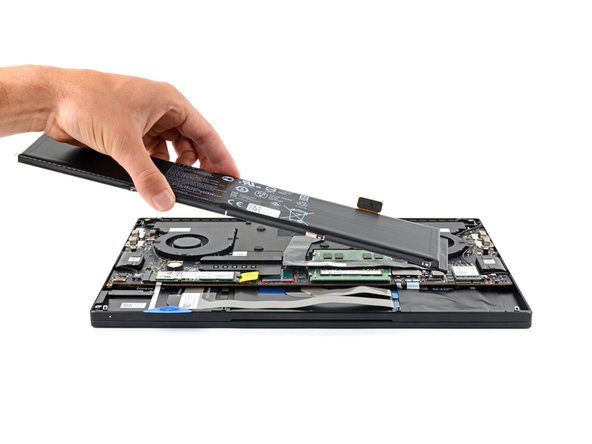

  12. Razer Blade 15 Advanced Model (Early 2020) Battery Replacement, Remove the battery: crwdns2935265:012crwdnd2935265:01crwdnd2935265:03crwdne2935265:0 Razer Blade 15 Advanced Model (Early 2020) Battery Replacement, Remove the battery: crwdns2935265:012crwdnd2935265:02crwdnd2935265:03crwdne2935265:0 Razer Blade 15 Advanced Model (Early 2020) Battery Replacement, Remove the battery: crwdns2935265:012crwdnd2935265:03crwdnd2935265:03crwdne2935265:0
    Tesa 61395 Tape
    $2.99
    • Grab the middle of the battery and lift the left edge.
    • Slide the battery's right edge out from its recess in the frame and remove the battery.
    • During reassembly, if your battery comes with a strip of adhesive pre‑installed under the top left corner, remove the plastic liner. If it doesn't, apply a strip of thin, double‑sided tape to the frame where the old strip of adhesive was.
For optimal performance, calibrate your newly installed battery after completing this guide.
