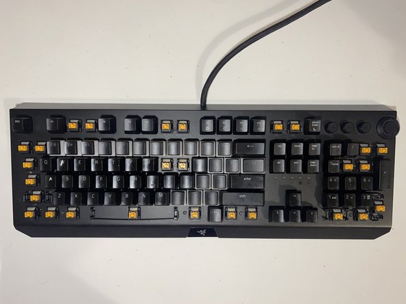

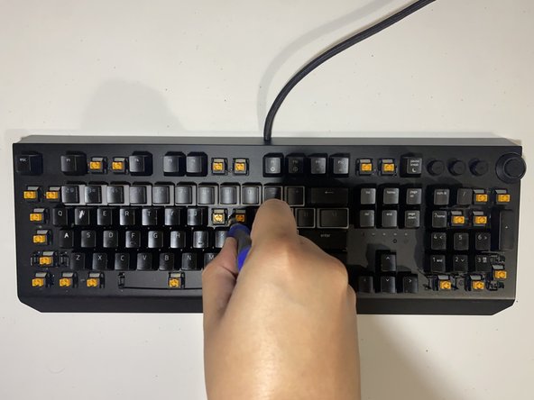

    • Turn the keyboard back so that the keys are facing up.
    • Using a keycap remover, remove the keys hiding the screws.
    • The keycaps removed are shown in the 3rd picture.
    • The bigger keys, such as the spacebar or shift, have stabilizers. To remove them, carefully loosen the stabilizer until the keycap unhooks.
  4. Razer BlackWidow Elite Volume Knob Replacement: crwdns2935265:04crwdnd2935265:01crwdnd2935265:02crwdne2935265:0 Razer BlackWidow Elite Volume Knob Replacement: crwdns2935265:04crwdnd2935265:02crwdnd2935265:02crwdne2935265:0
    • Using Phillips #0 screwdriver, remove the 14 (8 mm) screws exposed after removing the keycaps.

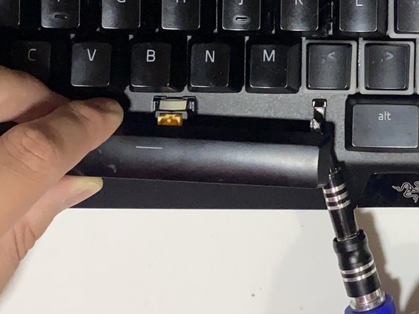

  5. Razer BlackWidow Elite Volume Knob Replacement: crwdns2935265:05crwdnd2935265:01crwdnd2935265:01crwdne2935265:0
    • After the screws are removed, carefully lift the keyboard to open it up.

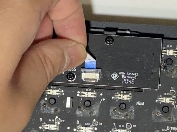

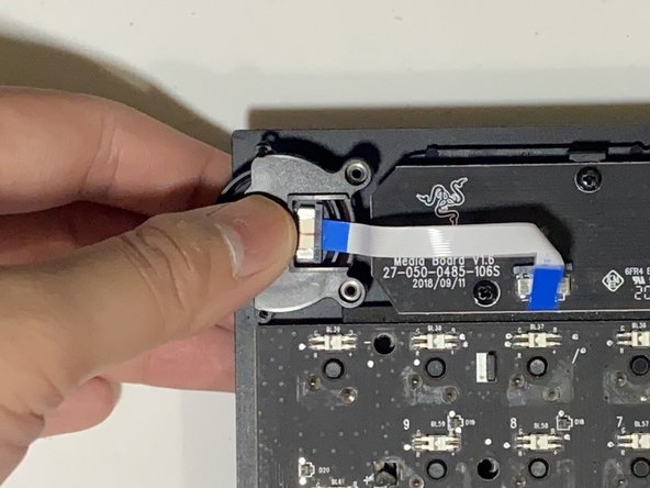

  6. Razer BlackWidow Elite Volume Knob Replacement: crwdns2935265:06crwdnd2935265:01crwdnd2935265:03crwdne2935265:0 Razer BlackWidow Elite Volume Knob Replacement: crwdns2935265:06crwdnd2935265:02crwdnd2935265:03crwdne2935265:0 Razer BlackWidow Elite Volume Knob Replacement: crwdns2935265:06crwdnd2935265:03crwdnd2935265:03crwdne2935265:0

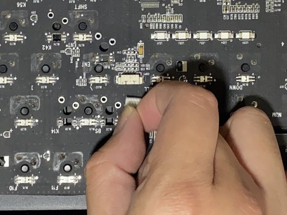

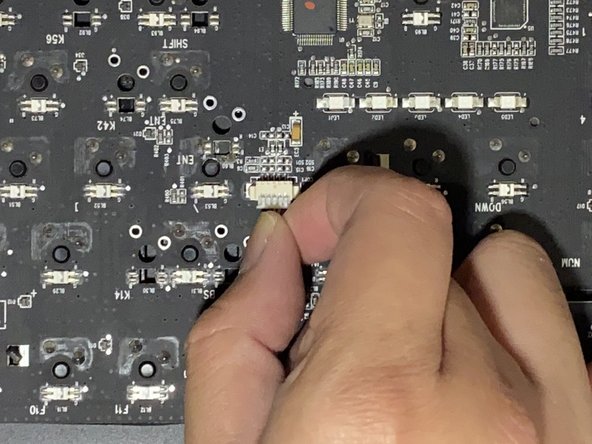

    • Detach the cable from the circuit board

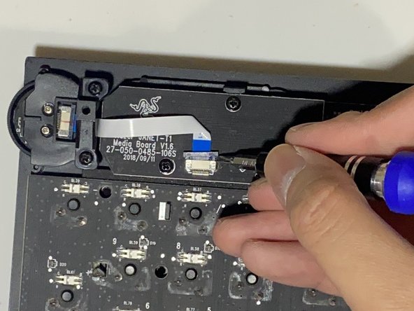

  7. Razer BlackWidow Elite Volume Knob Replacement: crwdns2935265:07crwdnd2935265:01crwdnd2935265:03crwdne2935265:0 Razer BlackWidow Elite Volume Knob Replacement: crwdns2935265:07crwdnd2935265:02crwdnd2935265:03crwdne2935265:0 Razer BlackWidow Elite Volume Knob Replacement: crwdns2935265:07crwdnd2935265:03crwdnd2935265:03crwdne2935265:0
    • Use a tool to remove the latch from the flex cable and carefully pull out the flex cable.

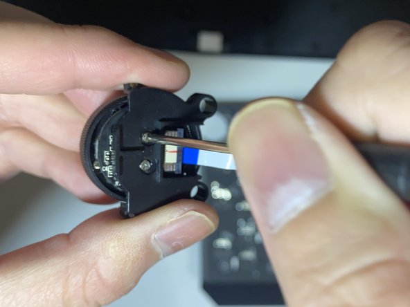

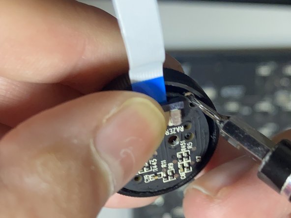

  10. Razer BlackWidow Elite Volume Knob Replacement: crwdns2935265:010crwdnd2935265:01crwdnd2935265:02crwdne2935265:0 Razer BlackWidow Elite Volume Knob Replacement: crwdns2935265:010crwdnd2935265:02crwdnd2935265:02crwdne2935265:0
    • After unscrewing the bracket, the button of the volume knob should come right off.
    • On the main component of the volume knob, the circuit board should be rotatable. Rotate the circuit board so that the cutout aligns with the hidden screw.
    • There should be 2 (3mm) screws. Use a Phillips #000 screwdriver to remove them.

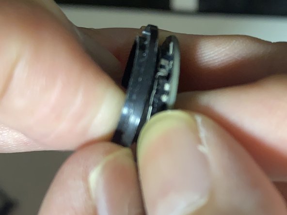

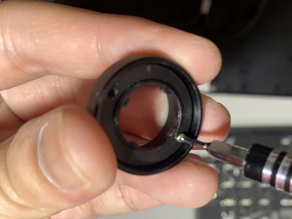

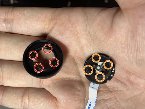

  12. Razer BlackWidow Elite Volume Knob Replacement: crwdns2935265:012crwdnd2935265:01crwdnd2935265:03crwdne2935265:0 Razer BlackWidow Elite Volume Knob Replacement: crwdns2935265:012crwdnd2935265:02crwdnd2935265:03crwdne2935265:0 Razer BlackWidow Elite Volume Knob Replacement: crwdns2935265:012crwdnd2935265:03crwdnd2935265:03crwdne2935265:0
    • After detaching the ring from the volume knob's circuit board, you can screw the ring component to the volume knob casing for easier re-assembly.
    • Align the screw holes between the two components. Using the 2 (3mm) screws from step 10, screw them together, as shown in the 2nd picture.
    • Simply align the snap-fit joints back together to reassemble the main volume knob component.
    • The snap-fit joints are highlighted in the 3rd picture.
