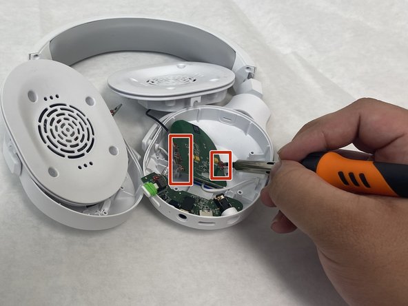

  7. Razer Barracuda X Motherboard Replacement: crwdns2935265:07crwdnd2935265:01crwdnd2935265:03crwdne2935265:0 Razer Barracuda X Motherboard Replacement: crwdns2935265:07crwdnd2935265:02crwdnd2935265:03crwdne2935265:0 Razer Barracuda X Motherboard Replacement: crwdns2935265:07crwdnd2935265:03crwdnd2935265:03crwdne2935265:0
    • Desolder all of the remaining motherboard connections.
    • Do not hold the iron by the barrel as depicted in the images.
    • Remove the motherboard.
