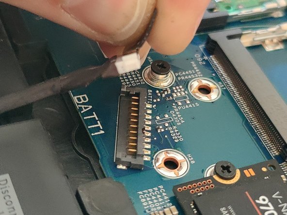

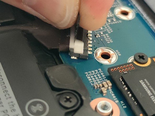

    • Locate the Battery connector, it is mandatory to remove all power from the computer before working on the Hardware.
    • Unplug the battery by pulling on the black tab on the white connector. It doesn't require a lot of force.

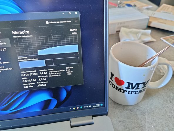

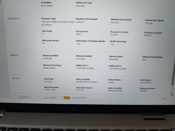

    • At the first restart (after 2 or 3 attempt), you will have and error message, saying that the amount memory have changed. You can either check it by the BIOS by clicking on "Go to BIOS" or clicking "Continue" to go to your operating System.
    • THe ultime validation is to check the amount of memory in your Operating system. If the correct amount is displayed, you're done!

Is disconnecting the battery really necessary? There's also the service mode which cuts power until an AC adapter is plugged in.
