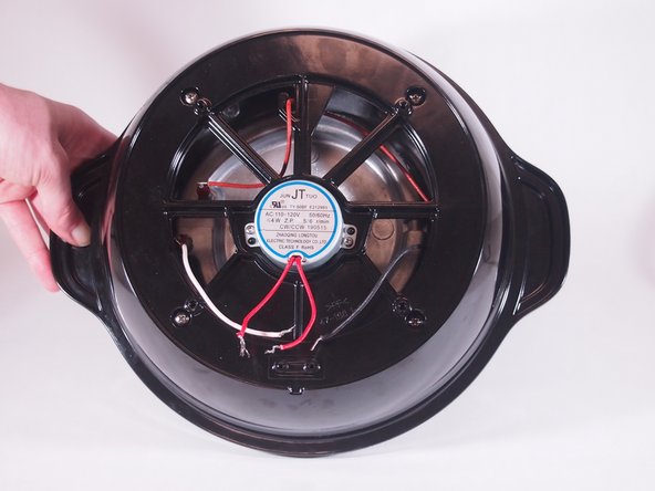

  2. Presto Stirring Popper 0520002 Motor Replacement: crwdns2935265:02crwdnd2935265:01crwdnd2935265:02crwdne2935265:0 Presto Stirring Popper 0520002 Motor Replacement: crwdns2935265:02crwdnd2935265:02crwdnd2935265:02crwdne2935265:0
    • Removing the bottom cover exposes the internals of the popper. The base holds together the centrally mounted motor and the wires for the power cord and heating element.

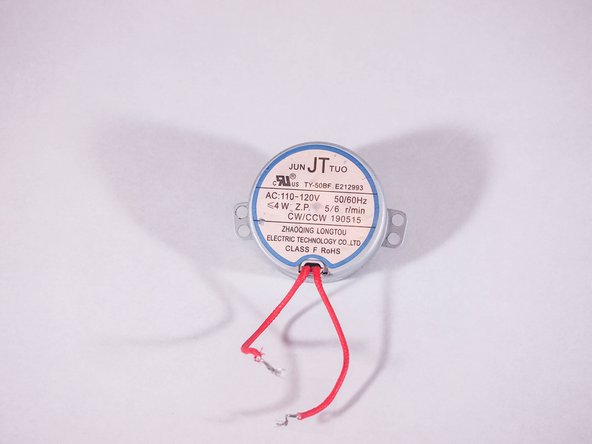

  3. Presto Stirring Popper 0520002 Motor Replacement, Motor: crwdns2935265:03crwdnd2935265:01crwdnd2935265:03crwdne2935265:0 Presto Stirring Popper 0520002 Motor Replacement, Motor: crwdns2935265:03crwdnd2935265:02crwdnd2935265:03crwdne2935265:0 Presto Stirring Popper 0520002 Motor Replacement, Motor: crwdns2935265:03crwdnd2935265:03crwdnd2935265:03crwdne2935265:0
    • Remove the two black wire twist caps, and unwind the different wires.
    • During reassembly, make sure the wires are strongly twisted together (twist clockwise) and the wire caps are firmly attached.
    • Avoid swapping the polarity during reassembly. The neutral (ridged) wire connects to the left motor wire and the white wire to the heater.

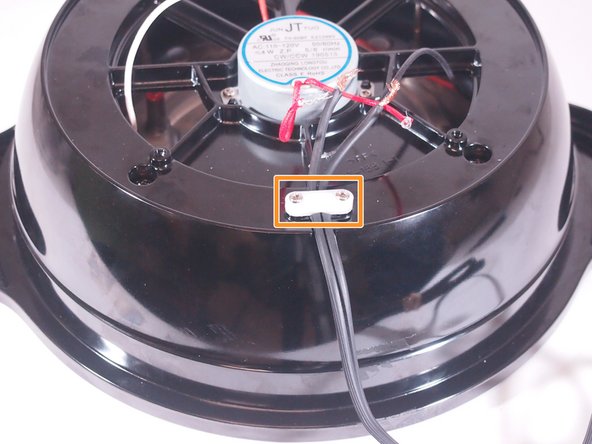

    • Remove two more 14 mm Phillips #2 screws attaching the white plastic holding the wall cord to the base.

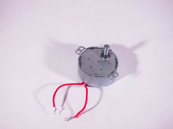

  4. Presto Stirring Popper 0520002 Motor Replacement: crwdns2935265:04crwdnd2935265:01crwdnd2935265:03crwdne2935265:0 Presto Stirring Popper 0520002 Motor Replacement: crwdns2935265:04crwdnd2935265:02crwdnd2935265:03crwdne2935265:0 Presto Stirring Popper 0520002 Motor Replacement: crwdns2935265:04crwdnd2935265:03crwdnd2935265:03crwdne2935265:0
    • Remove the two 14 mm Phillips #2 screws from the motor.
    • Remove the motor from the popper.
    • A spring located in the shaft may force the motor out when the screws are sufficiently loosened.
