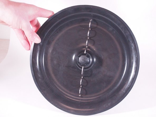

  6. Presto Stirring Popper 0520002 Heating Pan Replacement: crwdns2935265:06crwdnd2935265:01crwdnd2935265:01crwdne2935265:0
    • Remove the base from the rest of the device.
  7. Presto Stirring Popper 0520002 Heating Pan Replacement, Heating Pan: crwdns2935265:07crwdnd2935265:01crwdnd2935265:02crwdne2935265:0 Presto Stirring Popper 0520002 Heating Pan Replacement, Heating Pan: crwdns2935265:07crwdnd2935265:02crwdnd2935265:02crwdne2935265:0
    • This is the nonstick heating pan with the stirrer still attached.
    • The pan surface can be greasy from use.
