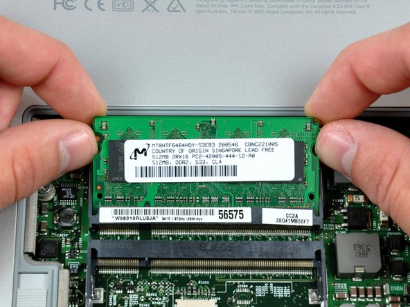

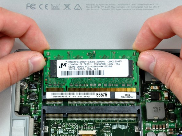

  4. PowerBook G4 Aluminum 17" 1.67 GHz (High-Res) RAM Replacement, RAM: crwdns2935265:04crwdnd2935265:01crwdnd2935265:03crwdne2935265:0 PowerBook G4 Aluminum 17" 1.67 GHz (High-Res) RAM Replacement, RAM: crwdns2935265:04crwdnd2935265:02crwdnd2935265:03crwdne2935265:0 PowerBook G4 Aluminum 17" 1.67 GHz (High-Res) RAM Replacement, RAM: crwdns2935265:04crwdnd2935265:03crwdnd2935265:03crwdne2935265:0
    • Use your fingertips to pull the two RAM arms away from the sides of the RAM chip. The chip should pop up slightly.
    • Pull the RAM chip away from its socket and remove it from the logic board.
    • Repeat this process for the other RAM chip, if present.
